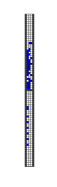

% main.m
% This is a main script to simulate the approach, service, and departure of
% vehicles passing through a toll plaza, , as governed by the parameters
% defined below
%   iterations      =  the maximal iterations of simulation
%   B               =  number booths
%   L               =  number lanes in highway before and after plaza
%   Arrival         =  the mean total number of cars that arrives
%   plazalength     =  length of the plaza
%   Service         =  Service rate of booth
%   plaza           =  plaza matrix
%                      1 = car, 0 = empty, -1 = forbid, -3 = empty&booth
%   v               =  velocity matrix
%   vmax            =  max speed of car
%   time            =  time matrix, to trace the time that the car cost to
%                      pass the plaza.
%   dt              =  time step
%   t_h             =  time factor
%   departurescount =  number of cars that departure the plaza in the step
%   departurestime  =  time cost of the departure cars
%   influx          =  influx vector
%   outflux         =  outflux vector
%   timecost        =  time cost of all car
%   h               =  handle of the graphics
% zhou lvwen: zhou.lv.wen@gmail.com
clear;clc
iterations = 1200; % the maximal iterations of simulation
B = 3; % number booths
L = 3; % number lanes in highway before and after plaza
Arrival=3; % the mean total number of cars that arrives
plazalength = 81; % length of the plaza
[plaza, v, time,buspla] = create_plaza(B, L, plazalength);
h = show_plaza(plaza,buspla, NaN, 0.01);
timeblock=5;
dt = 0.2; % time step
t_h = 1; % time factor
vmax = 2; % max speed
vinit=1;%initial speed
busstop=6*ones(plazalength,B+2);
carstop=3*ones(plazalength,B+2);
timecost = [];
sf=0;%switchflag
for i = 1:iterations
    if i==14
        ss=0;
    end
    if i==370
