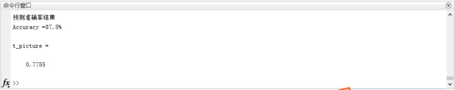

disp('预测准确率结果');
str = sprintf( 'Accuracy =%g%% ',aac*100);
disp(str);

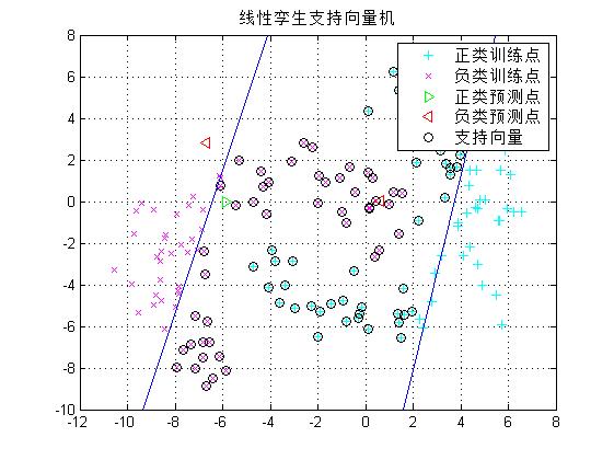

%% 第四步:绘图
tic;
% -------------绘制训练点----------------%
plot(data_train_p(:,1),data_train_p(:,2),'c+',data_train_n(:,1),data_train_n(:,2),'mx');
title('线性孪生支持向量机')
hold on
grid on
% ------------绘制预测点-----------------%
plot(data_predict_p(1,:),data_predict_p(2,:),'g>',data_predict_n(1,:),data_predict_n(2,:),'r<');
% -----------绘制支持向量----------------%
plot(data_train_n(IB,1),data_train_n(IB,2),'ko',data_train_p(JA,1),data_train_p(JA,2),'ko');   %??????
% ---------绘制分类面的图像--------------%
plotpc(v1(1:2,:)',v1(3))
plotpc(v2(1:2,:)',v2(3))
legend('正类训练点','负类训练点','正类预测点','负类预测点','支持向量');
t_picture=toc
hold off
