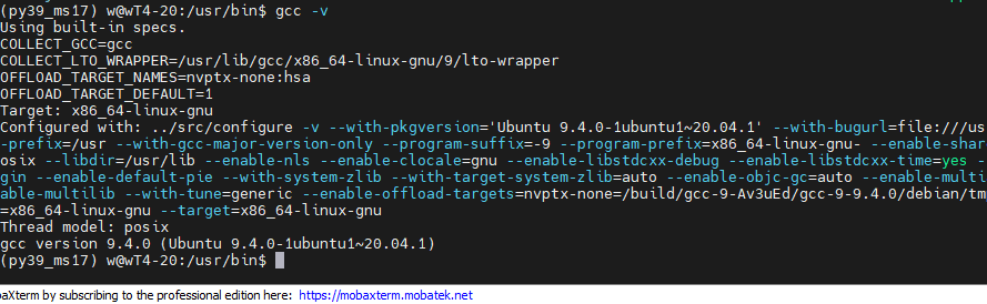

gcc -v
# 怎么是9

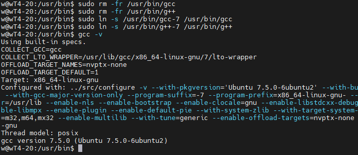

# 切换GCC到7
rm -fr /usr/bin/gcc
rm -fr /usr/bin/g++
sudo ln -s /usr/bin/gcc-7 /usr/bin/gcc
sudo ln -s /usr/bin/g++-7 /usr/bin/g++

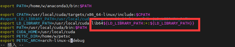

# 发现有个配置出现问题,改正如下
export LD_LIBRARY_PATH=/usr/local/cuda/lib64:$LD_LIBRARY_PATH
export PATH=/usr/local/cuda-10.1/bin:$PATH
export LD_LIBRARY_PATH=/usr/local/cuda-10.1/lib64:$LD_LIBRARY_PATH

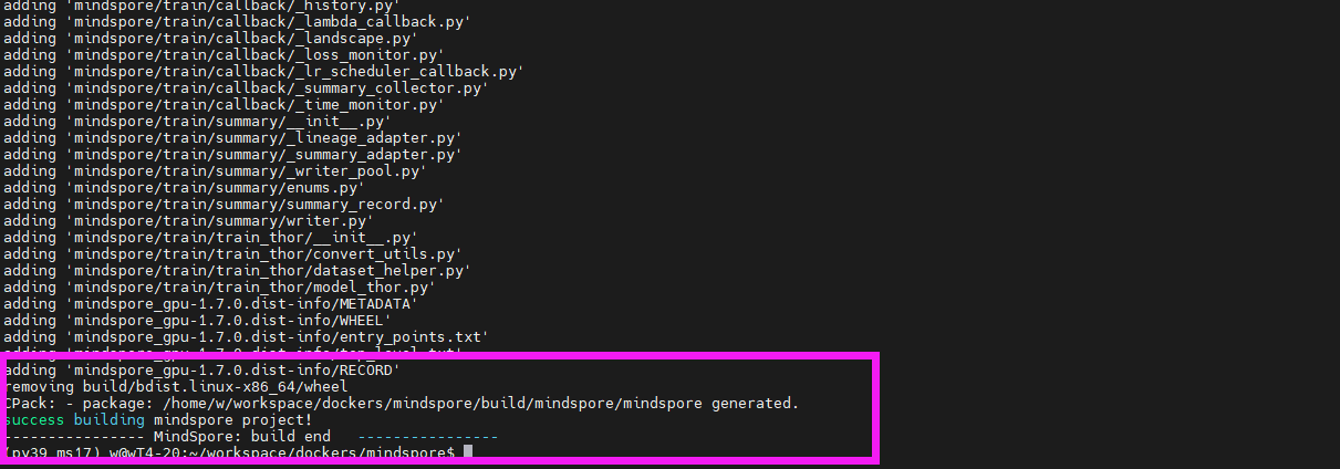

重新编译
source activate py39_ms17
rm -fr build

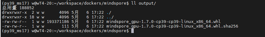

bash build.sh -e gpu -S on

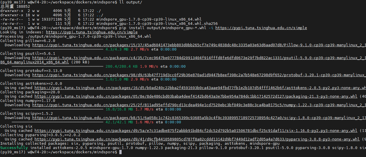

Pip安装本地生成的MindSpore
pip install output/mindspore_gpu-*.whl -i https://pypi.tuna.tsinghua.edu.cn/simple
