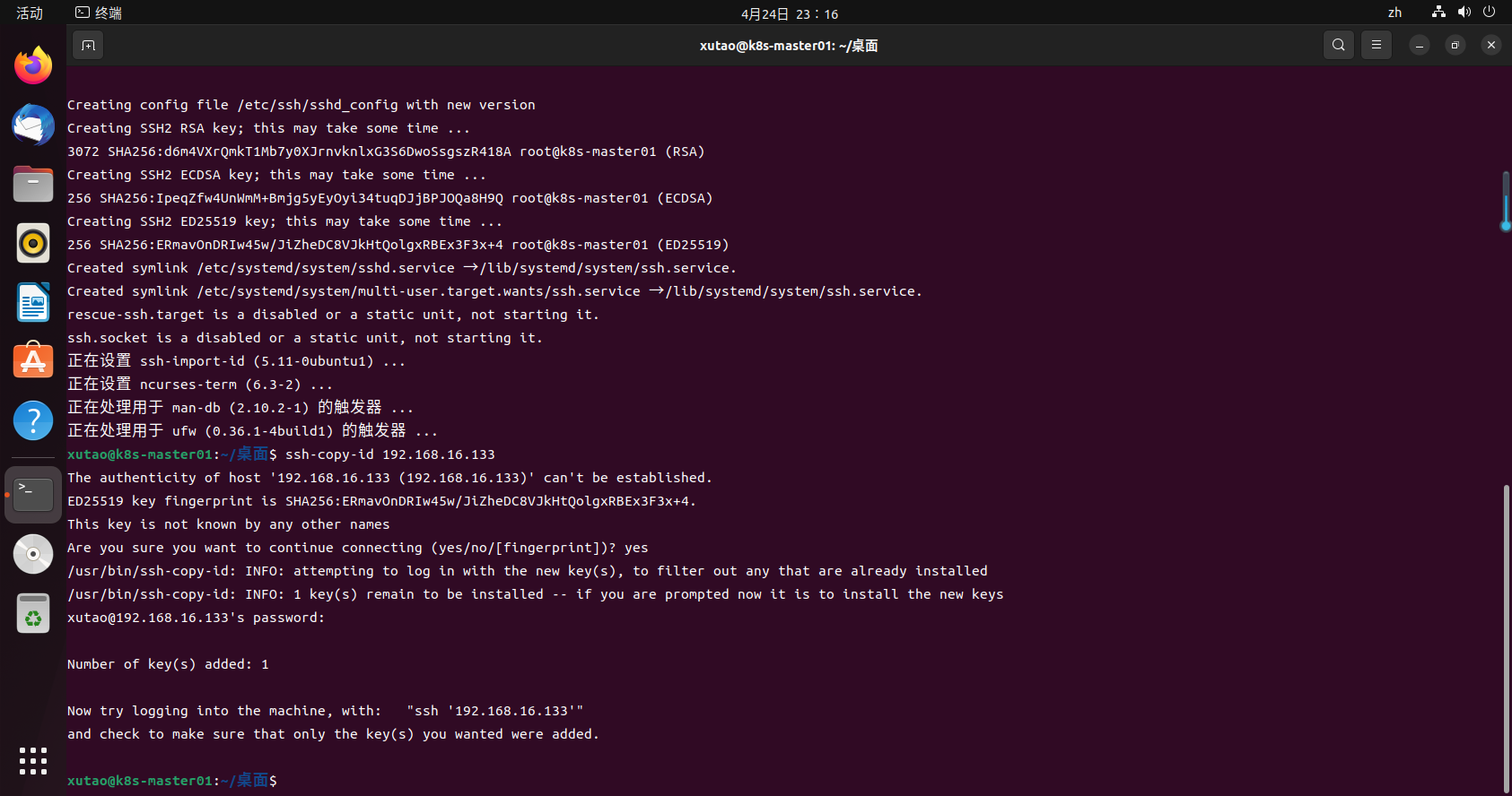

3.2.2 SSH密钥免密
sudo apt-get install openssh-server
ssh-keygen -t rsa
此时会在/home/ubuntu/.ssh目录下生成密钥对
ll .ssh
上传公钥到对应服务器
ssh-copy-id 192.168.16.133
ssh-copy-id 192.168.16.134
