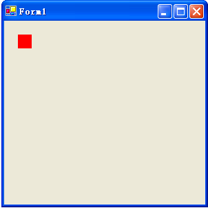

2. 编写一个利用键盘控制窗体上红色方块移动的程序,当用户按下键盘上的“上”、“下”、“左”、“右”键时,方块会向该方向移动。程序的运行界面如图所示。(10分)
int x=20,y=20; //x控制方块的当前横坐标,y控制方块的当前纵坐标
bool isDrawed=false; //标识窗体上当前是否已经绘制了最初的方块
private void Form1_KeyDown(object sender, System.Windows.Forms.KeyEventArgs e)
private void Form1_Paint(object sender, System.Windows.Forms.PaintEventArgs e)

2. (10分)
int x=20,y=20;
             Graphics g=this.CreateGraphics();
            g.FillRectangle(new SolidBrush(this.BackColor),x,y,20,20);
            switch(e.KeyData)
                case Keys.Left:
                    x-=5;
                 break;
                case Keys.Right :
                    x+=5;
                    break;
                case Keys.Up:
                    y-=5;
                    break;
                case Keys.Down:
                    y+=5;
                    break;
            g.FillRectangle(new SolidBrush(Color.Red),x,y,20,20);
            if(!isDrawed)
                this.CreateGraphics().FillRectangle(new SolidBrush(Color.Red),x,y,20,20);
             isDrawed=true;
