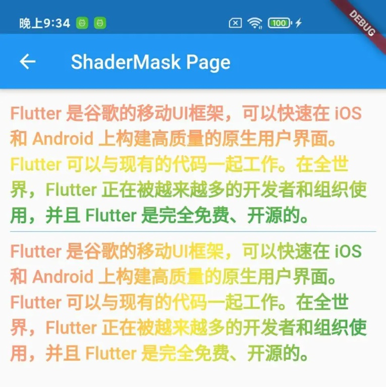

1. LinearGradient 线性渐变
const LinearGradient({
    this.begin = Alignment.centerLeft,
    this.end = Alignment.centerRight,
    @required List<Color> colors,
    List<double> stops,
    this.tileMode = TileMode.clamp,
    GradientTransform transform,
    LinearGradient 用于 2D 线性渐变,其中 begin 和 end 用于开始时与结束时的两个锚点;colors 为渐变过程中设置的颜色列表;stops 为颜色列表中渐变色的转换比例;其中注意,colors 和 stops 列表长度要一致;
return ShaderMask(
    shaderCallback: (rect) => LinearGradient(
          begin: Alignment.topCenter,
          end: Alignment.bottomCenter,
          colors: [ Colors.deepOrange.withOpacity(0.6), Colors.yellow, Colors.green ],
          stops: [0.2, 0.5, 0.9],
        ).createShader(rect),
    child: _itemText(_paraStr));

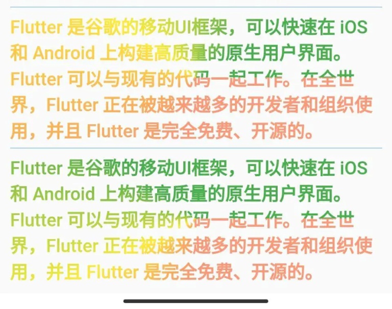

    RadialGradient 用于 2D, 径向渐变,以 center 为圆环中心,radius 为半径宽度逐层渐变;
return ShaderMask(
    shaderCallback: (Rect bounds) {
      return RadialGradient(
              center: Alignment.center, radius: 0.5,
              stops: [0.1, 0.5, 0.9],
              tileMode: TileMode.mirror)
          .createShader(bounds);

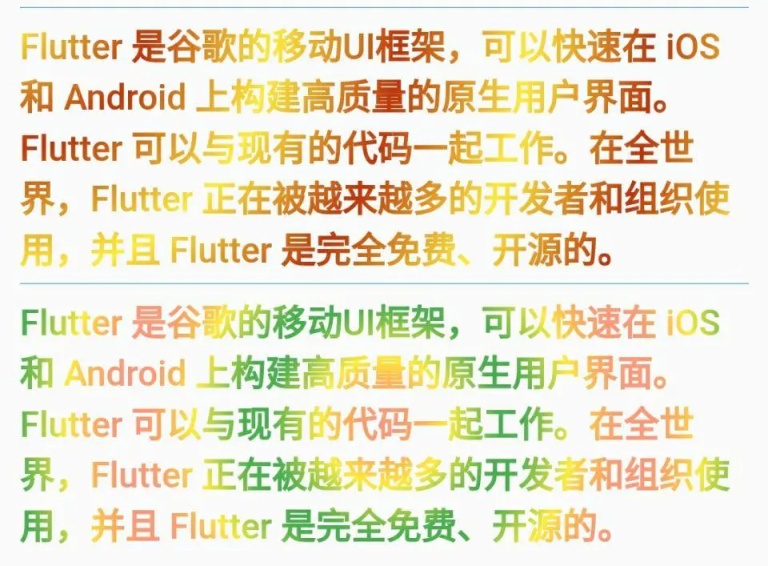

3. SweepGradient 镭射渐变
const SweepGradient({
    this.center = Alignment.center,
    this.startAngle = 0.0,
    this.endAngle = math.pi * 2,
    List<double> stops,
    SweepGradient 为 2D 镭射扫描渐变,其中 center 为镭射扫描中心;startAngle 和 endAngle 分别为扫描的开始和结束的弧度;其余属性均相同;
return ShaderMask(
      return SweepGradient(
        stops: [0.3, 0.6, 0.9],
      ).createShader(bounds);
return ShaderMask(
        startAngle: pi * 0.5,
        endAngle: 2 * pi * 0.6,

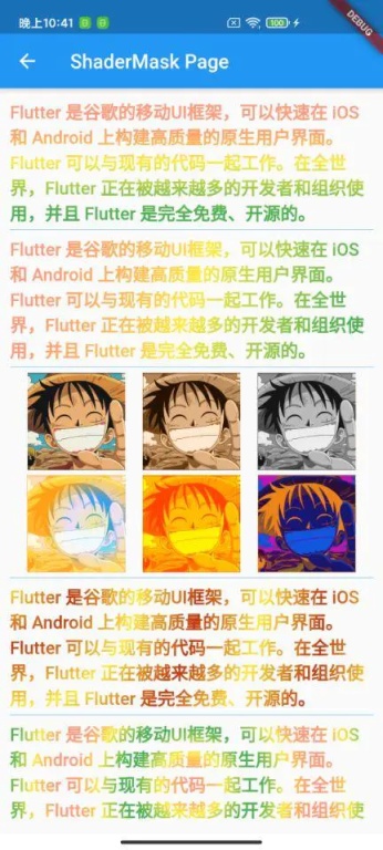

BlendMode
    BlendMode 为绘制的混合模式,可以用来创建其他效果;例如黑白模式,X 透视模式等;
return ShaderMask(
      return LinearGradient(colors: [Color(0xFF704214), Colors.brown]).createShader(bounds);
    blendMode: BlendMode.color,
    child: Container(width: 100, height: 100, child: Image.asset('images/icon_hzw01.jpg')));
return ShaderMask(
      return LinearGradient(colors: [Colors.black, Colors.white]).createShader(bounds);
    blendMode: BlendMode.hue,
    ShaderMask 案例源码
