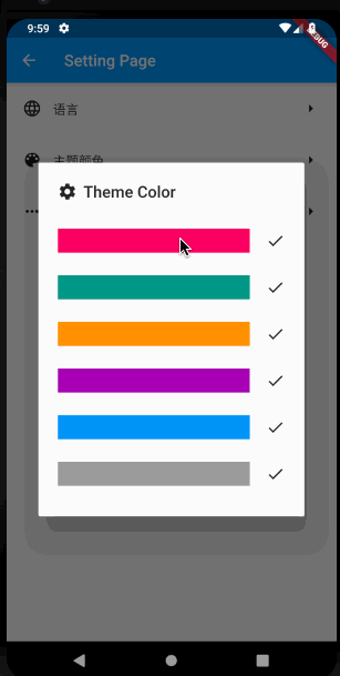

2. EventBus 定义事件
      小菜创建两个自定义事件,分别为语言切换和主题色切换;使用方法和 Android 一致;

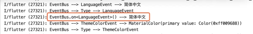

4. EventBus 接收事件
      对于 EventBus 的接收可以通过 on(event).listen() 来监听;其中若 on() 可以监听所有事件也可以监听固定的事件,区别是是否限制当前广播;
// 监听所有广播
eventBus.on().listen((event) {
  if (event is LanguageEvent) {
    print('EventBus --> LanguageEvent --> ${event.languageType}');
  } else if (event is ThemeColorEvent) {
    themeColor = event.color;
    print('EventBus --> ThemeColorEvent --> ${event.color}');
  print('EventBus --> Type --> ${event.runtimeType}');
// 监听固定类型广播
eventBus.on<LanguageEvent>().listen((event) {
  print('EventBus.on<LanguageEvent>() --> ${event.languageType}');

_itemClick(dataIndex, index) {
  return Consumer<ThemeColorNotifier>(builder: (context, themeColor, _) {
    return GestureDetector(
        child: Padding(
            padding: EdgeInsets.symmetric(vertical: 14),
            child: Row(children: <Widget>[
              _itemColorWid(_colorList[index]),
              Expanded(child: dataIndex == 1 ? _itemColorWid(_colorList[index]) : Text(_languageList[index])),
              SizedBox(width: 20),
              Icon(Icons.done)
        onTap: () {
          themeColor.setThemeColor(_colorList[index]);
          Navigator.pop(context);
3. Provider 接收通知

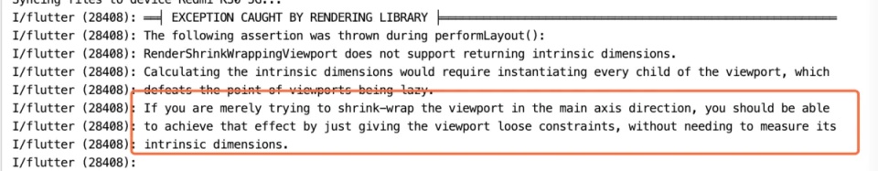

      小菜在测试过程中设置 ListView 对话框时出现如下错误:
I/flutter (28408): The following assertion was thrown during performLayout():
I/flutter (28408): RenderShrinkWrappingViewport does not support returning intrinsic dimensions.
I/flutter (28408): Calculating the intrinsic dimensions would require instantiating every child of the viewport, which
I/flutter (28408): defeats the point of viewports being lazy.
I/flutter (28408): If you are merely trying to shrink-wrap the viewport in the main axis direction, you should be able
I/flutter (28408): to achieve that effect by just giving the viewport loose constraints, without needing to measure its
I/flutter (28408): intrinsic dimensions.

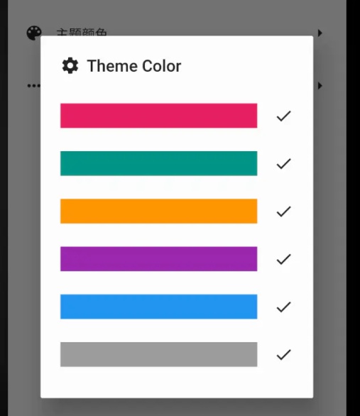

      小菜测试可以设置 ListView 中 Container 宽或高即可,也可以将 ListView 包裹在容器中并为其设置宽度为 double.maxFinite;
_itemDialog(context, dataIndex) {
  return showDialog(
      context: context,
      builder: (context) {
        return AlertDialog(
            title: Row(children: <Widget>[
              Icon(Icons.settings), SizedBox(width: 8),
              Text(dataIndex == 1 ? 'Theme Color' : 'Language')
            content: Container(
                width: double.maxFinite,
                child: ListView.builder(
                    itemCount: dataIndex == 1 ? _colorList.length : _languageList.length,
                    physics: ScrollPhysics(),
                    primary: false, shrinkWrap: true,
                    itemBuilder: (BuildContext context, int index) {
                      return _itemClick(dataIndex, index);
