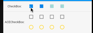

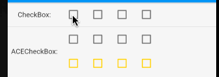

ACECheckBox
扩展一:变更未选中颜色
源码分析
// CheckBox
inactiveColor: widget.onChanged != null ? themeData.unselectedWidgetColor : themeData.disabledColor,
// ACECheckBox
    ? widget.unCheckColor ?? themeData.unselectedWidgetColor
      分析 CheckBox 源码,其中复选框未选中颜色通过 ThemeData.unselectedWidgetColor 设置,修改颜色成本较大,小菜添加了 unCheckColor 属性,可自由设置未选中状态颜色,未设置时默认为 ThemeData.unselectedWidgetColor;
案例尝试
return ACECheckbox(value: aceState, unCheckColor: Colors.amberAccent, onChanged: (value) => setState(() => aceState = value));
return ACECheckbox(value: aceState, checkColor: Colors.red.withOpacity(0.7),
return ACECheckbox(value: aceState, activeColor: Colors.indigoAccent.withOpacity(0.3), checkColor: Colors.red.withOpacity(0.7),

扩展二:添加圆形样式
源码分析
// 绘制边框
_drawBorder(canvas, outer, t, offset, type, paint) {
  assert(t >= 0.0 && t <= 0.5);
  final double size = outer.width;
  if ((type ?? ACECheckBoxType.normal) == ACECheckBoxType.normal) {
    canvas.drawDRRect(
        outer, outer.deflate(math.min(size / 2.0, _kStrokeWidth + size * t)),
        paint..strokeWidth = _kStrokeWidth / 2.0..style = PaintingStyle.fill);
  } else {
    canvas.drawCircle(
        Offset(offset.dx + size / 2.0, offset.dy + size / 2.0), size / 2.0,
        paint..strokeWidth = _kStrokeWidth..style = PaintingStyle.stroke);
// 绘制填充
_drawInner(canvas, outer, offset, type, paint) {
    canvas.drawRRect(outer, paint);
  } else {
    canvas.drawCircle(
        Offset(offset.dx + outer.width / 2.0, offset.dy + outer.width / 2.0),
        outer.width / 2.0, paint);
      分析源码可知,CheckBox 边框和内部填充以及对号全是通过 Canvas 进行绘制,其中绘制边框时,采用双层圆角矩形方式 drawDRRect,默认两层圆角矩形之间是填充方式;小菜添加 ACECheckBoxType 属性,允许用户设置圆角样式;
      绘制边框时画笔属性要与 drawDRRect 进行区分;其中复选框边框和内部填充两部分需要进行样式判断;

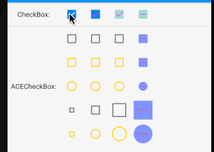

案例尝试
return ACECheckbox(value: aceState, unCheckColor: Colors.amberAccent, type: ACECheckBoxType.circle, onChanged: (value) => setState(() => aceState = value));
return ACECheckbox(
return ACECheckbox(tristate: true, value: _triAceState == null ? _triAceState : aceState,
      activeColor: Colors.indigoAccent.withOpacity(0.7), checkColor: Colors.red.withOpacity(0.4),
      onChanged: (value) {
        setState(() {
          if (value == null) {
            _triAceState = value;
          } else {
            _triAceState = ''; aceState = value;

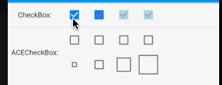

扩展三:自定义尺寸
源码分析
@override
void paint(PaintingContext context, Offset offset) {
  final Canvas canvas = context.canvas;
  paintRadialReaction(canvas, offset, size.center(Offset.zero));
  final Paint strokePaint = _createStrokePaint(checkColor);
  final Offset origin = offset + (size / 2.0 - Size.square(width) / 2.0);
  final AnimationStatus status = position.status;
  final double tNormalized = status == AnimationStatus.forward || status == AnimationStatus.completed ? position.value : 1.0 - position.value;
  if (_oldValue == false || value == false) {
    final double t = value == false ? 1.0 - tNormalized : tNormalized;
    final RRect outer = _outerRectAt(origin, t);
    final Paint paint = Paint()..color = _colorAt(t);
    if (t <= 0.5) {
      _drawBorder(canvas, outer, t, origin, type, paint);
    } else {
      _drawInner(canvas, outer, origin, type, paint);
      final double tShrink = (t - 0.5) * 2.0;
      if (_oldValue == null || value == null)
        _drawDash(canvas, origin, tShrink, width, strokePaint);
      else
        _drawCheck(canvas, origin, tShrink, width, strokePaint);
  } else {
    final RRect outer = _outerRectAt(origin, 1.0);
    final Paint paint = Paint()..color = _colorAt(1.0);
    if (tNormalized <= 0.5) {
      final double tShrink = 1.0 - tNormalized * 2.0;
      if (_oldValue == true)
      else
    } else {
      final double tExpand = (tNormalized - 0.5) * 2.0;
      if (value == true)
        _drawCheck(canvas, origin, tExpand, width, strokePaint);
      else
        _drawDash(canvas, origin, tExpand, width, strokePaint);
      分析源码 CheckBox 尺寸是固定的 Checkbox.width = 18.0,无法调整尺寸,小菜添加一个 width 参数,默认为 18.0 允许用户按需调整尺寸;如上是绘制复选框的三态情况;
案例尝试
return ACECheckbox(value: aceState, width: 10.0, onChanged: (value) => setState(() => aceState = value));
return ACECheckbox(value: aceState, checkColor: Colors.red.withOpacity(0.7), width: 18.0,
      width: 28.0, onChanged: (value) => setState(() => aceState = value));
      type: ACECheckBoxType.normal, width: 38.0, onChanged: (value) {
        setState(() {
          } else {
      ACECheckBox 源码
