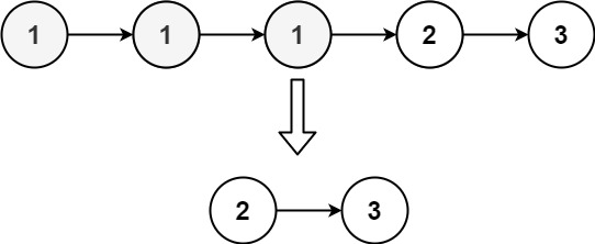

  • 示例 2:
输入:head = [1,1,1,2,3]
输出:[2,3]
