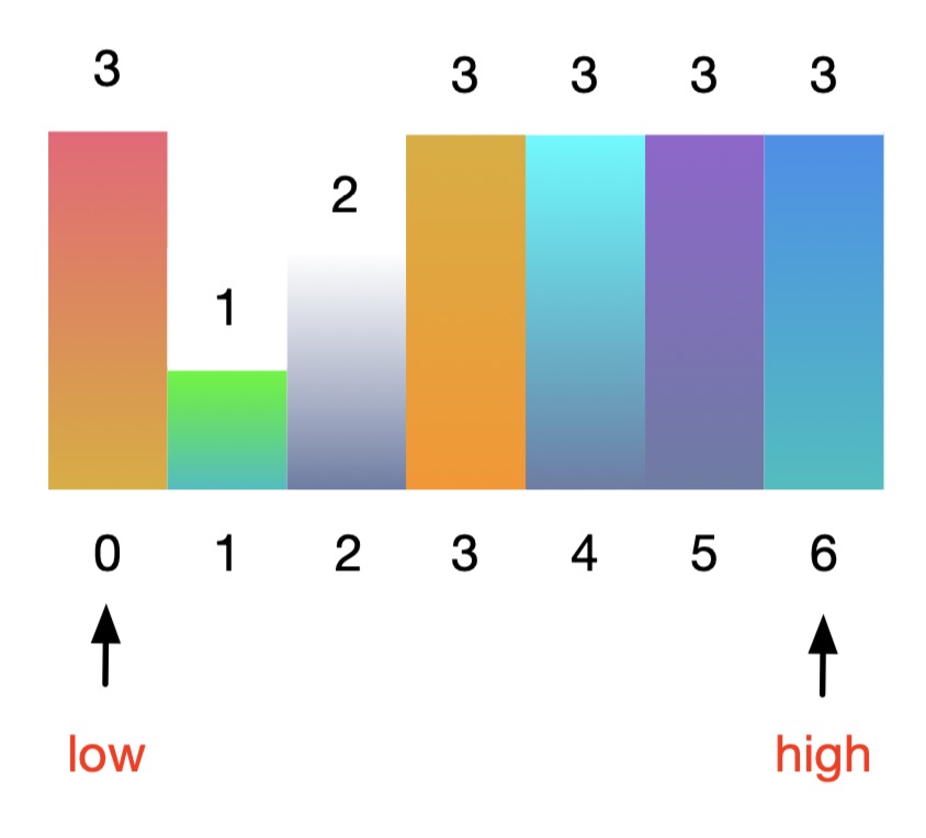

  • 以 nums = [3,1,2,3,3,3,3], target = 2 为例:

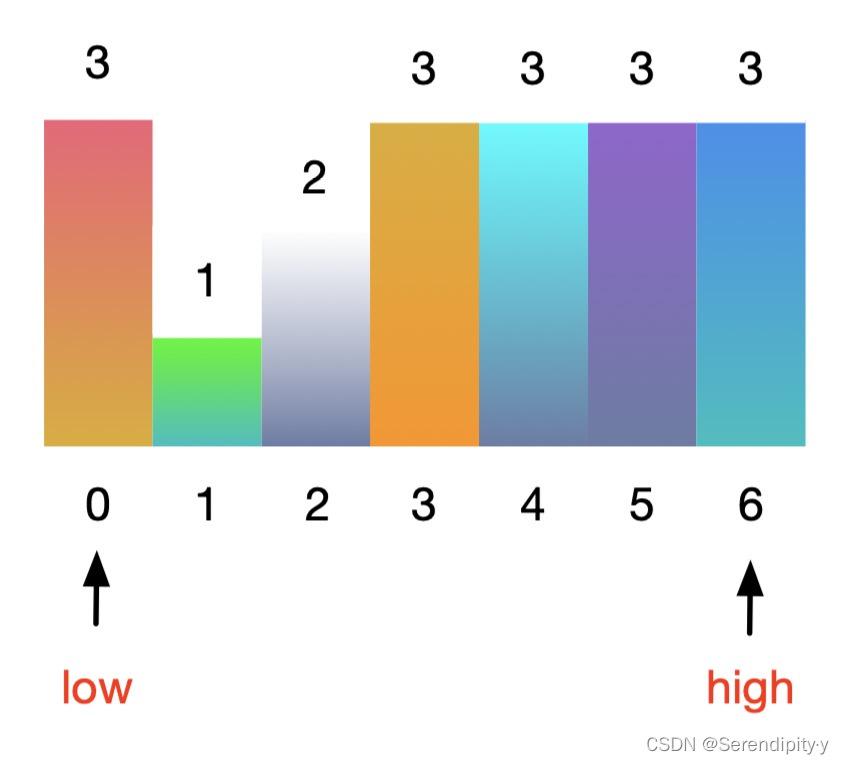

    • 首先初始化 low 和 high 指针:
low, high = 0, len(nums) - 1
  • 1

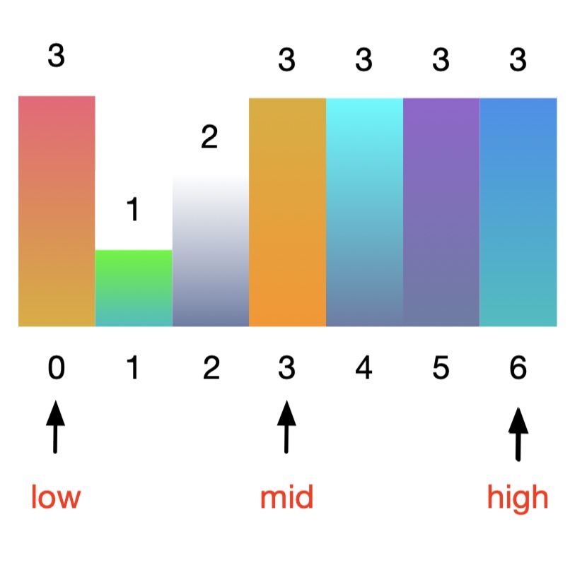

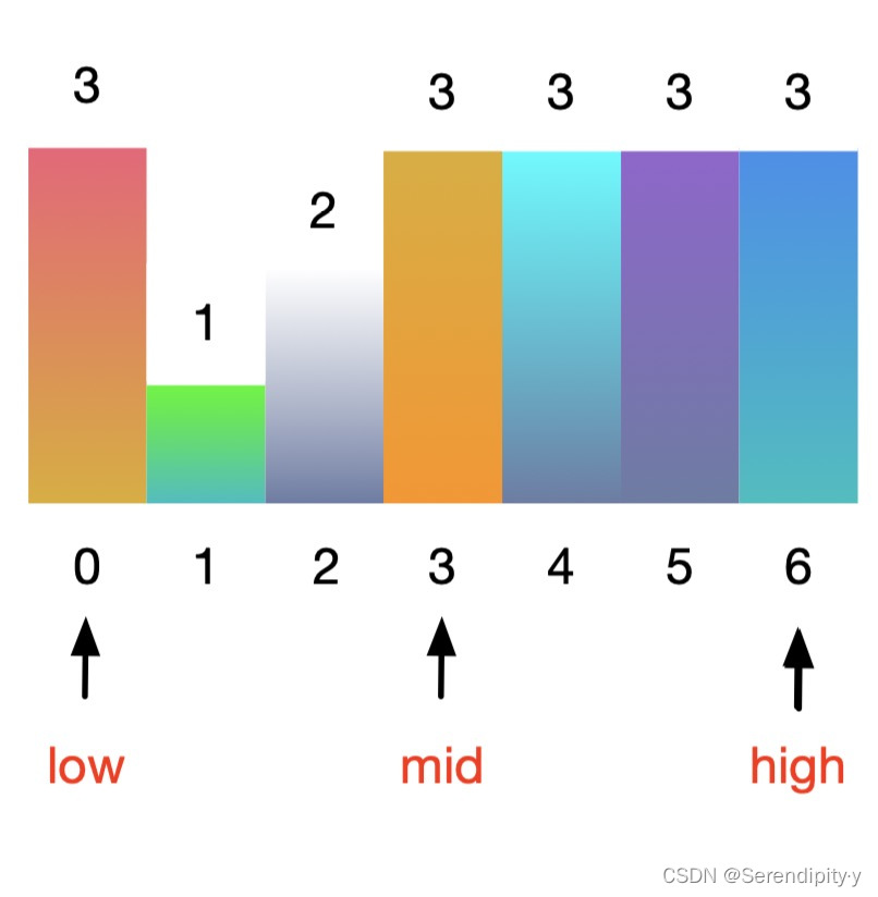

    • 然后,low = 0,high = 6,mid = low + (high - low) // 2 = 3:
  • 1
    • 此时 nums[low] == nums[mid] == nums[high],low 向右移动,high 向左移动:
# 相当于去重
if nums[low] == nums[mid] == nums[high]:
    low += 1
    high -= 1

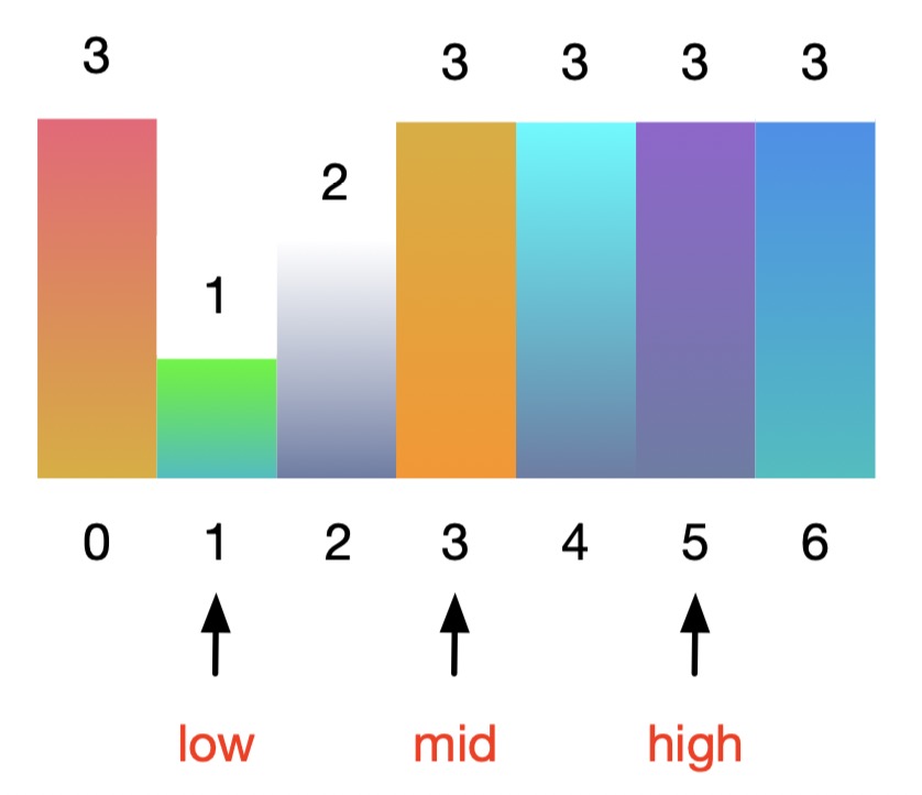

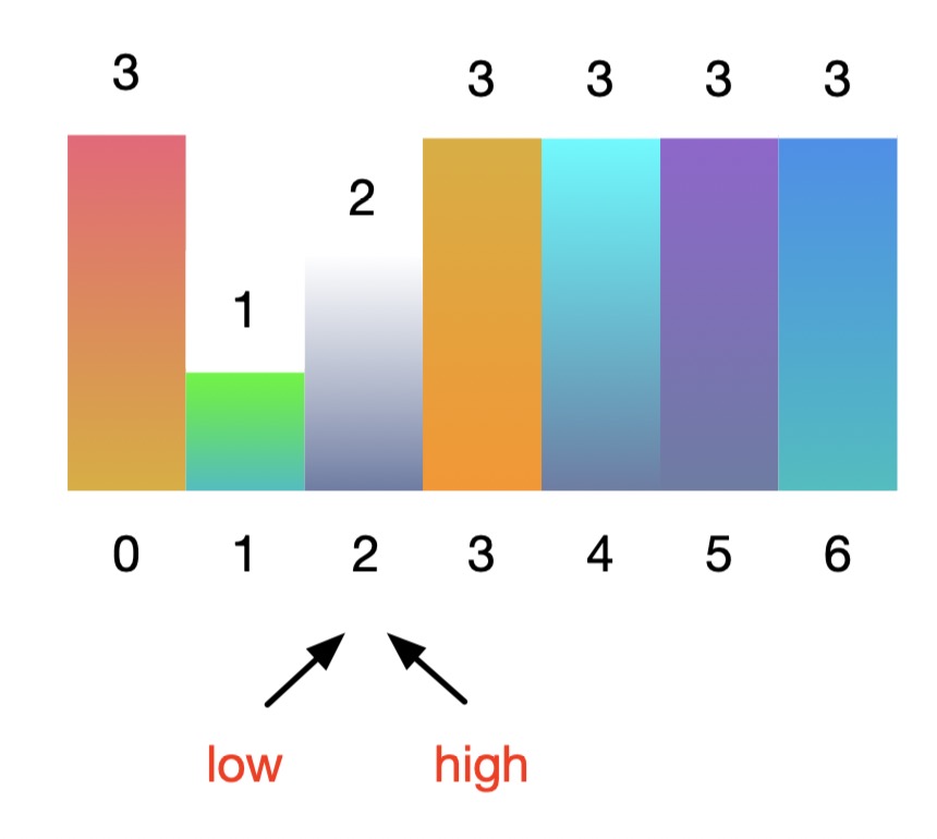

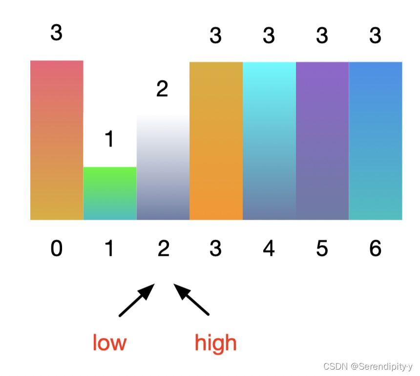

    • 继续,low = 1,high = 5,mid = low + (high - low) // 2 = 3:
    • 此时 nums[low] < nums[mid],且 target 在左区间内,所以 high 向左移动至 mid - 1 = 2:
# 如果左区间有序
elif nums[low] <= nums[mid]:
    # target 在左区间
    if nums[low] <= target < nums[mid]:
        high = mid - 1
  • 1
  • 2
  • 3
  • 4
  • 5

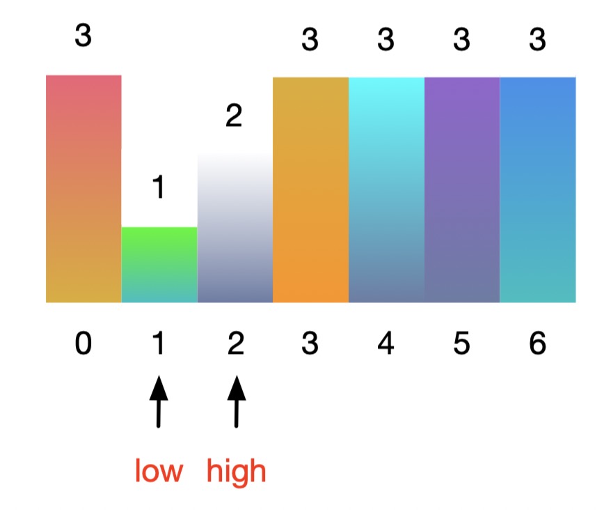

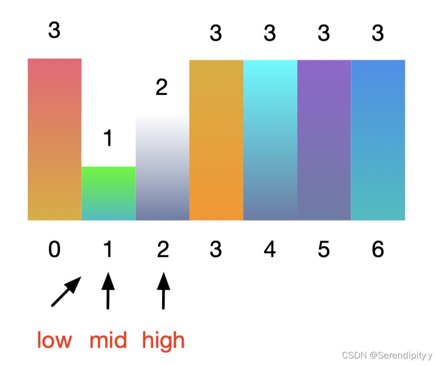

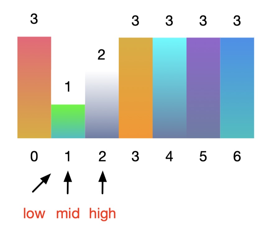

    • 继续,low = 1,high = 2,mid = low + (high - low) // 2 = 1:
    • 此时 nums[low] <= nums[mid],且 target 在右区间内,所以 low 向右移动至 mid + 1 = 2:
    • 最后,low = 2,high = 2,mid = low + (high - low) // 2 = 2,此时 nums[mid] == target,直接返回 True。
