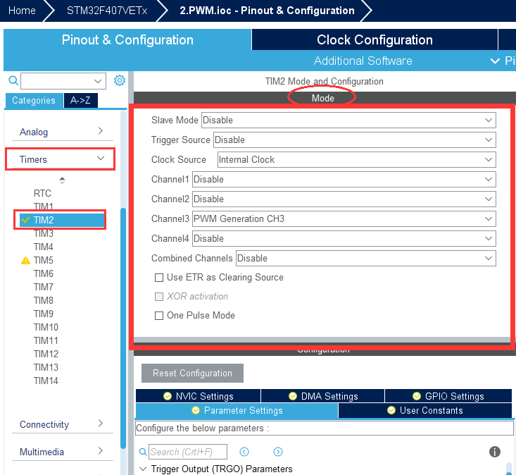

1. 配置STM32CubeMX
前面的一些基础步骤可参见:【STM32】CubeMX+HAL 点亮LED 的【1.1】~【1.6】步骤。
核心配置:
这里我使用的是 TIM2 定时器,当然使用其他的也可以,但要注意相关配置。

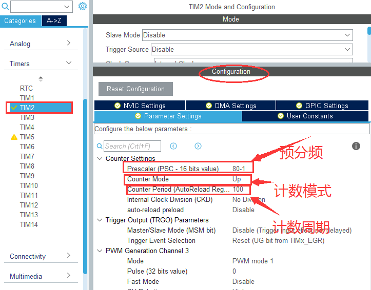

1.1 TIM2 的 Mode 配置
1.2 TIM2 的 Configuration 配置

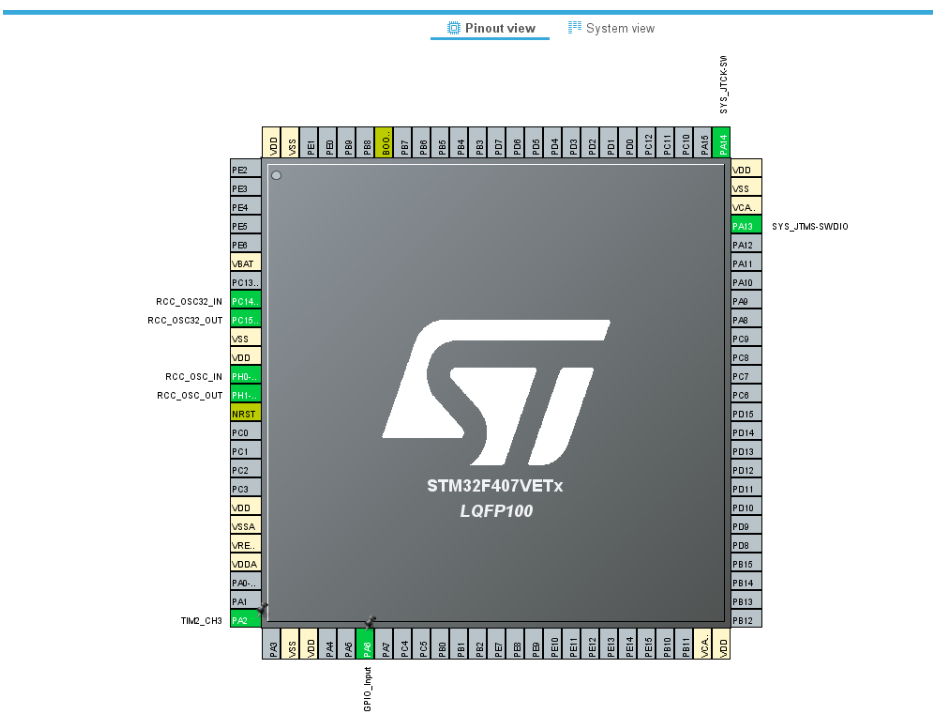

1.3 其余 GPIO 配置
PA2 的 PWM 输出作为 PA6 的输入,PA6 连接的是一个 LED ,观察是否出现呼吸灯现象。

2.1 gpio.c
  * File Name          : gpio.c
  * Description        : This file provides code for the configuration
  *                      of all used GPIO pins.
  * @attention
  * <h2><center>&copy; Copyright (c) 2020 STMicroelectronics.
  * All rights reserved.</center></h2>
  * This software component is licensed by ST under BSD 3-Clause license,
  * the "License"; You may not use this file except in compliance with the
  * License. You may obtain a copy of the License at:
  *                        opensource.org/licenses/BSD-3-Clause
/* Includes ------------------------------------------------------------------*/
#include "gpio.h"
/* USER CODE BEGIN 0 */
/* USER CODE END 0 */
/* Configure GPIO                                                             */
/* USER CODE BEGIN 1 */
/* USER CODE END 1 */
/** Configure pins as
        * Analog
        * Input
        * Output
        * EVENT_OUT
        * EXTI
void MX_GPIO_Init(void)
  GPIO_InitTypeDef GPIO_InitStruct = {0};
  /* GPIO Ports Clock Enable */
  __HAL_RCC_GPIOC_CLK_ENABLE();
  __HAL_RCC_GPIOH_CLK_ENABLE();
  __HAL_RCC_GPIOA_CLK_ENABLE();
  /*Configure GPIO pin : PA6 */
  GPIO_InitStruct.Pin = GPIO_PIN_6;
  GPIO_InitStruct.Mode = GPIO_MODE_INPUT;
  GPIO_InitStruct.Pull = GPIO_NOPULL;
  HAL_GPIO_Init(GPIOA, &GPIO_InitStruct);
/* USER CODE BEGIN 2 */
/* USER CODE END 2 */
/************************ (C) COPYRIGHT STMicroelectronics *****END OF FILE****/
2.2 time.c
  * File Name          : TIM.c
  *                      of the TIM instances.
  * @attention
#include "tim.h"
TIM_HandleTypeDef htim2;
/* TIM2 init function */
void MX_TIM2_Init(void)
  TIM_ClockConfigTypeDef sClockSourceConfig = {0};
  TIM_MasterConfigTypeDef sMasterConfig = {0};
  TIM_OC_InitTypeDef sConfigOC = {0};
  htim2.Instance = TIM2;
  htim2.Init.Prescaler = 80-1;
  htim2.Init.CounterMode = TIM_COUNTERMODE_UP;
  htim2.Init.Period = 100;
  htim2.Init.ClockDivision = TIM_CLOCKDIVISION_DIV1;
  htim2.Init.AutoReloadPreload = TIM_AUTORELOAD_PRELOAD_DISABLE;
  if (HAL_TIM_Base_Init(&htim2) != HAL_OK)
    Error_Handler();
  sClockSourceConfig.ClockSource = TIM_CLOCKSOURCE_INTERNAL;
  if (HAL_TIM_ConfigClockSource(&htim2, &sClockSourceConfig) != HAL_OK)
    Error_Handler();
  if (HAL_TIM_PWM_Init(&htim2) != HAL_OK)
    Error_Handler();
  sMasterConfig.MasterOutputTrigger = TIM_TRGO_RESET;
  sMasterConfig.MasterSlaveMode = TIM_MASTERSLAVEMODE_DISABLE;
  if (HAL_TIMEx_MasterConfigSynchronization(&htim2, &sMasterConfig) != HAL_OK)
    Error_Handler();
  sConfigOC.OCMode = TIM_OCMODE_PWM1;
  sConfigOC.Pulse = 0;
  sConfigOC.OCPolarity = TIM_OCPOLARITY_HIGH;
  sConfigOC.OCFastMode = TIM_OCFAST_DISABLE;
  if (HAL_TIM_PWM_ConfigChannel(&htim2, &sConfigOC, TIM_CHANNEL_3) != HAL_OK)
    Error_Handler();
  HAL_TIM_MspPostInit(&htim2);

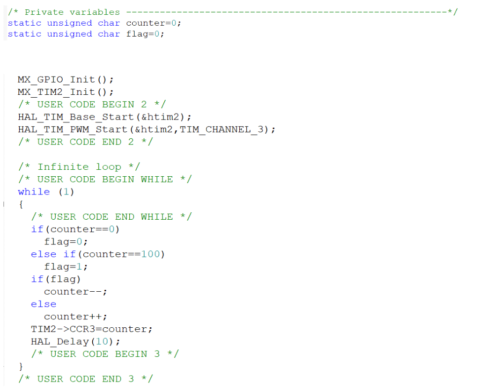

2.3 main.c
/* USER CODE BEGIN Header */
  * @file           : main.c
  * @brief          : Main program body
  * @attention
/* USER CODE END Header */
#include "main.h"
#include "tim.h"
#include "gpio.h"
/* Private includes ----------------------------------------------------------*/
/* USER CODE BEGIN Includes */
/* USER CODE END Includes */
/* Private typedef -----------------------------------------------------------*/
/* USER CODE BEGIN PTD */
/* USER CODE END PTD */
/* Private define ------------------------------------------------------------*/
/* USER CODE BEGIN PD */
/* USER CODE END PD */
/* Private macro -------------------------------------------------------------*/
/* USER CODE BEGIN PM */
/* USER CODE END PM */
/* Private variables ---------------------------------------------------------*/
static unsigned char counter=0;
static unsigned char flag=0;
/* USER CODE BEGIN PV */
/* USER CODE END PV */
/* Private function prototypes -----------------------------------------------*/
void SystemClock_Config(void);
/* USER CODE BEGIN PFP */
/* USER CODE END PFP */
/* Private user code ---------------------------------------------------------*/
  * @brief  The application entry point.
  * @retval int
int main(void)
  /* MCU Configuration--------------------------------------------------------*/
  /* Reset of all peripherals, Initializes the Flash interface and the Systick. */
  HAL_Init();
  /* USER CODE BEGIN Init */
  /* USER CODE END Init */
  /* Configure the system clock */
  SystemClock_Config();
  /* USER CODE BEGIN SysInit */
  /* USER CODE END SysInit */
  /* Initialize all configured peripherals */
  MX_GPIO_Init();
  MX_TIM2_Init();
	HAL_TIM_Base_Start(&htim2);
	HAL_TIM_PWM_Start(&htim2,TIM_CHANNEL_3);
  /* Infinite loop */
  /* USER CODE BEGIN WHILE */
  while (1)
    /* USER CODE END WHILE */
		if(counter==0)
			flag=0;
		else if(counter==100)
			flag=1;
		if(flag)
			counter--;
		else
			counter++;
		TIM2->CCR3=counter;
		HAL_Delay(10);
    /* USER CODE BEGIN 3 */
  /* USER CODE END 3 */
