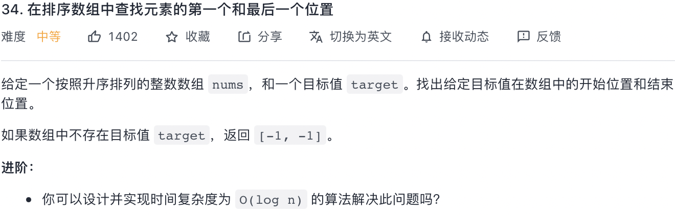

这两个例子也即可以解决力扣34题。代码如下
class Solution {
public:
    vector<int> searchRange(vector<int>& nums, int target) {
        vector<int> ans;
		if (nums.empty()) {
			ans.push_back(-1);
			ans.push_back(-1);
			return ans;
		int p1 = 0, p2 = nums.size()-1;
		while (p1 < p2) {
			int mid = p1 + p2 >> 1;
			if (nums[mid] >= target)p2 = mid;
			else p1 = mid + 1;
		if (nums[p1] != target) {
			ans.push_back(-1);
			ans.push_back(-1);
			return ans;
		ans.push_back(p1);
		while (nums[p1] == target) {
			p1++;
			if (p1 == nums.size())break;
		ans.push_back(p1 - 1);
		return ans;

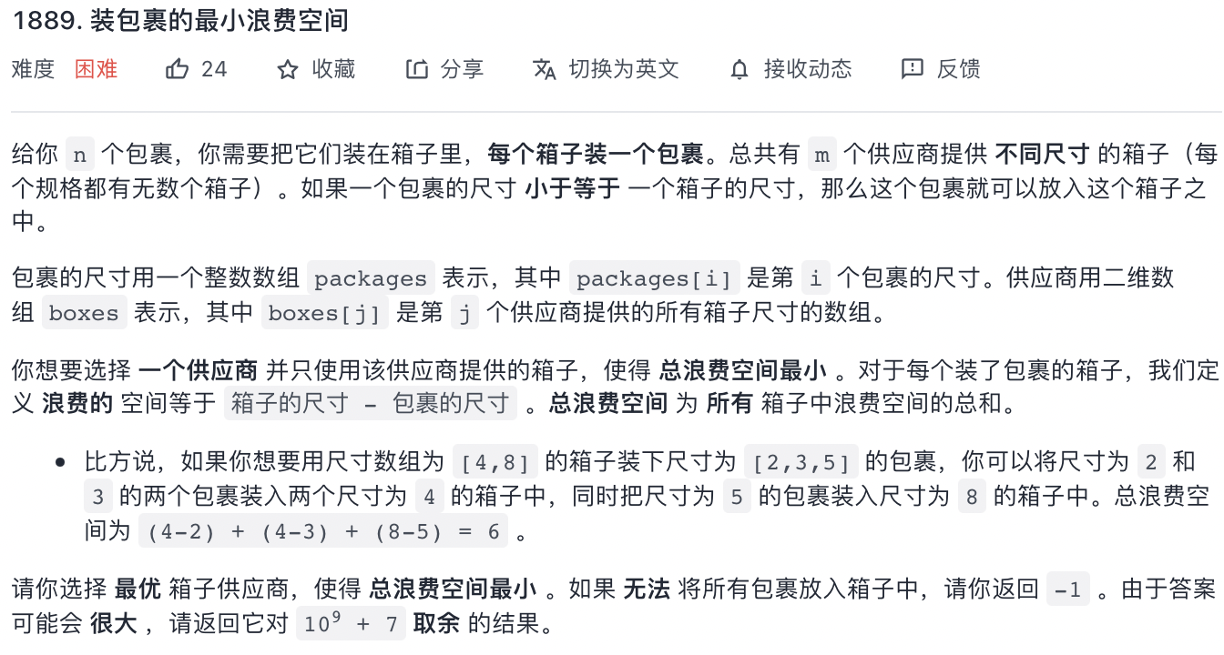

对于这一题,我们需要用尽可能小的箱子来装包裹,也即我们将包裹序列进行排序后可以通过是否能装进箱子来把序列划分成连续的两段。从小到大枚举箱子,对于每个箱子尽可能装多的包裹,即满足题意。综上,对于每个箱子我们仅需找到包裹序列中的A段最右元素。
代码如下。
class Solution {
public:
    const long long mod = 1000000007;
    int minWastedSpace(vector<int>& packages, vector<vector<int> >& boxes) {
        long long ans = LLONG_MAX;
        sort(packages.begin(), packages.end());
        int n = packages.size();
        int m = boxes.size();
        vector<long long> sum(n + 1, 0);
        for (int i = 1; i <= n; i++)sum[i] = sum[i - 1] + packages[i - 1];	//前缀和
        for (int i = 0; i < m; i++) {   //遍历每一个供应商
            int k = boxes[i].size();
            sort(boxes[i].begin(), boxes[i].end());
            if (boxes[i][k - 1] < packages[n - 1])continue; //无法装箱的情况
            long long res = 0;
            int l = 0, r = n - 1;
            int start = 0;
            for (int j = 0; j < k; j++) {  //遍历每一个箱子
                if (boxes[i][j] < packages[start])continue; //无法装箱的情况
                l = start;
                r = n - 1;
                while (l < r) {
                    int mid = l + r + 1 >> 1;
                    if (packages[mid] <= boxes[i][j])l = mid;
                    else r = mid - 1;
                if (packages[l] > boxes[i][j])continue;
                res += ((long long)boxes[i][j] * (l - start + 1) - sum[l + 1] + sum[start]);
                start = l + 1;
                if (start == n) break;
            ans = min(res, ans);
        if (ans != LLONG_MAX)return ans % mod;
        else return -1;

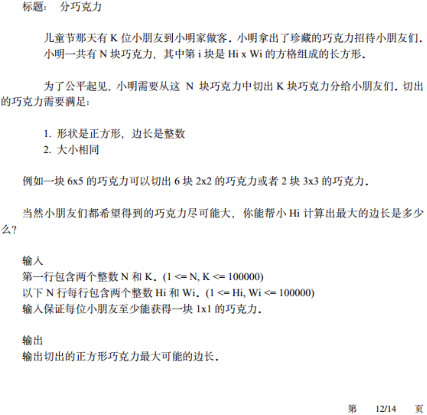

回到今天这题上来,我们可以按照可不可以划分成K块来划分边长序列,我们要使巧克力的边长尽可能大,即找A段最右边的元素
#include <iostream>
using namespace std;
const int N = 100010;
int n, k;
int h[N], w[N];
bool isOK(int a) {
    int res = 0;
    for (int i = 1;i <= n;i++)
        res += (h[i] / a) * (w[i] / a);
    return res >= k;
int main() {
    cin >> n >> k;
    for (int i = 1;i <= n;i++)cin >> h[i] >> w[i];
    int l = 1, r = 100000;
    while (l < r) {
        int mid = (l + r + 1) >> 1;
        if (isOK(mid))l = mid;
        else r = mid - 1;
    cout << l;
