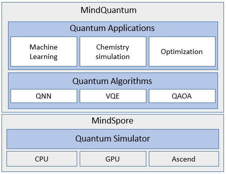

MindQuantum is general quantum computing framework designed by Mindspore and Hiq. MindQuantum can efficiently solve problem such as quantum machine learning, quantum chemistry simulation and so on.
MindQuantum Architecture

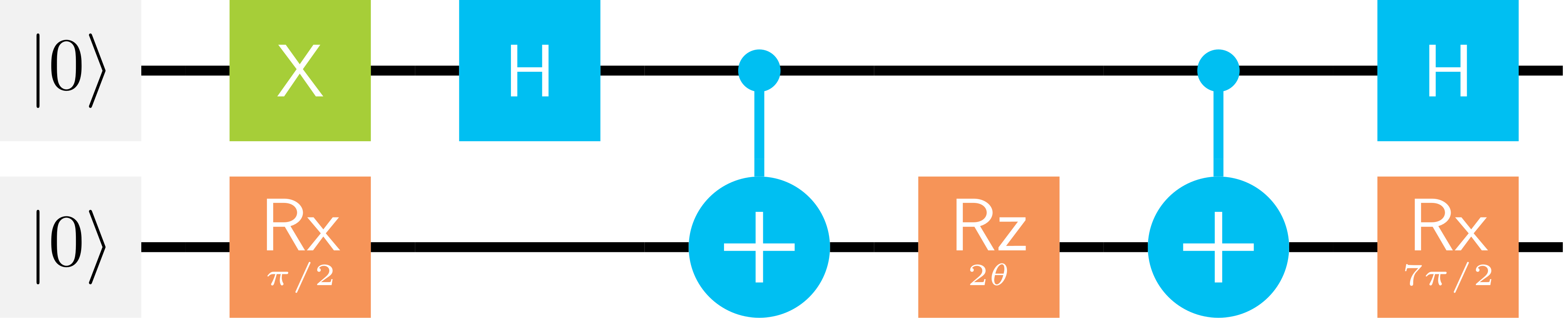

Then we should prepare the ansatz. The ansatz for our problem is
∣ ψ ( θ ) ⟩ = e − i θ X 0 Y 1 ∣ 01 ⟩ |\psi(\theta)\rangle = e^{-i\theta X_0 Y_1}|01\rangle
from mindquantum.core.operators import TimeEvolution
# Initial Hartree Fock state
hf = mq.Circuit()
hf += mq.X.on(0)
# Create ansatz circuit
u = mq.QubitOperator("X0 Y1", 't')
ansatz_circuit = TimeEvolution(u, 1.0).circuit
The quantum circuit for ansatz is shown:
ansatz
We compute the expectation for Hamiltonian as
E ( θ ) = ⟨ ψ ( θ ) ∣ H ( θ ) ∣ ψ ( θ ) ⟩ E(\theta) = \langle \psi(\theta)|H(\theta)|\psi(\theta)\rangle
By varying the parameters, we can find a minimum value , which represents the VQE approximation to ground state energy of hydrogen molecule.

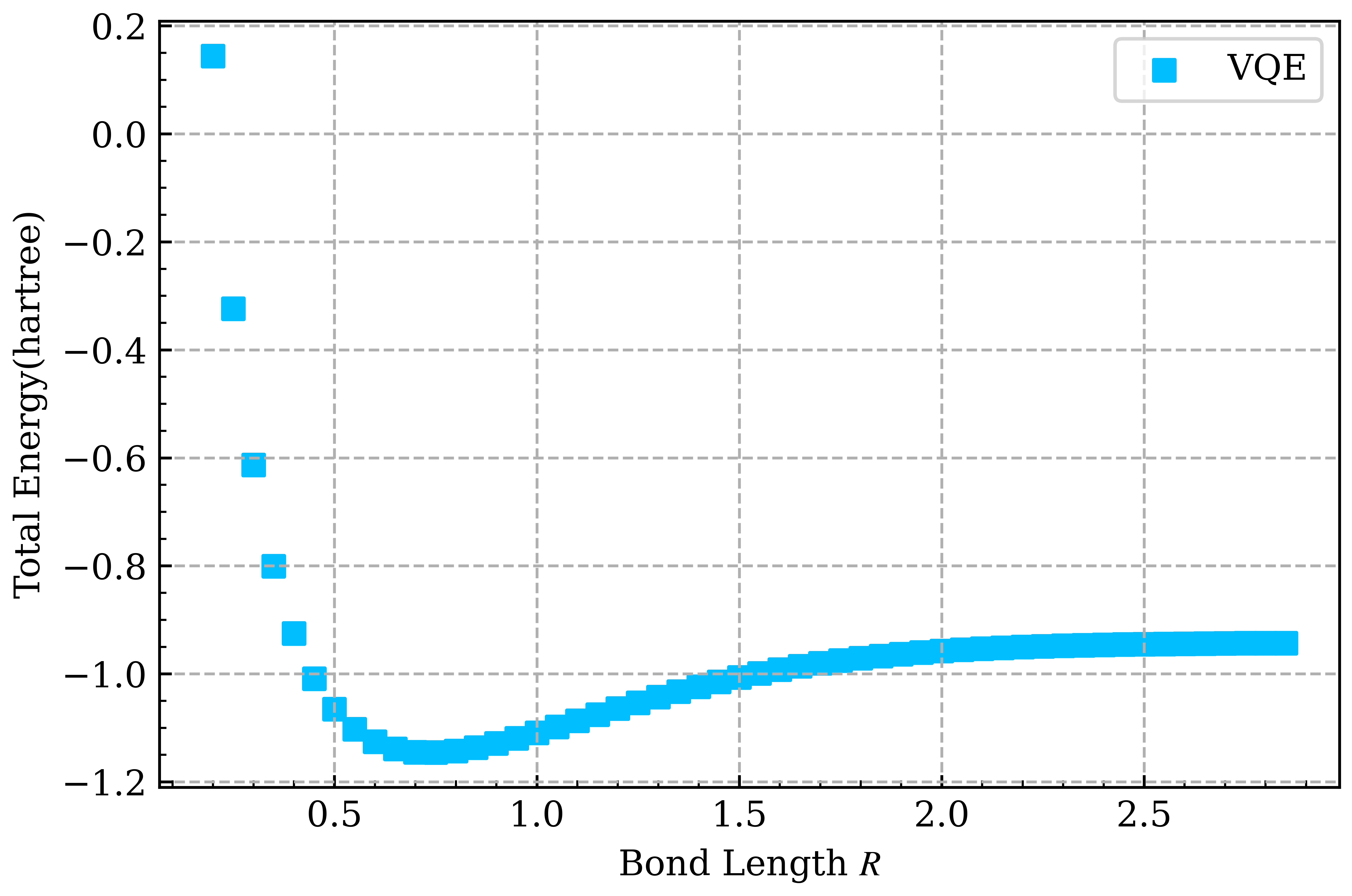

def vqe(total_circuit, all_coeff, dist, init_amp=[0.0]):
    #all_iter_list = [];
    Ei_min_list = []
    for _, coeff in enumerate(all_coeff):
        hh = hamiltonian(coeff)
        grad_ops = mq.Simulator("projectq", total_circuit.n_qubits).get_expectation_with_grad(hh, total_circuit)
        pqcent = MQAnsatzOnlyLayer(grad_ops)
        pqcent.weight = Parameter(ms.Tensor(init_amp, pqcent.weight.dtype) )
        init_E = pqcent()
        optimzer = ms.nn.Adagrad(pqcent.trainable_params(), learning_rate=4e-2)
        train_pqcent = ms.nn.TrainOneStepCell(pqcent, optimzer)
        eps = 1.e-8
        E_diff = eps * 1e3
        E_last = init_E.asnumpy() + E_diff
        iter_idx = 0
        #iter_list = []
        Ei_list = []
        while abs(E_diff) > eps:
            Ei = train_pqcent().asnumpy()
            if iter_idx % 5 == 0:
                #iter_list.append(iter_idx)
                Ei_list.append(Ei)
            E_diff = E_last - Ei
            E_last = Ei
            iter_idx += 1
        #all_iter_list.append(iter_list)
        Ei_min_list.append(min(Ei_list) )
    plot_scatter(dist, Ei_min_list)
    return None
Runing the code we design above, we get the result.
