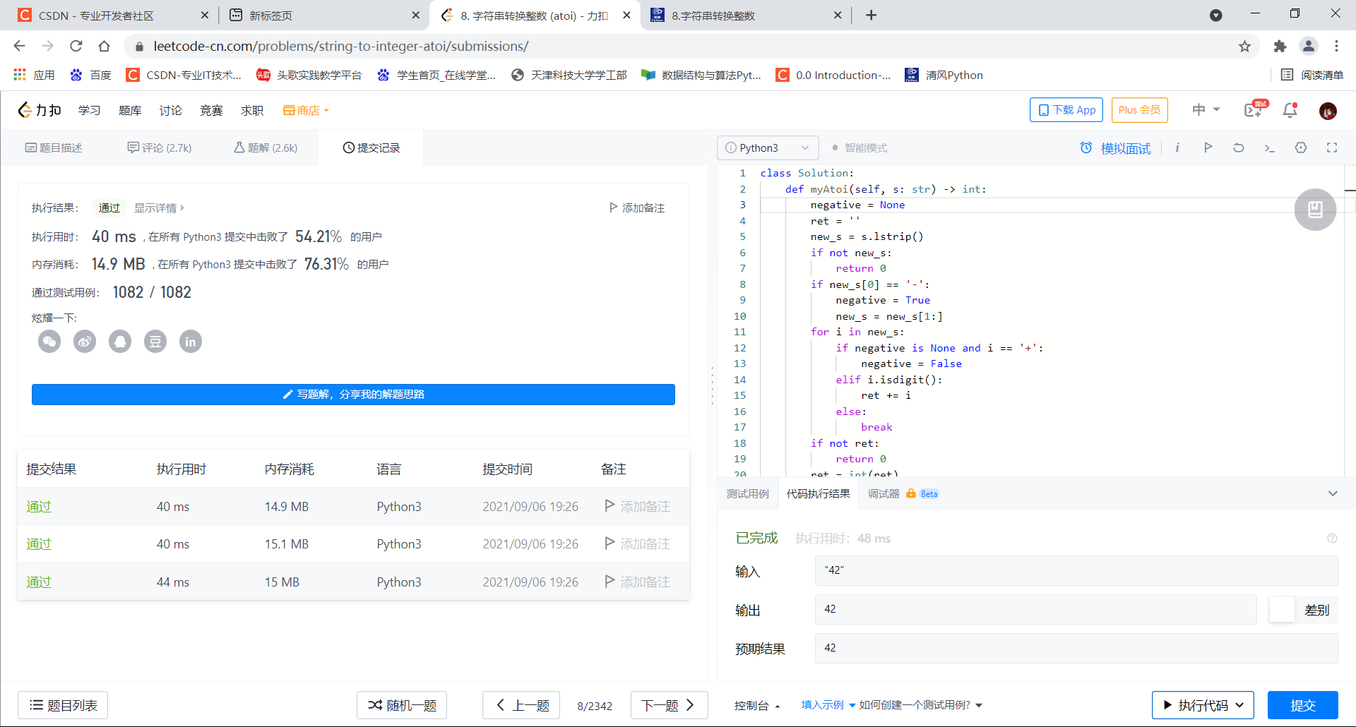

源码如下:
# -*-coding:utf-8 -*-
# @Author:到点了,心疼徐哥哥
# 奥利给干!!!
def myAtoi(s) :
    negative = None
    ret = ''
    new_s = s.lstrip()#lstrip:用来去除开头字符、空白符(包括\n、\r、\t、' ',即:换行、回车、制表符、空格)
    if not new_s:
        return 0
    if new_s[0] == '-':
        negative = True
        new_s = new_s[1:]
    for i in new_s:
        if negative is \
                None and i == '+':
            negative = False
        elif i.isdigit():#所有字符都是数字;
            ret += i
        else:
            break
    if not ret:
        return 0
    ret = int(ret)
    if negative:
        ret = -ret
        return max(ret, -2 ** 31)
    return min(2 ** 31 - 1, ret)
print(myAtoi( '-865dd55'))
