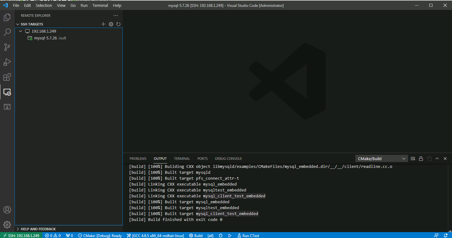

2.5 配置vscode通过remote ssh连接Linux的配置文件C:\Users\Administrator\.ssh\config
Host 192.168.1.249
HostName 192.168.1.249
User root
IdentityFile "D:\ssh\vscode"

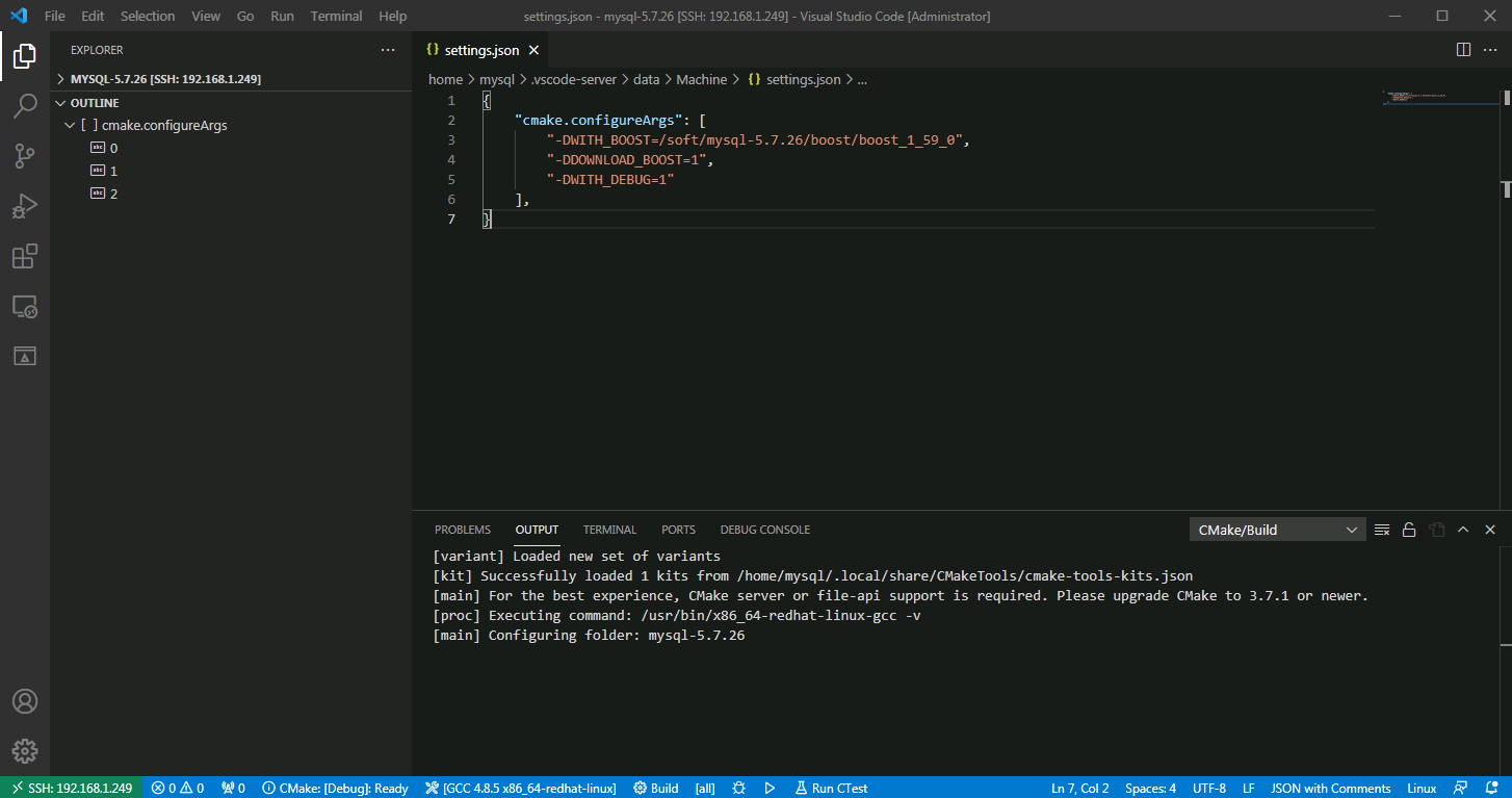

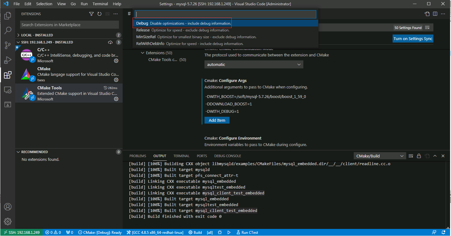

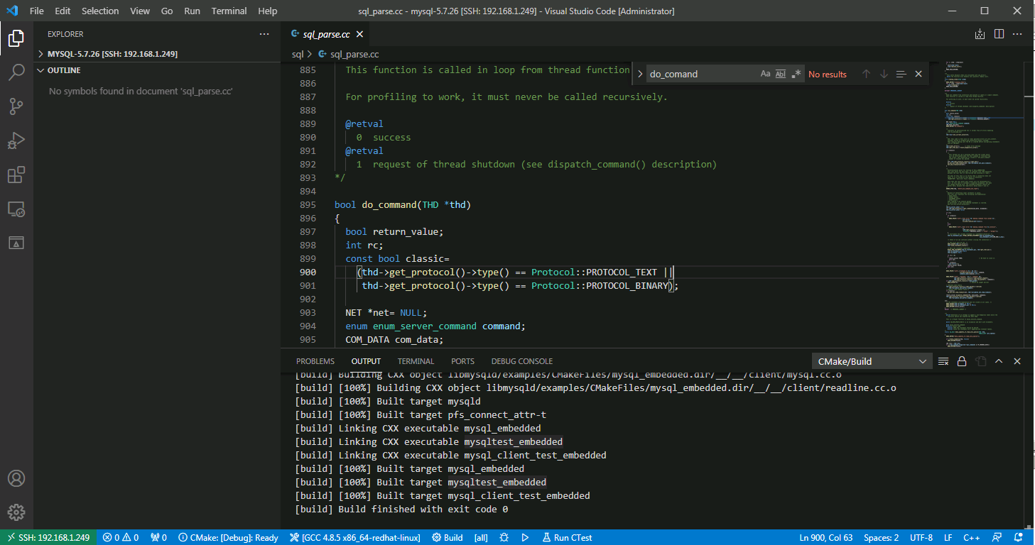

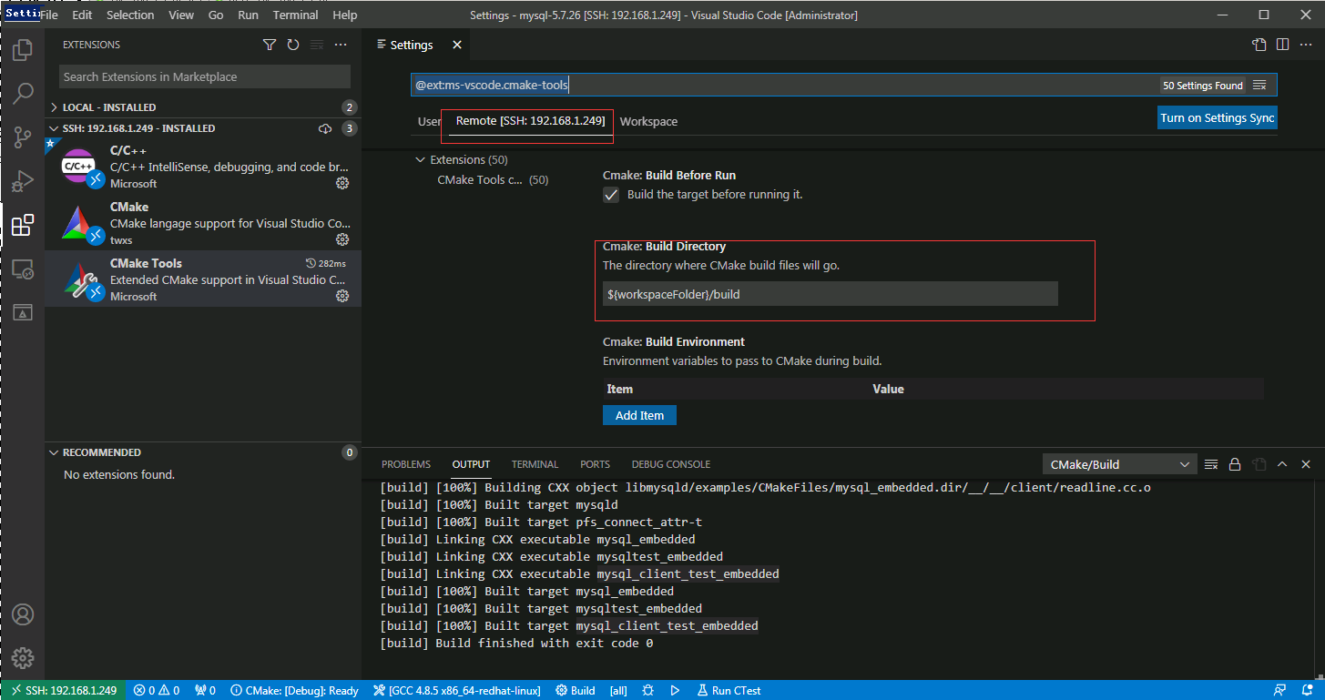

3.vscode在远程远程服务器上依次安装 C/C++、CMake、CMake Tools插件

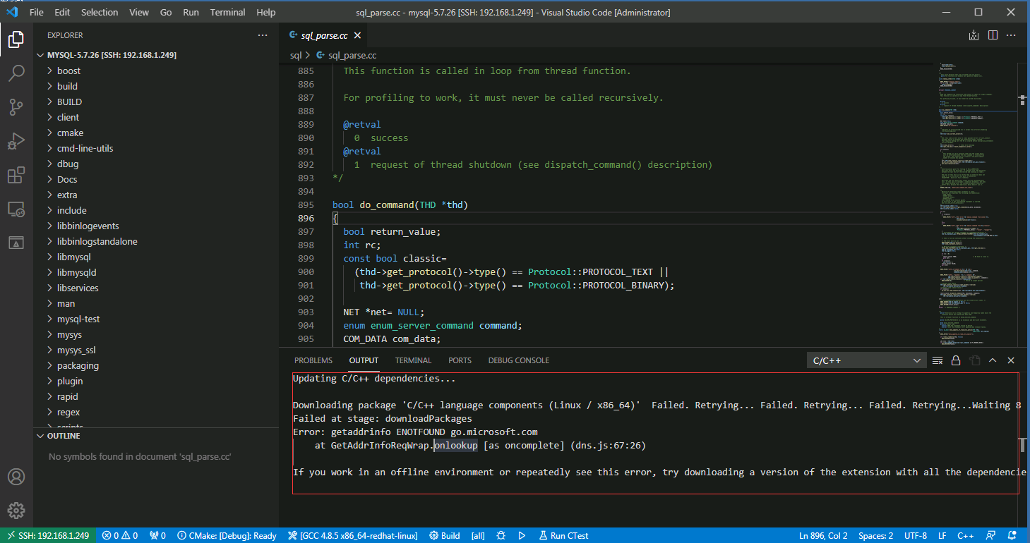

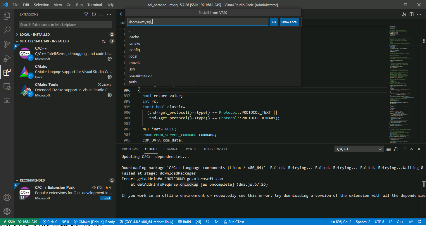

在使用vscode 远程调试程序时出现以下信息:
Updating C/C++ dependencies...
Downloading package 'C/C++ language components (Linux / x86_64)' Failed. Retrying... Failed. Retrying... Failed. Retrying...Waiting 8 seconds... Failed. Retrying...Waiting 15 seconds... Failed. Retrying...Waiting 15 seconds... Failed. Retrying...Waiting 15 seconds... Failed. Retrying...Waiting 15 seconds... Failed. Retrying...Waiting 15 seconds... Failed. Retrying...Waiting 15 seconds... Failed to download https://go.microsoft.com/fwlink/?linkid=2170969
Failed at stage: downloadPackages
Error: getaddrinfo ENOTFOUND go.microsoft.com
    at GetAddrInfoReqWrap.onlookup [as oncomplete] (dns.js:67:26)
If you work in an offline environment or repeatedly see this error, try downloading a version of the extension with all the dependencies pre-included from https://github.com/microsoft/vscode-cpptools/releases, then use the "Install from VSIX" command in VS Code to install it.
安装 C/C++ language components插件失败
我们只能手动安装
打开网址https://go.microsoft.com/fwlink/?linkid=2170969下载bin_linupwd
x.zip文件
将bin_linux.zip文件解压
cpptools
cpptools-srv
LICENSE.txt
将这三个文件拷贝到远程Linux服务器的/home/mysql/.vscode-server/extensions/ms-vscode.cpptools-1.6.0/bin目录中
如果原先存在这个文件的话先将其备份。
sftp> put F:\bin_linux\bin\*
Uploading cpptools to /home/mysql/.vscode-server/extensions/ms-vscode.cpptools-1.6.0/bin/cpptools
100% 19544KB 19544KB/s 00:00:00
F:/bin_linux/bin/cpptools: 20014008 bytes transferred in 0 seconds (19544 KB/s)
Uploading cpptools-srv to /home/mysql/.vscode-server/extensions/ms-vscode.cpptools-1.6.0/bin/cpptools-srv
100% 11508KB 11508KB/s 00:00:00
F:/bin_linux/bin/cpptools-srv: 11784664 bytes transferred in 0 seconds (11508 KB/s)
Uploading LICENSE.txt to /home/mysql/.vscode-server/extensions/ms-vscode.cpptools-1.6.0/bin/LICENSE.txt
100% 11KB 11KB/s 00:00:00
F:/bin_linux/bin/LICENSE.txt: 11972 bytes transferred in 0 seconds (11 KB/s)
但是没有用,仍然报错

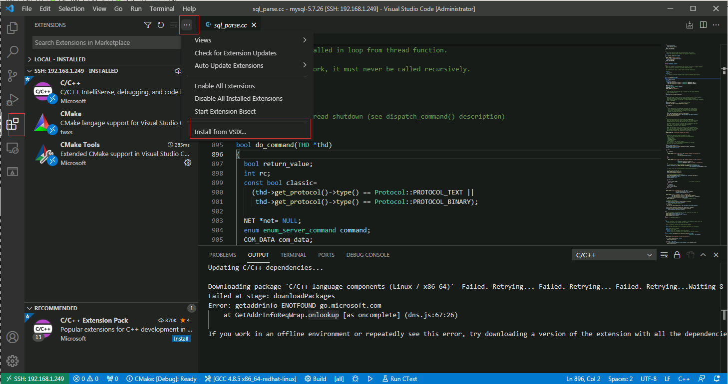

如是通过vsix来进行安装
github上release好多个版本,我远程看代码的主机是redhat Linux系统,所有下载cpptools-linux.vsix。
先删除我们上传到/home/mysql/.vscode-server/extensions/ms-vscode.cpptools-1.6.0/bin的三个文件

通过vscode 从vsix来进行安装,选择本地目录D:\ssh\cpptools-linux.vsix文件
[mysql@gbase bin]$ ls -lrt
total 31188
-rw-rw-r--. 1 mysql mysql 582 Sep 26 15:01 common.json
-rw-rw-r--. 1 mysql mysql 20014008 Sep 26 15:01 cpptools
-rw-rw-r--. 1 mysql mysql 11784664 Sep 26 15:01 cpptools-srv
-rw-rw-r--. 1 mysql mysql 11972 Sep 26 15:01 LICENSE.txt
-rw-rw-r--. 1 mysql mysql 301 Sep 26 15:01 linux.clang.arm.json
-rw-rw-r--. 1 mysql mysql 310 Sep 26 15:01 linux.clang.arm64.json
-rw-rw-r--. 1 mysql mysql 300 Sep 26 15:01 linux.clang.x64.json
-rw-rw-r--. 1 mysql mysql 291 Sep 26 15:01 linux.clang.x86.json
-rw-rw-r--. 1 mysql mysql 301 Sep 26 15:01 linux.gcc.arm.json
-rw-rw-r--. 1 mysql mysql 310 Sep 26 15:01 linux.gcc.arm64.json
-rw-rw-r--. 1 mysql mysql 302 Sep 26 15:01 linux.gcc.x64.json
-rw-rw-r--. 1 mysql mysql 291 Sep 26 15:01 linux.gcc.x86.json
-rw-rw-r--. 1 mysql mysql 284 Sep 26 15:01 macos.clang.arm.json
-rw-rw-r--. 1 mysql mysql 293 Sep 26 15:01 macos.clang.arm64.json
-rw-rw-r--. 1 mysql mysql 283 Sep 26 15:01 macos.clang.x64.json
-rw-rw-r--. 1 mysql mysql 274 Sep 26 15:01 macos.clang.x86.json
-rw-rw-r--. 1 mysql mysql 284 Sep 26 15:01 macos.gcc.arm.json
-rw-rw-r--. 1 mysql mysql 293 Sep 26 15:01 macos.gcc.arm64.json
-rw-rw-r--. 1 mysql mysql 283 Sep 26 15:01 macos.gcc.x64.json
-rw-rw-r--. 1 mysql mysql 274 Sep 26 15:01 macos.gcc.x86.json
drwxrwxr-x. 15 mysql mysql 145 Sep 26 15:01 messages
-rw-rw-r--. 1 mysql mysql 87 Sep 26 15:01 windows.clang.arm.json
-rw-rw-r--. 1 mysql mysql 87 Sep 26 15:01 windows.clang.arm64.json
-rw-rw-r--. 1 mysql mysql 87 Sep 26 15:01 windows.clang.x64.json
-rw-rw-r--. 1 mysql mysql 87 Sep 26 15:01 windows.clang.x86.json
-rw-rw-r--. 1 mysql mysql 87 Sep 26 15:01 windows.gcc.arm.json
-rw-rw-r--. 1 mysql mysql 89 Sep 26 15:01 windows.gcc.arm64.json
-rw-rw-r--. 1 mysql mysql 87 Sep 26 15:01 windows.gcc.x64.json
-rw-rw-r--. 1 mysql mysql 87 Sep 26 15:01 windows.gcc.x86.json
-rw-rw-r--. 1 mysql mysql 299 Sep 26 15:01 windows.msvc.arm.json
-rw-rw-r--. 1 mysql mysql 324 Sep 26 15:01 windows.msvc.arm64.json
-rw-rw-r--. 1 mysql mysql 383 Sep 26 15:01 windows.msvc.x64.json
-rw-rw-r--. 1 mysql mysql 359 Sep 26 15:01 windows.msvc.x86.json
重启vscdoe
4.使用vscode远程编译Linux服务器的MySQL源码,mysql源码在/soft/mysql-5.7.26/目录

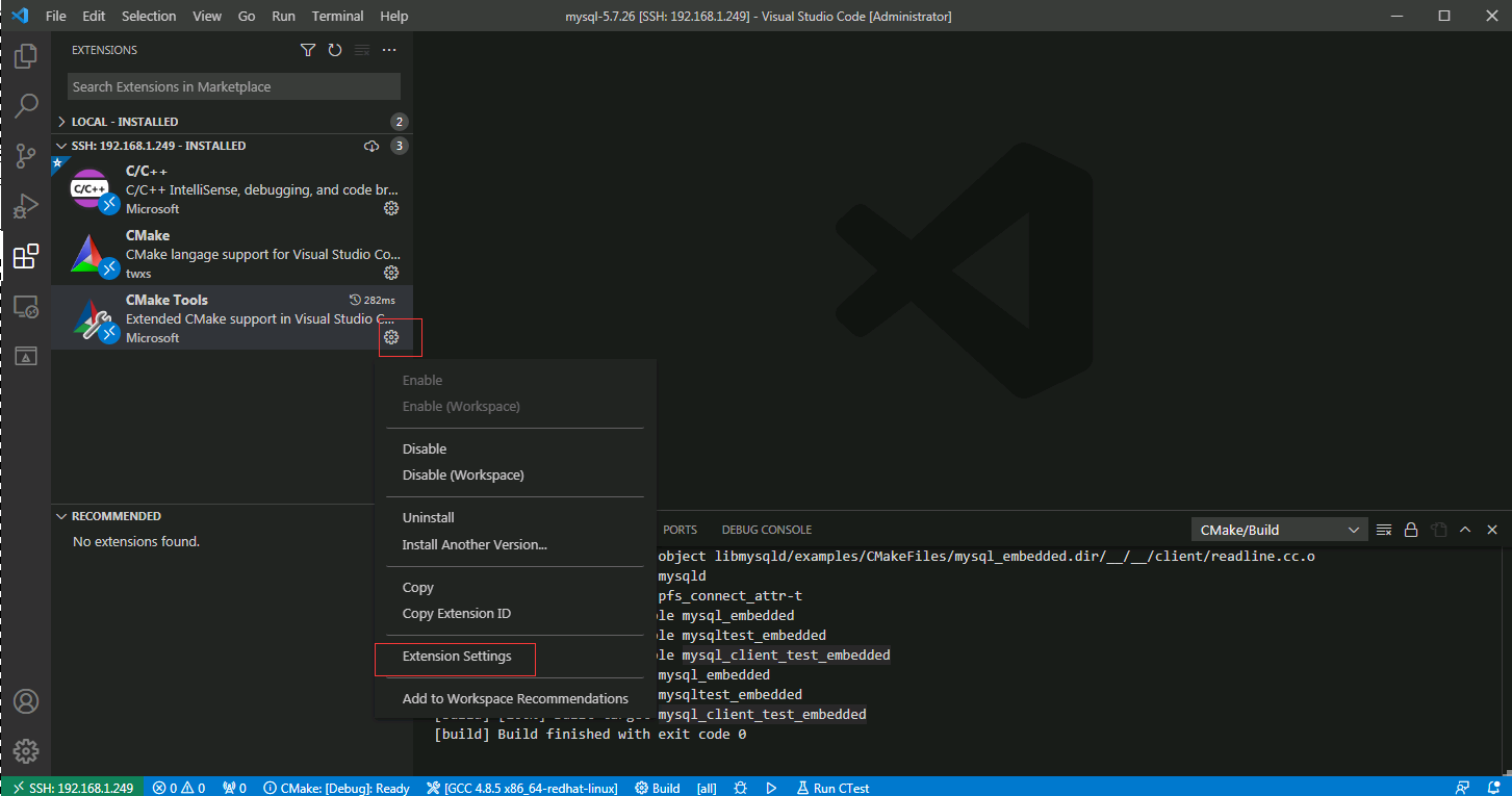

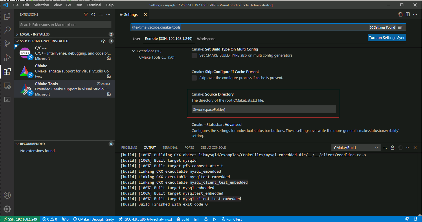

这里需要配置Cmake 生成setting.json配置文件 点击CMake Tool的设置按钮,再点击Extention Settings
这里选择Remote [SSH:192.168.1.249],我这对于Build Directory选择使用默认配置,因为${workspaceFolder}就是/soft/mysql-5.7.26目录,所以$${workspaceFolder}/build也就是/soft/mysql-5.7.26/build目录
所以Source Directory目录选择使用默认的$workspaceFolder}目录

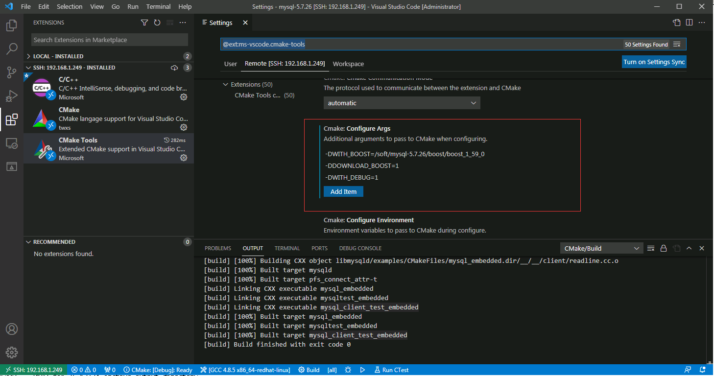

给Configure Args配置以下三个参数
-DWITH_BOOST=/soft/mysql-5.7.26/boost/boost_1_59_0
-DDOWNLOAD_BOOST=1
-DWITH_DEBUG=1

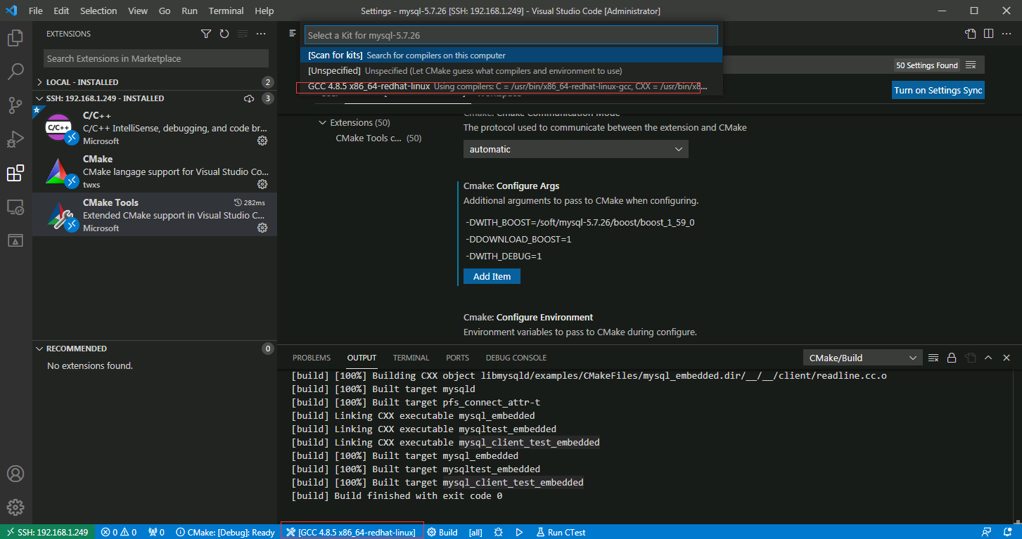

选择编译器
给CMake选择Debug模式
然后进行编译

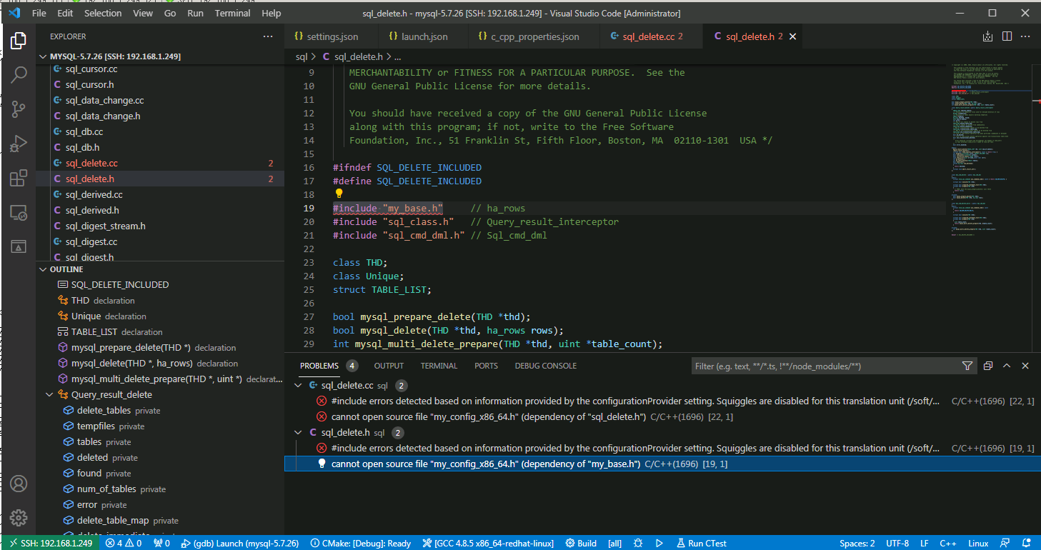

[mysql@gbase mysql-5.7.26]$ gcc -v -E -x c++ -
Using built-in specs.
COLLECT_GCC=gcc
Target: x86_64-redhat-linux
Configured with: ../configure --prefix=/usr --mandir=/usr/share/man --infodir=/usr/share/info --with-bugurl=http://bugzilla.redhat.com/bugzilla --enable-bootstrap --enable-shared --enable-threads=posix --enable-checking=release --with-system-zlib --enable-__cxa_atexit --disable-libunwind-exceptions --enable-gnu-unique-object --enable-linker-build-id --with-linker-hash-style=gnu --enable-languages=c,c++,objc,obj-c++,java,fortran,ada,go,lto --enable-plugin --enable-initfini-array --disable-libgcj --with-isl=/builddir/build/BUILD/gcc-4.8.5-20150702/obj-x86_64-redhat-linux/isl-install --with-cloog=/builddir/build/BUILD/gcc-4.8.5-20150702/obj-x86_64-redhat-linux/cloog-install --enable-gnu-indirect-function --with-tune=generic --with-arch_32=x86-64 --build=x86_64-redhat-linux
Thread model: posix
gcc version 4.8.5 20150623 (Red Hat 4.8.5-39) (GCC)
COLLECT_GCC_OPTIONS='-v' '-E' '-mtune=generic' '-march=x86-64'
/usr/libexec/gcc/x86_64-redhat-linux/4.8.5/cc1plus -E -quiet -v -D_GNU_SOURCE - -mtune=generic -march=x86-64
ignoring nonexistent directory "/usr/lib/gcc/x86_64-redhat-linux/4.8.5/include-fixed"
ignoring nonexistent directory "/usr/lib/gcc/x86_64-redhat-linux/4.8.5/../../../../x86_64-redhat-linux/include"
#include "..." search starts here:
#include <...> search starts here:
/usr/lib/gcc/x86_64-redhat-linux/4.8.5/../../../../include/c++/4.8.5
/usr/lib/gcc/x86_64-redhat-linux/4.8.5/../../../../include/c++/4.8.5/x86_64-redhat-linux
/usr/lib/gcc/x86_64-redhat-linux/4.8.5/../../../../include/c++/4.8.5/backward
/usr/local/include
/usr/include

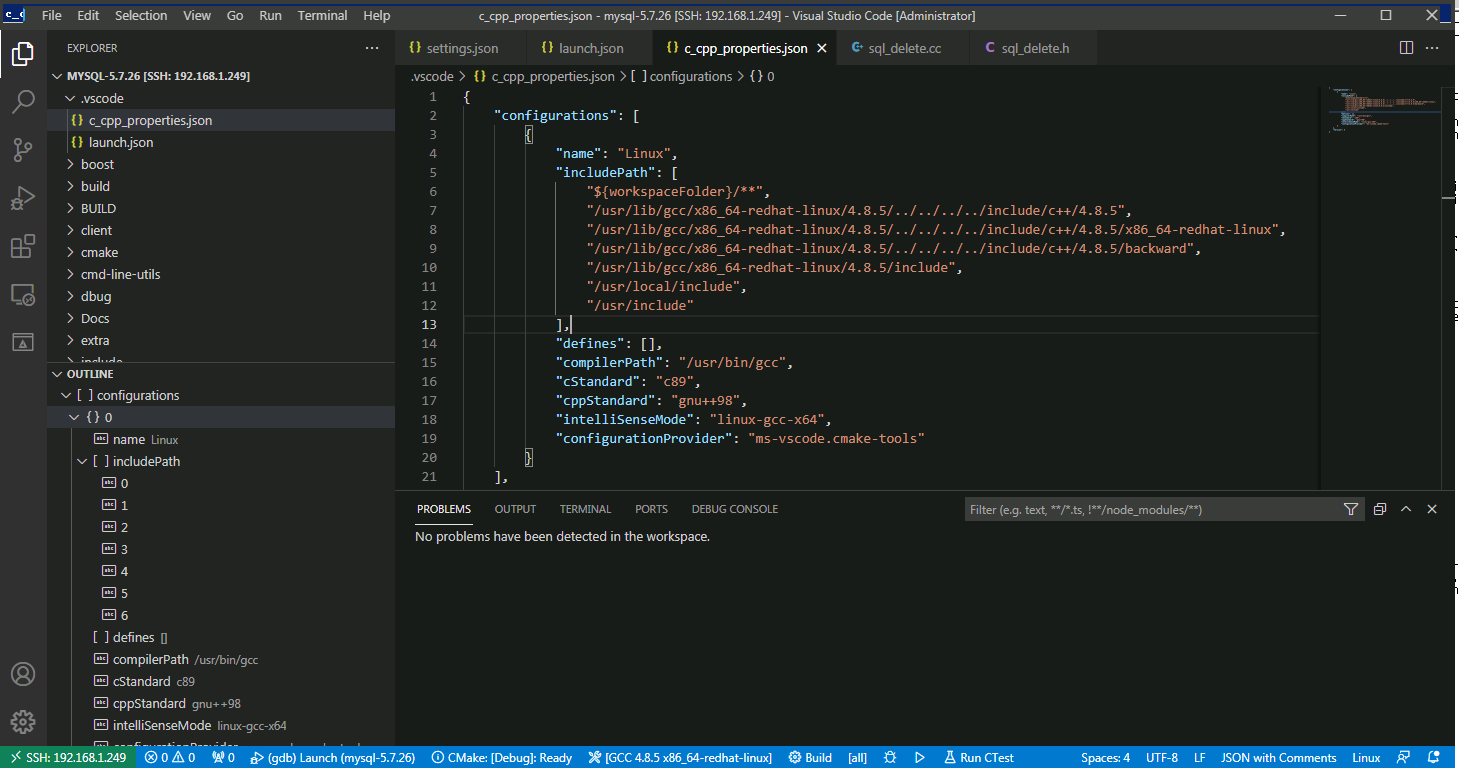

将下面的内容加入到c_cpp_properties.json中的includePath中
/usr/local/include
/usr/include
加入后错误信息消失
