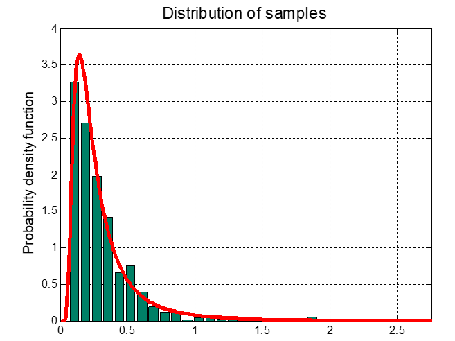

[n1, x1] = hist(theta, ceil(sqrt(N)));
bar(x1,n1/(N*(x1(2)-x1(1))));   colormap summer;   hold on;   % Normalized histogram
plot(xx, p(xx)/trapz(xx,p(xx)), 'r-', 'LineWidth', 3);        % Normalized function
grid on;   xlim([0 max(theta)]);
title('Distribution of samples', 'FontSize', 14);
ylabel('Probability density function', 'FontSize', 12);
四、心得体会
掌握了马尔科夫抽样与M-H抽样的原理,了解了通过MCMC方法获取指定概率分布模拟样本的目的。
