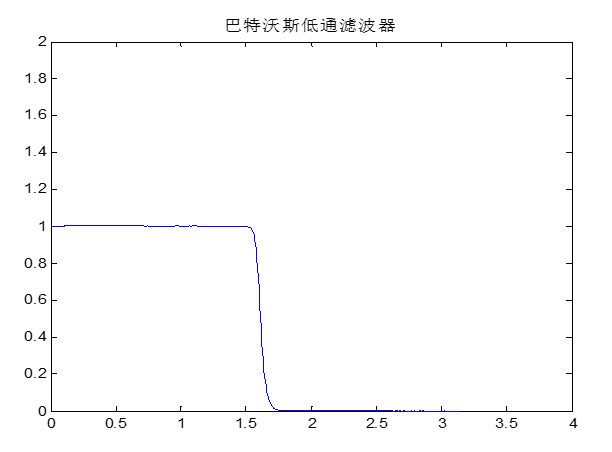

2.1 巴特沃斯低通滤波器
Fs = 2000;
fp = 500;
fs = 550;
As = 40;
Ap = 1;
[n,fn] = buttord(fp/(Fs/2),fs/(Fs/2),Ap,As); [b,a] = butter(n,fn);
[h,w] = freqz(b,a);
figure(1)
Hf=abs(h);
plot(w,Hf)
title('巴特沃斯低通滤波器')
axis([0 4 0 2])

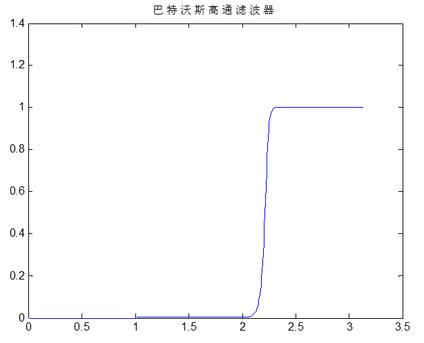

2.2 巴特沃斯高通滤波器
clear
Fs = 12000; fp = 4300;
fs = 4000;
As = 40;
Ap = 1;
[b,a] = butter(n,fn,'high');
[h,w] = freqz(b,a);
figure(1)
Hf=abs(h);
plot(w,Hf)
title('巴特沃斯高通滤波器')

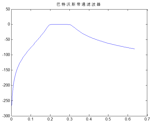

2.3 巴特沃斯带通滤波器
fp1=1200;fp2=3000;
fs1=1000;fs2=3200;
wp=[0.1*2*pi 0.15*2*pi];
ws=[0.05*2*pi 0.2*2*pi];
Rp=1;Rs=40;
[N,Wn]=buttord(wp,ws,Rp,Rs,'s');
fprintf('巴特沃斯带通滤波器 N= %4d\n',N);
[bb,ab]=butter(N,Wn,'s');
W=0:0.01:2;
[Hb,wb]=freqs(bb,ab,W);
plot(wb/pi,20*log10(abs(Hb)),'b');
hold on
title('巴特沃斯带通滤波器')
