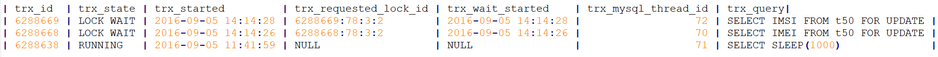

5.7 例子
事务1
SELECT MSISDN FROM t50 FOR UPDATE;
SELECT SLEEP(1000);
事务2
SELECT IMEI FROM t50 FOR UPDATE;
事务3
SELECT IMSI FROM t50 FOR UPDATE;

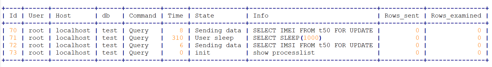

SQL命令
show processlist;

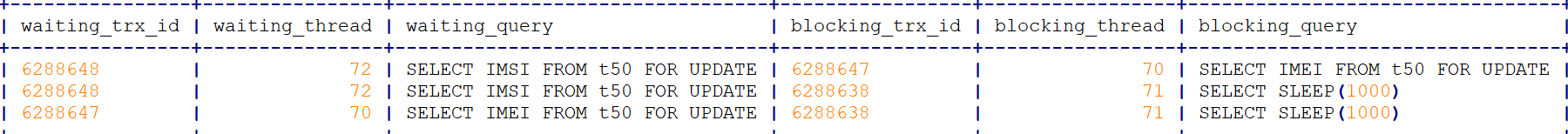

mysql> select * from information_schema.INNODB_LOCK_WAITS;
查看锁的信息
SELECT r.trx_id waiting_trx_id, r.trx_mysql_thread_id waiting_thread,r.trx_query waiting_query, b.trx_id blocking_trx_id,
            b.trx_mysql_thread_id blocking_thread,b.trx_query blocking_query
      FROM  information_schema.innodb_lock_waits w
      INNER JOIN information_schema.innodb_trx b  ON b.trx_id = w.blocking_trx_id
      INNER JOIN information_schema.innodb_trx r  ON r.trx_id = w.requesting_trx_id;
select trx_id,trx_state,trx_started,trx_requested_lock_id,trx_wait_started,trx_mysql_thread_id,trx_query from information_schema.INNODB_TRX;

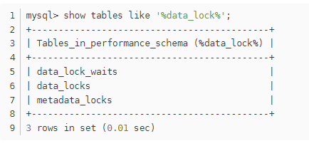

在performance_schema下新增了data_locks表和data_lock_waits表 (代替了 5.7 information_schema的INNODB_LOCK_WAITS)
Show tables like “%data_lock%”
Data_locks

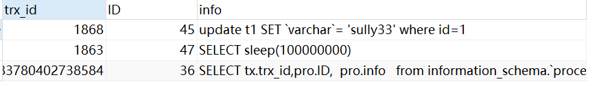

查询线程thread_id&事务id对应关系
SELECT tx.trx_id,pro.ID,  pro.info   from information_schema.`processlist` pro JOIN information_schema.INNODB_TRX tx  on
 pro.id = tx.trx_mysql_thread_id
where pro.COMMAND != 'Sleep';

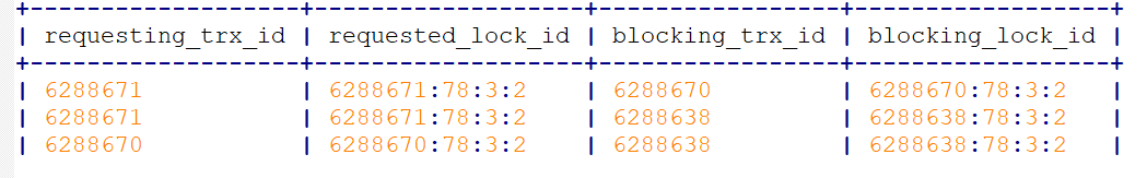

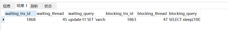

查询锁占用和等待的情况
SELECT
FROM
	`performance_schema`.data_lock_waits w
	INNER JOIN information_schema.innodb_trx b ON b.trx_id = w.REQUESTING_ENGINE_TRANSACTION_ID
	INNER JOIN information_schema.innodb_trx r ON r.trx_id = w.BLOCKING_ENGINE_TRANSACTION_ID;
REQUESTING_ENGINE_TRANSACTION_ID  1868
BLOCKING_ENGINE_TRANSACTION_ID   1863

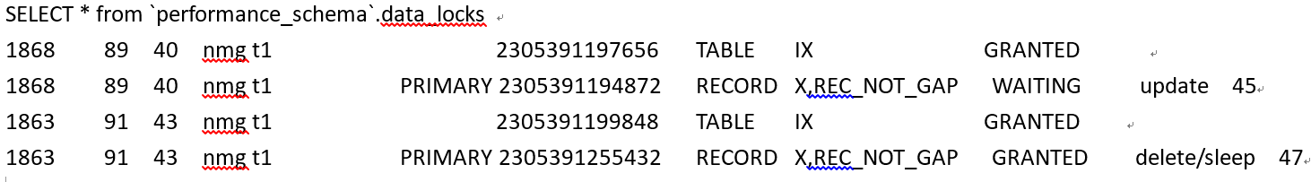

# 查询 事务ID和持有锁的情况
SELECT * from `performance_schema`.data_locks
