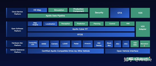

【摘要】 1   Apollo软件架构Core software modules running on the Apollo powered autonomous vehicle include: Perception — The perception module identifies the world surrounding the autonomous vehicle. There are t...

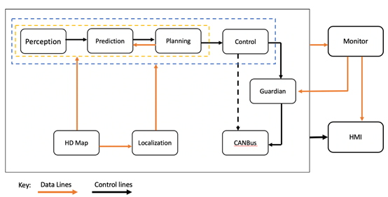

1   Apollo软件架构
  • Perception — The perception module identifies the world surrounding the autonomous vehicle. There are two important submodules inside perception: obstacle detection and traffic light detection.
  • Prediction — The prediction module anticipates the future motion trajectories of the perceived obstacles.
  • Routing — The routing module tells the autonomous vehicle how to reach its destination via a series of lanes or roads.
  • Planning — The planning module plans the spatio-temporal trajectory for the autonomous vehicle to take.
  • Control — The control module executes the planned spatio-temporal trajectory by generating control commands such as throttle, brake, and steering.
  • CanBus — The CanBus is the interface that passes control commands to the vehicle hardware. It also passes chassis information to the software system.
  • HD-Map — This module is similar to a library. Instead of publishing and subscribing messages, it frequently functions as query engine support to provide ad-hoc structured information regarding the roads.
  • Localization — The localization module leverages various information sources such as GPS, LiDAR and IMU to estimate where the autonomous vehicle is located.
  • HMI - Human Machine Interface or DreamView in Apollo is a module for viewing the status of the vehicle, testing other modules and controlling the functioning of the vehicle in real-time.
  • Monitor - The surveillance system of all the modules in the vehicle including hardware.
  • Guardian - A new safety module that performs the function of an Action Center and intervenes should Monitor detect a failure.
  • Storytelling - A new module that isolates and manages complex scenarios, creating stories that would trigger multiple modules' actions. All other modules can subscribe to this particular module.
Apollo Software Architecture
 Every module is running as a separate CarOS-based ROS node. Each module node publishes and subscribes certain topics. The subscribed topics serve as data input while the published topics serve as data output. The detailed interactions are described in the following sections.

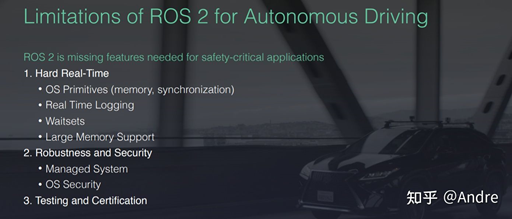

Apollo 3.5以前使用的系统为ROS,各节点之间的通信方式为进程间的通信。在实际的应用中,ROS在自动驾驶领域遇到很多挑战:
  • 调度的不确定性:ROS的算法模块以独立进程的形式存在,独立进程的节点的运行顺序无法确定,因此业务逻辑的调度顺序无法保证。
  • 运行效率:ROS是一个分布式的系统,存在通信的开销。
  • ROS系统中还存在其他很多不确定的地方,比如内存的动态申请。ROS的资源分配时不确定的,

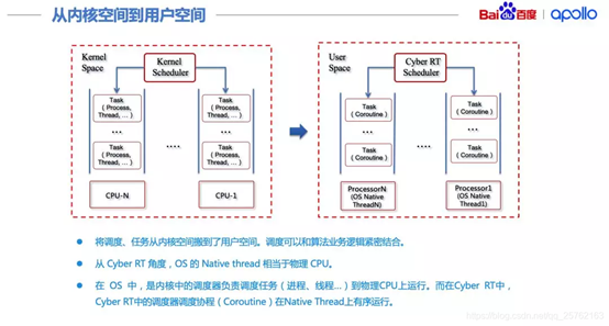

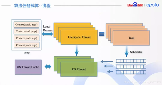

ROS的主要挑战之一是:ROS的算法模块以独立进程的形式存在,独立进程的节点的运行顺序无法确定,因此业务逻辑的调度顺序无法保证。为了解决这个问题,Cyber RT将调度、任务从内核空间搬到了任务空间,使得调度可以和算法业务逻辑紧密结合。 从Cyber RT角度,OS的Native thread相当于物理CPU。在OS中,是内核中的调度器负责调度任务(进程、线程……)到物理CPU上运行。而在Cyber RT中,是Cyber RT中的调度器调度协程(Coroutine)在Native Thread上有序运行。
CyberRT驱动需求
Cyber RT为什么要使用协程?
        Apollo将算法模块搭载在协程上,关于协程和线程的区别可以简单的描述为:协程是轻量化的线程,线程是进程下面的多个并行化任务,线程与线程之间的通信必须经过信道进行,然而协程能够直接经过访问全局变量来进行协程之间的通讯。Cyber RT通过croutine模块实现了一个高性能的协程库,为整个系统提供协程的调用。

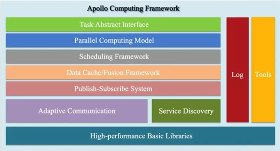

5   Cyber RT架构
  • 基础库:Cyber RT为了高性能和减少依赖,实现了自己的基础库。(Lock-free的对象池,队列)

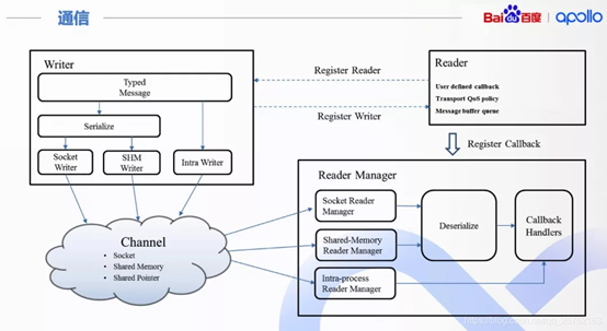

  • 通信层:Publish/Subscribe机制,Service/Client机制,服务自发现,自适应的通信机制(共享内存、Socket、进程内存),Cyber RT支持跨进程、跨机通信,上层业务逻辑无需关心,通信层会根据算法模块的部署,自动选择相应通信机制
  • 数据缓存/融合层:数据缓存与融合。多路传感器之间数据需要融合,而且算法可能需要缓存一定的数据。比如典型的仿真应用,不同算法模块之间需要有一个数据桥梁,数据层起到了这个模块间通信的桥梁的作用
  • 计算层:计算模型,任务以及任务调度
  • 接口: Cyber RT为开发者提供了component类,开发者的算法业务模块只需要继承该类,实现其中的proc接口即可。该接口类似于ROS的callback,消息通过参数的方式传递。此外Cyber RT也提供了并行计算的相关接口以及用于开发调试、录制回放的工具。

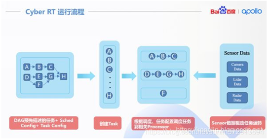

7   CyberRT运行流程
  • 算法模块:算法模块通过有向无环图(DAG, Directed Acyclic Graph)配置任务间的逻辑关系。每个算法都可以进行优先级、运行时间、使用资源等方面的配置。
  • 创建任务:Cyber RT可以结合DAG创建任务,任务的实现方式不是thread,而是协程(coroutine)。
  • 调度器:调度器根据调度、任务配置将任务放入相关Processor的队列中。
  • 数据输入: Senor输入数据驱动系统的运转。

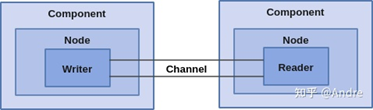

8   CyberRT数据流程

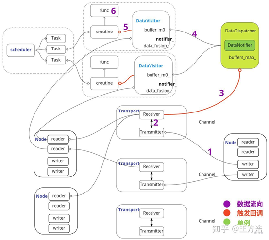

CyberRT的数据流程可以分为6个过程:
  1. Node节点中的Writer往通道里面写数据。
  2. 通道中的Transmitter发布消息,通道中的Receiver订阅消息。
  3. Receiver接收到消息之后,触发回调,触发DataDispather进行消息分发。
  4. DataDispather接收到消息后,把消息放入CacheBuffer,并且触发Notifier,通知对应的DataVisitor处理消息。
  5. DataVisitor把数据从CacheBuffer中读出,并且进行融合,然后通过notifier_唤醒对应的协程。
  6. 协程执行对应的注册回调函数,进行数据处理,处理完成之后接着进入睡眠状态。

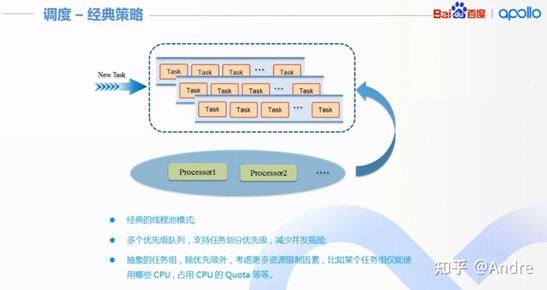

9   CyberRT调度策略
9.1   调度

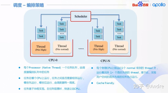

   将调度、任务从内核空间放到了用户空间,在原生的thread上加了一层协程(Coroutine),Cyber RT主要调度的就是协程。
9.2   编排
调度编排策略,很好的结合了业务逻辑、数据共享和算力的平衡。并且任务不会在不同CPU上随机的调度来调度去,具有非常好的Cache友好性。通过多队列减少并发瓶颈,并且集成了一些独占的策略
9.3   协程
协程,即线程更上一层的载体,Cyber RT调度器调度有状态的协程在各个线程上运行。协程不仅切换快,而且调度有着高确定性,不像线程的调度完全依赖操作系统
