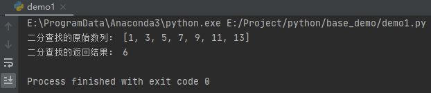

if __name__ == "__main__":
    my_list = [1, 3, 5, 7, 9, 11, 13]
    print("二分查找的原始数列:", my_list)
    print("二分查找的返回结果:", Interpolation_search(my_list, 13))
运行之后,效果如下:
最终效果
