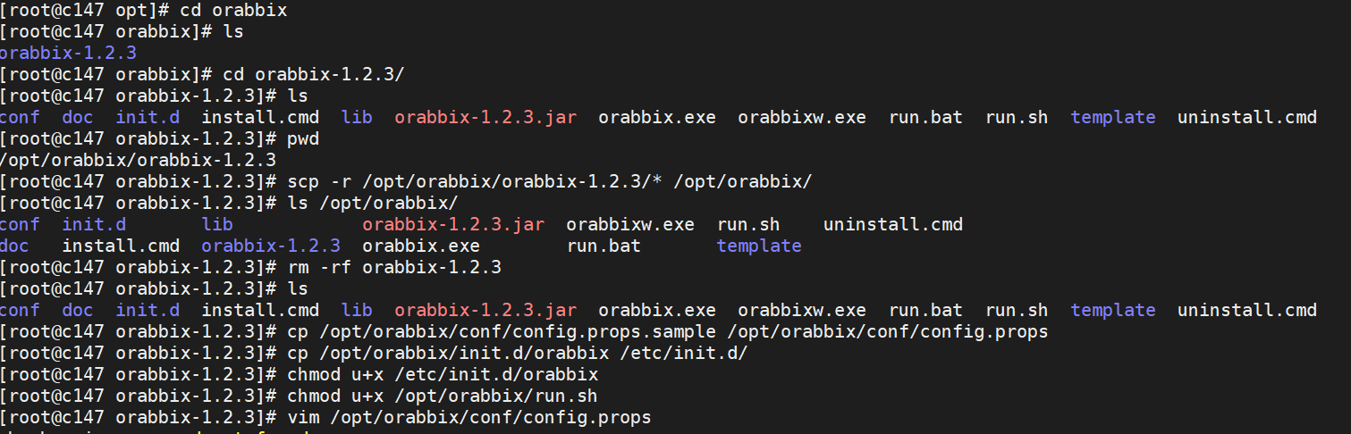

#将orabbix-1.2.3.zip上传至/opt/
unzip -o orabbix-1.2.3.zip -d /opt/orabbix/
cd orabbix
cd orabbix-1.2.3/
scp -r /opt/orabbix/orabbix-1.2.3/* /opt/orabbix/
ls /opt/orabbix/
rm -rf orabbix-1.2.3
#拷贝orabbix模板配置文件
cp /opt/orabbix/conf/config.props.sample /opt/orabbix/conf/config.props
#拷贝orabbix启动文件并授权
cp /opt/orabbix/init.d/orabbix /etc/init.d/
chmod u+x /etc/init.d/orabbix
chmod u+x /opt/orabbix/run.sh

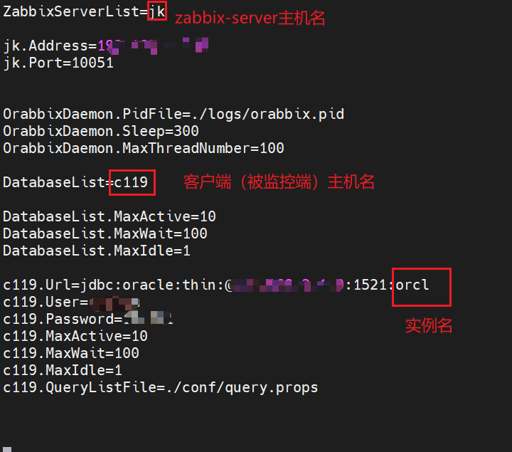

#查看config.props文件路径,并编辑,配置如下图
vim /opt/orabbix/conf/config.props

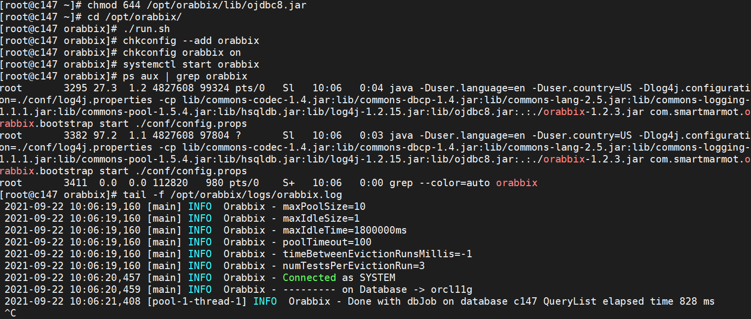

#给ojdbc8.jar授权
chmod 644 /opt/orabbix/lib/ojdbc8.jar
#切换到orabbix目录下
cd /opt/orabbix/
#运行./run.sh
./run.sh
# 加入开机启动
chkconfig --add orabbix
# 验证开机启动项
chkconfig orabbix on
# 启动orabbix
systemctl start orabbix
# 验证orabbix是否启动
ps aux | grep orabbix
# 检查orabbix日志是否报错,如下图,说明没有报错,有报错就处理报错即可
tail -f /opt/orabbix/logs/orabbix.log

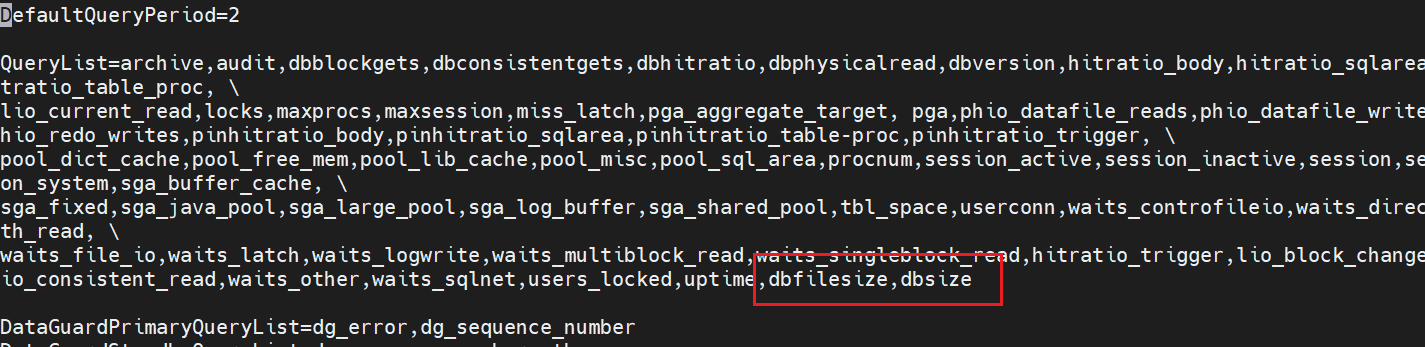

#由于无法监控到数据库大小所以进入该文件,进行添加一些语句,QueryList=类目下增加dbfilesize,dbsize
vim /opt/orabbix/conf/query.props
#添加内容如下
dbfilesize,dbsize

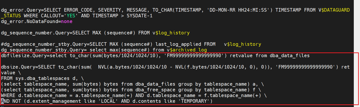

#在最后添加如下内容
dbfilesize.Query=select to_char(sum(bytes/1024/1024/10), 'FM99999999999999990') retvalue from dba_data_files
dbsize.Query=SELECT to_char(sum(  NVL(a.bytes/1024/1024/10 - NVL(f.bytes/1024/1024/10, 0), 0)), 'FM99999999999999990') retvalue \
FROM sys.dba_tablespaces d, \
(select tablespace_name, sum(bytes) bytes from dba_data_files group by tablespace_name) a, \
(select tablespace_name, sum(bytes) bytes from dba_free_space group by tablespace_name) f \
WHERE d.tablespace_name = a.tablespace_name(+) AND d.tablespace_name = f.tablespace_name(+) \
AND NOT (d.extent_management like 'LOCAL' AND d.contents like 'TEMPORARY')
