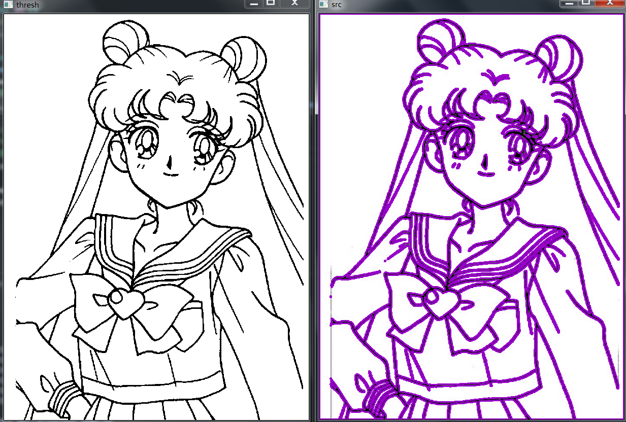

测试代码与运行结果如下:
import cv2 as cv
# help(cv.drawContours)
src = cv.imread("./both.jpeg")
gray = cv.cvtColor(src, cv.COLOR_BGR2GRAY)
ret, thresh = cv.threshold(gray, 150, 255, 0)
cv.imshow("thresh",thresh)
# 寻找轮廓
contours, hierarchy = cv.findContours(thresh, cv.RETR_TREE, cv.CHAIN_APPROX_SIMPLE)
# print(contours)
# print(hierarchy)
# 绘制轮廓
cv.drawContours(src,contours,-1,(200,0,150),2)
cv.imshow('src',src)
cv.waitKey(0)
