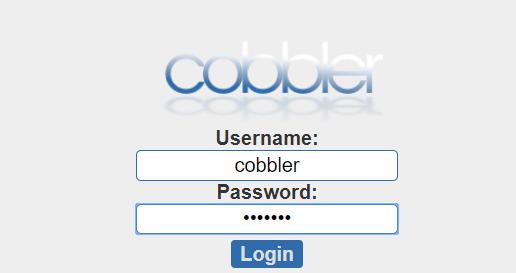

设置 Cobbler Web访问的密码
# sudo htdigest /etc/cobbler/users.digest "Cobbler" admin
Adding user admin in realm Cobbler
New password:
Re-type new password:
