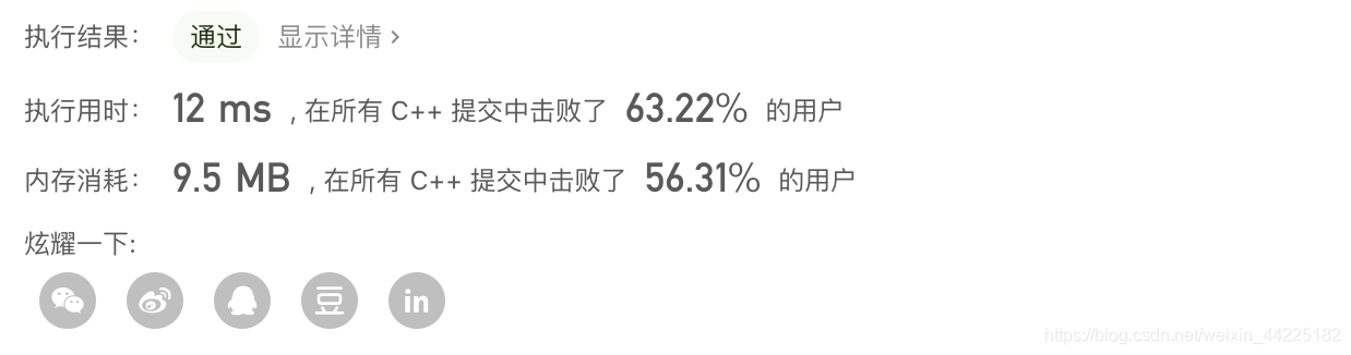

提交代码(双哈希)
vector<int> twoSum(vector<int>& numbers, int target) { unordered_map<int,int> m; for(int i=0;i<numbers.size();++i) { m[numbers[i]]=i; } vector<int> result; for(int i=0;i<numbers.size();++i) { if(m.find(target-numbers[i])!=m.end()) { result.push_back(i+1); result.push_back(m[target-numbers[i]]+1); break; } } return result; }

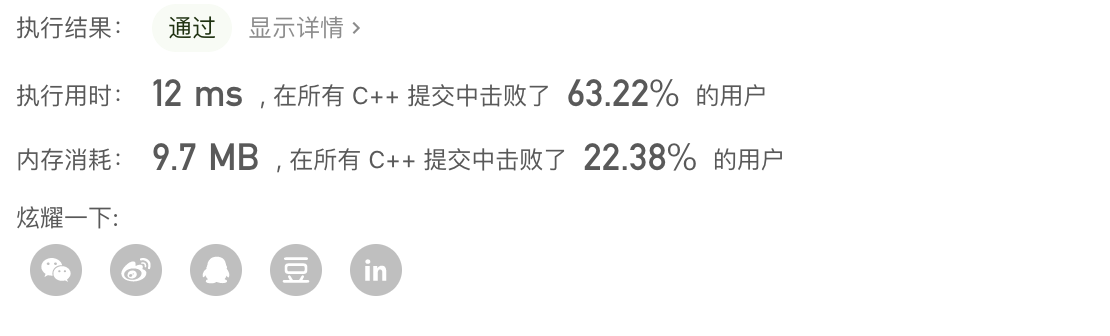

提交代码(一次哈希)
vector<int> twoSum(vector<int>& numbers, int target) { unordered_map<int,int> m; for(int i=0;i<numbers.size();++i) { int temp=target-numbers[i]; if(m.find(temp)!=m.end()) return {m[temp]+1,i+1}; m[numbers[i]]=i; } return {}; }

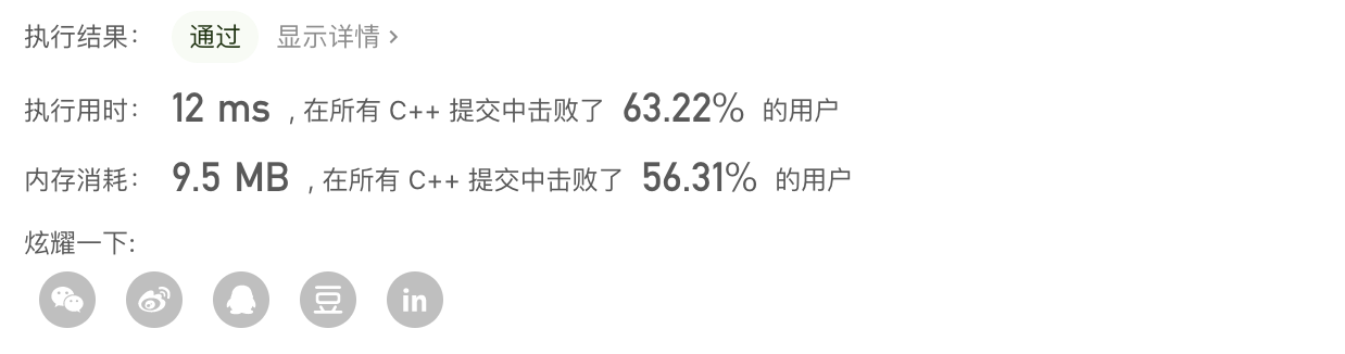

提交代码(二分法)
 vector<int> twoSum(vector<int>& numbers, int target) { int len=numbers.size(); for(int i=0;i<len-1;++i) { int left=i+1; int right=len-1; while(left<=right) { int mid=left+(right-left)/2; if(numbers[mid]>(target-numbers[i])) right=mid-1; else if(numbers[mid]==(target-numbers[i])) return {i+1,mid+1}; else left=mid+1; } } return {}; }

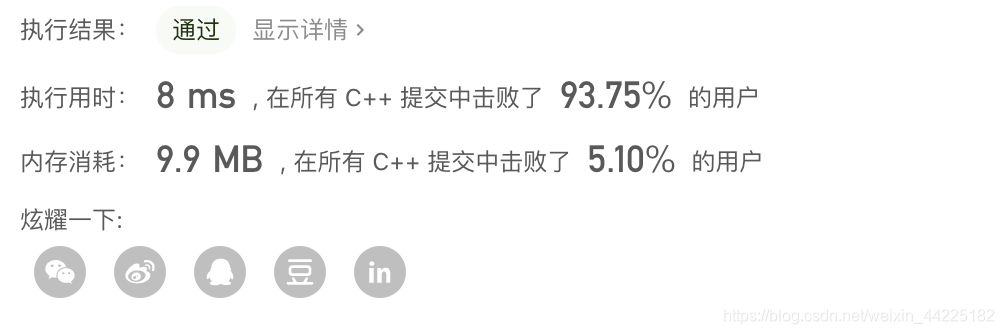

提交代码(双指针)
 vector<int> twoSum(vector<int>& numbers, int target) { int left=0; int right=numbers.size()-1; int temp; while(left<right) { temp=numbers[left]+numbers[right]; if(temp==target) return {left+1,right+1}; else if(temp>target) --right; else ++left; } return {}; }
