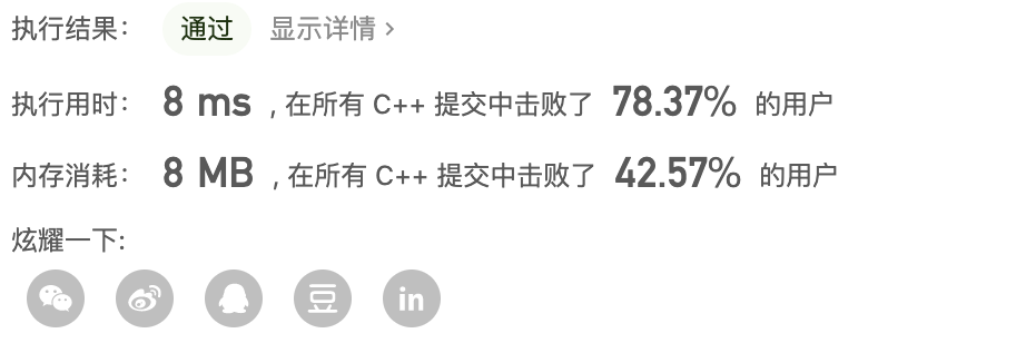

解答 By 海轰
提交代码
vector<string> fizzBuzz(int n) { vector<string> res; for(int i=1;i<=n;++i) { if(i%3==0&&i%5!=0) res.push_back("Fizz"); else if(i%3!=0&&i%5==0) res.push_back("Buzz"); else if(i%3==0&&i%5==0) res.push_back("FizzBuzz"); else res.push_back(to_string(i)); } return res; }
  • 1
  • 2
  • 3
  • 4
  • 5
  • 6
  • 7
  • 8
  • 9
  • 10
  • 11
  • 12
  • 13
  • 14
  • 15
运行结果

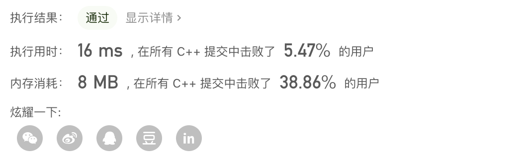

提交代码
vector<string> fizzBuzz(int n) { vector<string> res; for(int i=1;i<=n;++i) { string temp; if(i%3==0) temp+="Fizz"; if(i%5==0) temp+="Buzz"; if(temp=="") temp=to_string(i); res.push_back(temp); } return res; }
  • 1
  • 2
  • 3
  • 4
  • 5
  • 6
  • 7
  • 8
  • 9
  • 10
  • 11
  • 12
  • 13
  • 14
  • 15
运行结果

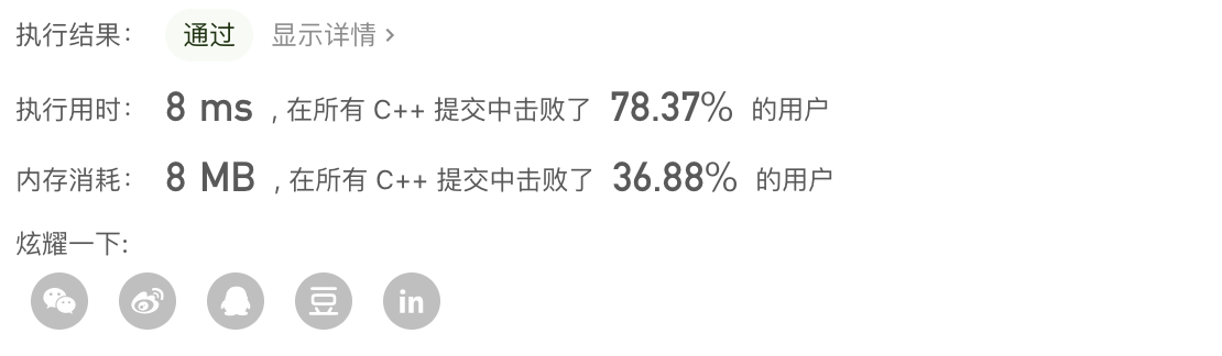

解答
Demo
vector<string> fizzBuzz(int n) { vector<string> ans; //Hash map to store all fizzbuzz mappings. map<int, string> fizzBuzzDict = { {3, "Fizz"}, {5, "Buzz"} }; for (int num = 1; num <= n; ++num) { string numAnsStr = ""; for (auto key : fizzBuzzDict) { //If the num is divisible by key, //then add the corressponding string mapping to current numAnsStr if (num % key.first == 0) numAnsStr += key.second; } //Not divisible by 3 or 5, add the number if (numAnsStr == "") numAnsStr += to_string(num); // Append the current answer str to the ans list ans.push_back(numAnsStr); } return ans; }
  • 1
  • 2
  • 3
  • 4
  • 5
  • 6
  • 7
  • 8
  • 9
  • 10
  • 11
  • 12
  • 13
  • 14
  • 15
  • 16
  • 17
  • 18
  • 19
  • 20
  • 21
  • 22
  • 23
  • 24
  • 25
  • 26
  • 27
  • 28
运行结果
