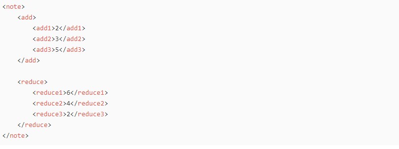

1. 读取xml文件
先学习xml
2、创建xml文件
3. 读取xml文件
from xml.dom import minidom
class Readxml():
    def read_xml(self,filename,onename,twoname):
        root =minidom.parse(filename)
        firstnode =root.getElementsByTagName(onename)[0]
        secondnode=firstnode.getElementsByTagName(twoname)[0].firstChild.data
        return secondnode

具体使用
import unittest
from dev.Caculate import Caculate
from readdata.readxmldata import Readxml
c = Caculate()
r = Readxml()
a1 = r.read_xml('../data/xmltestdata.xml', 'add', 'add1')
a2 = r.read_xml('../data/xmltestdata.xml', 'add', 'add2')
a3 = r.read_xml('../data/xmltestdata.xml', 'add', 'add3')
r1 = r.read_xml('../data/xmltestdata.xml', 'reduce', 'reduce1')
r2 = r.read_xml('../data/xmltestdata.xml', 'reduce', 'reduce2')
r3 = r.read_xml('../data/xmltestdata.xml', 'reduce', 'reduce3')
class UnitTestTwo(unittest.TestCase):
    def setUp(self) -> None:
        print("开始")
    def test001(self):
        sum = c.add(int(a1), int(a2))
        self.assertEqual(sum, int(a3))
    def test002(self):
        dif = c.reduce(int(r1), int(r2))
        self.assertEqual(dif, int(r3))
