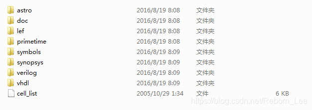

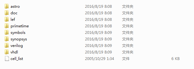

1. 了解目录结构:与前端相关的比如文档(doc),仿真模型(verilog/vhdl),标准单元库(synopsys/symbols)
1. 了解目录结构:与前端相关的比如文档(doc),仿真模型(verilog/vhdl),标准单元库(synopsys/symbols)。这是针对s家的模型,如果使用c家的综合工具就不能用了,所以这个库不全。
参考地址:https://t.zsxq.com/JaqzjqR
每一个/aci路径下面包含了astro(),doc(文档资料),lef(),primetime(),symbols(标准单元库),synopsys(标准单元库),verilog(仿真模型),vhdl(仿真模型)等文件夹。

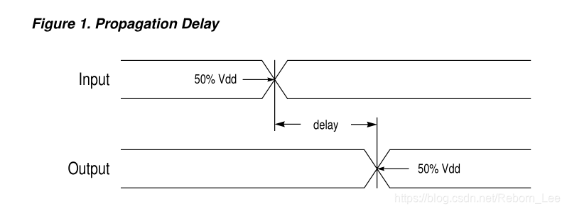

propagation delay:
The propagation delay through a cell is the sum of the intrinsic delay, the load-dependent delay, and the input-slew dependent delay. Delays are defined as the time interval between the input stimulus crossing 50% of Vdd and the output crossing 50% of Vdd.Figure 1 illustrates the propagation delay.

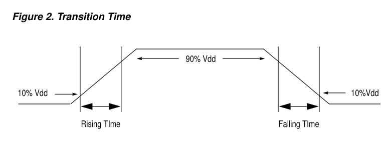

transition time:
The transition times (slews) on input and output pins are defined as the time interval between the signal crossing 10% of Vdd and 90% of Vdd. Figure 2 illustrates transition time measurements for rising and falling signals.
给出别人的答案:
transtion delay time, 分为rising time和falling time。rising time是指从10%的Vdd到90%的Vdd的时间,falling time是指从Vdd 90%到10%的时间。 propagation delay,顾名思义是传播延迟,就是输入的电平变到50%Vdd起开始计时,到输出电平变到50%Vdd为止所需要的时间。这些参数都在时序约束当中起到重要的作用。
