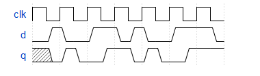

You're familiar with flip-flops that are triggered on the positive edge of the clock, or negative edge of the clock. A dual-edge triggered flip-flop is triggered on both edges of the clock. However, FPGAs don't have dual-edge triggered flip-flops, and always @(posedge clk or negedge clk) is not accepted as a legal sensitivity list.
Build a circuit that functionally behaves like a dual-edge triggered flip-flop:
(Note: It's not necessarily perfectly equivalent: The output of flip-flops have no glitches, but a larger combinational circuit that emulates this behaviour might. But we'll ignore this detail here.)
审题
(注意:它不一定完全等效:触发器的输出没有毛刺,但是可以模仿这种行为的较大的组合电路。但是在这里我们将忽略此细节。)
上面注意的意思是可以接受毛刺。
