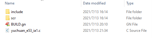

首先调用 InitE53IA1()  函数初始化E53_IA1所接的引脚的功能,然后循环调用 ReadDataE53IA1() 函数读取温度 、湿度、光照强度并通过串口打印出来,当光照强度过低时,开启补光灯补光,当温度 、湿度超标时开启电机通风。
yuchuan_e53_ia1.c

编译调试
//applications/sample/BearPi/BearPi-HM_Nano/sample/C2_YuchuanE53IA1
static_library("yuchuanE53IA1"){
    sources = [
        "scr/e53_ia1.c",
        "yuchuan_e53_ia1.c",
    include_dirs = [
        "//utils/native/lite/include",
        "//kernel/liteos_m/kal/cmsis",
        "//base/iot_hardware/peripheral/interfaces/kits",
        "include",
修改 BUILD.gn 文件
