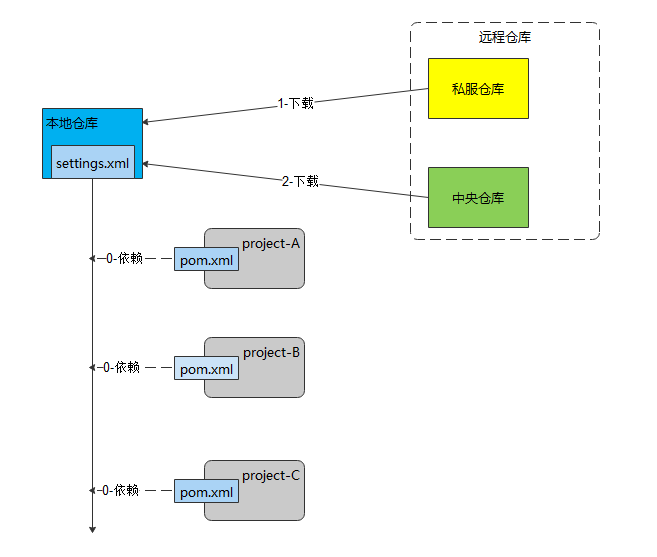

maven仓库依赖大概访问顺序:本地仓库(local)--> 远程仓库(私服) --> 远程仓库(中央仓库)
依赖具体访问顺序:local_repo --> settings_profile_repo($Maven_HOME/conf/settings > $User_home/conf/settings) -->pom_repostitorues(多个仓库按声明倒序) --> settings_mirrors --> central
三者的关系:
