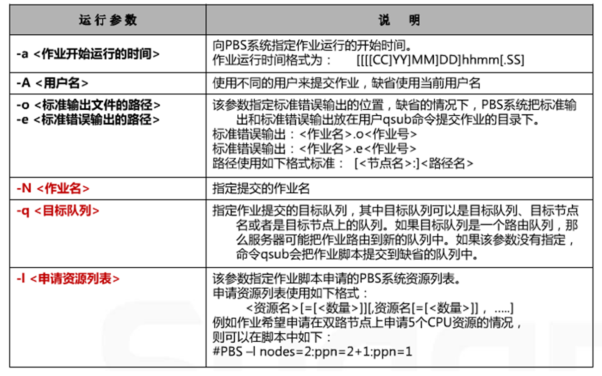

这个PBS脚本是标准的 Unix/Linux shell 脚本,在最开始的地方包含了一些看似额外的注解行。 这些注解行都是以#PBS开头,定义了PBS的一些指示符。最重要的一些PBS指示 参见下表:
#PBS -l walltime=HH:MM:SS
This directive specifies the maximum walltime (real time, not CPU time) that a job should take. If this limit is exceeded, PBS will stop the job. Keeping this limit close to the actual expected time of a job can allow a job to start more quickly than if the maximum walltime is always requested.
#PBS -l pmem=SIZEgb
This directive specifies the maximum amount of physical memory used by any process in the job. For example, if the job would run four processes and each would use up to 2 GB (gigabytes) of memory, then the directive would read #PBS -l pmem=2gb. The default for this directive on Lion-XF and Lion-LSP is 1 GB (gigabyte) of memory. Other Lion clusters do not currently set a default.
#PBS -l nodes=N:ppn=M
This specifies the number of nodes (nodes=N) and the number of processors per node (ppn=M) that the job should use. PBS treats a processor core as a processor, so a system with eight cores per compute node can have ppn=8 as its maximum ppn request. Note that unless a job has some inherent parallelism of its own through something like MPI or OpenMP, requesting more than a single processor on a single node is usually wasteful and can impact the job start time.
#PBS -q queuename
This specifies what PBS queue a job should be submitted to. This is only necessary if a user has access to a special queue. This option can and should be omitted for jobs being submitted to a system's default queue.
#PBS -j oe
Normally when a command runs it prints its output to the screen. This output is often normal output and error output. This directive tells PBS to put both normal output and error output into the same output file.

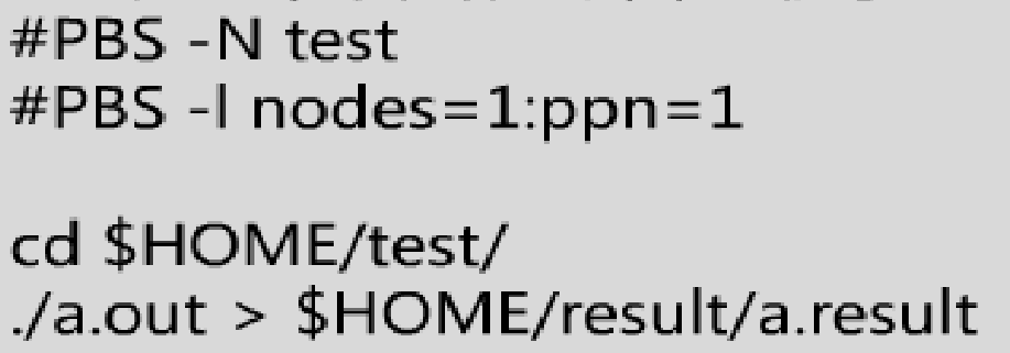

串行任务脚本:

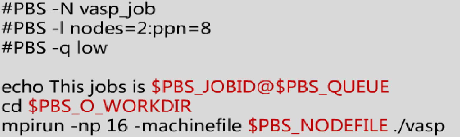

并行任务脚本:

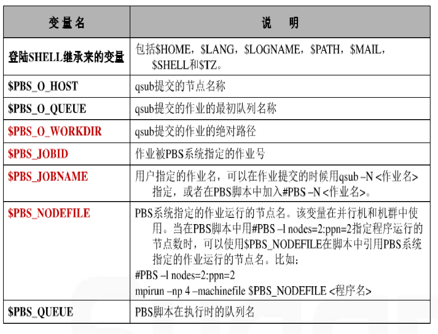

其中变量说明如下:

5、脚本中运行参数补充:
当另一作业完成后运行,#PBS -W depend=after:作业号;
