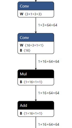

关于node的改写有时需要已知其输入输出size,故一开始先准备一个包含每个node输入输出的onnx模型。
import onnx.helper as helper from onnx import shape_inference, TensorProto import onnxruntime import onnx def add_input_output_from_onnx(onnx_path, save_path): ONNX_DTYPE = { 0: TensorProto.FLOAT, 1: TensorProto.FLOAT, 2: TensorProto.UINT8, 3: TensorProto.INT8, 4: TensorProto.UINT16, 5: TensorProto.INT16, 6: TensorProto.INT32, 7: TensorProto.INT64, 8: TensorProto.STRING, 9: TensorProto.BOOL } # load model onnx_model = onnx.load(onnx_path) graph = onnx_model.graph # rewrite the input tensor of graph input_tensor = graph.input[0] input_shape = input_tensor.type.tensor_type.shape.dim input_tensor_new = onnx.helper.make_tensor_value_info(name = input_tensor.name, elem_type = 1, shape = [1, input_shape[1].dim_value, input_shape[2].dim_value, input_shape[3].dim_value]) graph.input.remove(input_tensor) graph.input.insert(0, input_tensor_new) # append all tensor infos to graph input weight_infos = [] tensors = graph.initializer for i, tensor in enumerate(tensors): value_info = helper.make_tensor_value_info(tensor.name, ONNX_DTYPE[tensor.data_type], tensor.dims) weight_infos.append(value_info) graph.input.insert(i+1, value_info) # because 0 is for placeholder, so start index is 1 # run node shape inference node = graph.node value_info = graph.value_info inferred_onnx_model = shape_inference.infer_shapes(onnx_model) onnx.checker.check_model(onnx_model) inferred_graph = inferred_onnx_model.graph inferred_value_info = inferred_graph.value_info onnx.save(inferred_onnx_model,save_path) return使用netron打开onnx模型,查看添加size之后的变化:
遇到caffe与NNIE不支持的算子,删除onnx模型中的node,将相关操作在外部的预处理阶段进行。这种情况只涉及onnx模型中已经存在的节点删除与改变已有边连接的关系,不涉及新的边关系的建立。
` 这里使用graph中node的index来访问node 该代码删除graph node 0,1,2 并且修改node 3的input边 即 input_image --> mul_1 --> sub --> mul --> conv1 变为 input_image --> conv1 ` def delete_node(onnx_path, save_path): onnx_model = onnx.load(onnx_path) graph = onnx_model.graph Mul_1 = graph.node[0] sub = graph.node[1] mul = graph.node[2] conv1 = graph.node[3] conv1.input[0] = Mul_1.input[0] graph.node.remove(Mul_1) graph.node.remove(sub) graph.node.remove(mul) onnx.checker.check_model(onnx_model) onnx.save(onnx_model, save_path) -
更改caffe与NNIE不支持的算子,修改onnx模型中的node去适配。如 squeeze 算子,squeeze算子在onnx->caffe的时候会报错,这时可以将onnx模型中的squeeze替换为reshape算子。reshape需要两个输入,而squeeze只对应一个输入,这时需要在graph中创建一个新的常数tensor input。这种情况涉及更换已经存在的node,新的常数tensor的加入,但并不涉及新的边关系的建立。

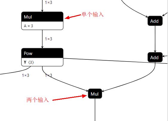

caffe和NNIE都支持某个操作,onnx2caffe也支持该操作,但是操作中有一个输入在模型中被写为weight,与原来的实现不一致。
如: mul算子,普通的mul算子一般都包含两个输入,模型中可能会存在mul算子只有一个输入,另一个输入作为weight参数,如下所示:
这种情况下,由于已经存在了mul的注册算子,我们只需要在mul算子转换的时候新加一个分支来实现就可以了,还是只涉及两个文件的改写。
_operators.py 添加分支代码def _convert_input1_is_weight_mul(node,graph,max_dim, err): node_name = node.name `这里的input_name需要在netron视图中观察一下是哪一个input作为外部输入,这里不能写 weight 的输入名称!` input_name = str(node.inputs[0]) output_name = str(node.outputs[0]) scale_layer = myf("Scale", node_name, [input_name],[output_name],in_place=False,bias_term=False) graph.channel_dims[output_name] = max_dim return scale_layer def _convert_Mul(node,graph,err): input_name_list = [str(i) for i in node.inputs] output_name = str(node.outputs[0]) node_name = node.name `这里使用node_name 判断mul算子是否是一个input,新增只有一个input的分支` if node_name == "mul_1": max_dim = 16 return _convert_input1_is_weight_mul(node,graph,max_dim, err) ··· ···_weightloader.py 也不需要重新注册,直接添加分支代码
def _convert_input1_is_weight_mul(net, node, graph, err): node_name = node.name ` 注意!! scale = np.ones(3) * 3.0 对应的是 外部输入size =(1,3), weight size = (1), 这种情况可以借助 numpy 实现weight与外部输入的channel对齐 这里还有另外一种情况,例如 外部输入 size = (1,128,8,8), weight = (1,128,1,1) 可以这样操作:scale = node.input_tensors[node.inputs[1]] scale = np.reshape(scale, scale.shape[1]) ` scale = np.ones(3) * 3.0 np.copyto(net.params[node_name][0].data, scale, casting='same_kind') `mul本身是没有weight的,所以之前就是直接pass` def _convert_Mul(net, node, graph, err): node_name = node.name if node_name == "mul_1": _convert_input1_is_weight_mul(net, node, graph, err) else: pass实际转换过程中,add算子也会出现上面的情况,其中有一个输入作为算子参数,这时可以把其类比到 _convert_BatchNorm 中的scale操作,将scale的weight视为1,bias为add算子的内部输入参数,可以参照BatchNorm修改代码,这里就不详细写了。

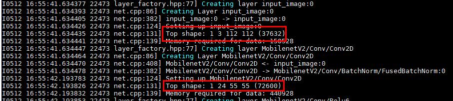

转换过程中算子转换成功,但是出现了shape问题,手动修改prototxt
上面介绍的是算子的适配,但有时通过onnx2caffe转换代码之后,已经生成了prototxt文件,最终报错 feature map 的 shape 不匹配,由于onnx2caffe工具在转换的时候就打印出了每一层的output,通过与netron视图对比,定位第一个出现问题的node。
知己知彼方能百战百胜,为了定位shape为什么不一致,我们先要了解一下不同框架的padding策略以及相应的output size的计算方法。
- 查看caffe的output size计算方式,根据代码可得:
output_size=floor((w+2*pad-(d(k-1)+1))/s)+1template <typename Dtype> void ConvolutionLayer<Dtype>::compute_output_shape() { const int* kernel_shape_data = this->kernel_shape_.cpu_data(); const int* stride_data = this->stride_.cpu_data(); const int* pad_data = this->pad_.cpu_data(); const int* dilation_data = this->dilation_.cpu_data(); this->output_shape_.clear(); for (int i = 0; i < this->num_spatial_axes_; ++i) { // i + 1 to skip channel axis const int input_dim = this->input_shape(i + 1); const int kernel_extent = dilation_data[i] * (kernel_shape_data[i] - 1) + 1; const int output_dim = (input_dim + 2 * pad_data[i] - kernel_extent)/ stride_data[i] + 1; this->output_shape_.push_back(output_dim); } } - tensorflow的padding策略可根据这篇博客,结合上面caffe的output size计算,感觉caffe的 conv padding 策略与tensorflow pad=VALID一致,会把不能参与的pixel自动去除不进行计算。
好了,了解了不同框架的padding策略以及output size的计算方式之后,我们来分析我们的模型,模型转换是这样的:
| 框架 | input shape | conv param | output shape |
| tensorflow | 1,3,112,112 | dilations: 1,stride:2,kernel size:3, pad: SAME | 1,24,56,56 |
| onnx | 1,3,112,112 | dilations: 1,stride:2,kernel size:3, pad: [0,0,1,1] | 1,24,56,56 |
| caffe | 1,3,112,112 | dilations: 1,stride:2,kernel size:3, pad_h: 0, pad_w: 0 | 1,24,55,55 |
分析上面模型转换的表格参数:
- tensorflow pad=SAME,为了使所有的input pixel都参与计算,tensorflow在推理时偷偷在input的右下补了一行0,这样最后的输出:
output size = (112 - (1 * (3 - 1) + 1) + 1) / 2 + 1 = 56
其中 (112 - (1 * (3 - 1) + 1) + 1) 斜体1表示偷偷补的0。 - 对于onnx, 经过查询与实验,发现 pads 参数[0,0,1,1]表示 feature map 上面不补,左边不补,下面补一行 0,右边补一列,与tf一致,输出没有什么问题。
- 转为caffe之后,caffe模型 conv pad 参数都为0,上下左右都不补,这时根据caffe的outputshape公式,最终计算结果为(1,3,55,55),直接去除input的最后一行和最后一列不参与计算。
为了使输出shape一致,并且计算结果相同,我采用了下面的解决方法。
caffe中设置 pad_h:2, pad_w:2。 由于caffe是设置pad参数之后是对称补0的,即input的上下左右都补了两行或者两列0,这时结合output_shape公式,最终输出的shape为:
output_shape = floor((112 + 2 * 2 - (1 * (3 - 1) + 1) + 1) / 2) + 1 = 57
思考一下conv原理,就知道此时caffe得到的feature map 只是比tf的多了最上面一行和最左边一列。稍微解释一下,虽然caffe设置pad=2,但是根据caffe的conv实现,会将右下比tf多补的那一行和那一列自动去除,不参与运算。
这时feature map输出为(1,3,57,57), 为了得到正确结果,在prototxt文件的conv算子之后添加两个slice操作,去除最上面一行与最左边一列。
