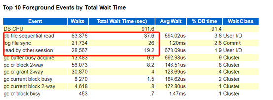

查看awr报告
等待事件为
db file sequential read
log file sync
read by other session

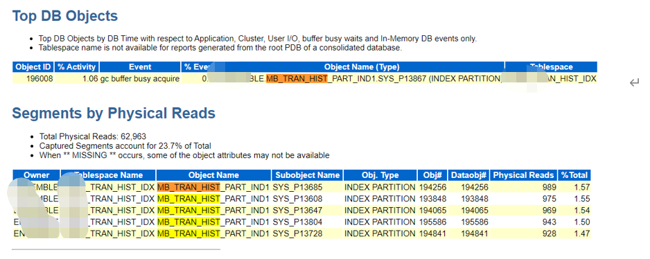

继续查看awr报告,发现热点都在索引上。
查看下索引状态都正常
select * from dba_indexes where table_name = 'MB_TRAN_HIST'
select * from dba_part_indexes where table_name = 'MB_TRAN_HIST'
select * from dba_ind_partitions where index_name = 'MB_TRAN_HIST_PART_IND1'

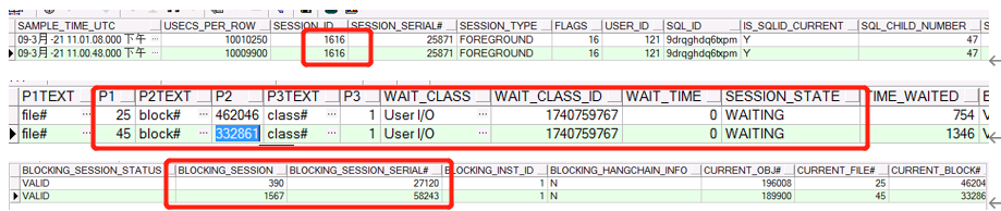

select * from dba_hist_active_sess_history where   SAMPLE_TIME BETWEEN
TO_DATE('2021-3-10 6:55:00', 'YYYY-MM-DD HH24:MI:SS') AND
TO_DATE('2021-3-10 7:05:00', 'YYYY-MM-DD HH24:MI:SS')  and program = 'JDBC Thin Client' and sql_id = '9drqghdq6txpm'
定位到存在等待事件read by other session

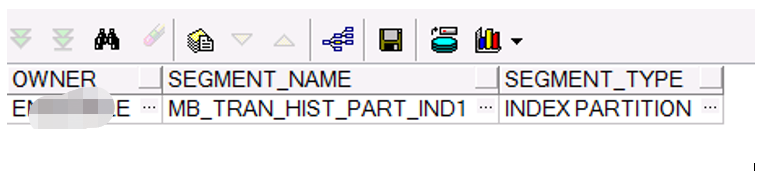

热点块
SELECT relative_fno, owner, segment_name, segment_type
  FROM dba_extents
 WHERE file_id = 45
   AND 332861 BETWEEN block_id AND block_id + blocks - 1;
和上边awr一致。
blocking session
blocking session为'390','1567',查询发现在7点时有不到20个session进来查询。
