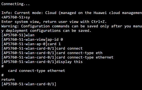

1.Configuring the Card Connection Type
cmds
>Sys
>Wlan
>ap-id 0
>card 1
>card connect-type Ethernet

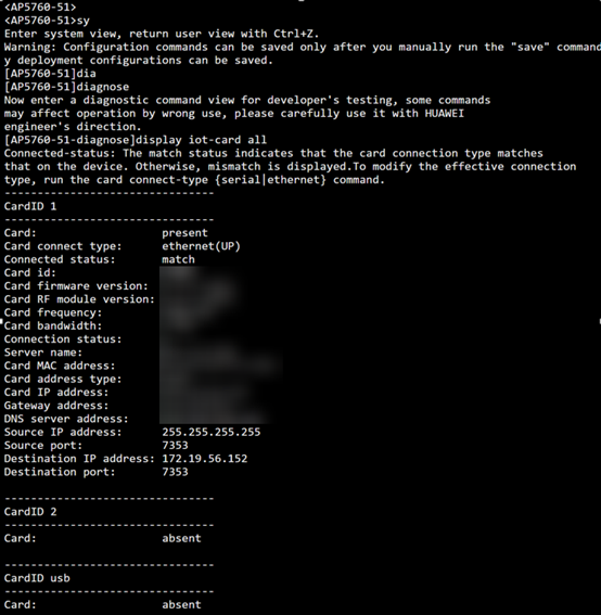

2. Query card information.
>Sys
>diagnose
>display iot-card all

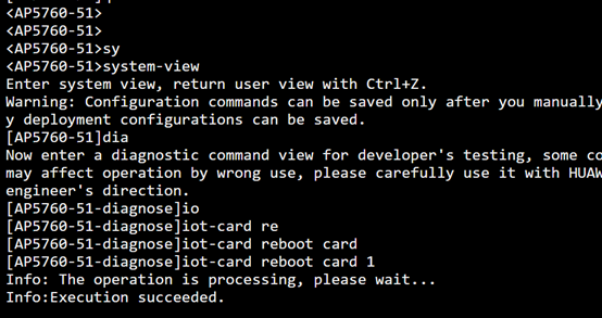

3. Reboot the card.
>Sys
>diagnose
>iot-card reboot card 1

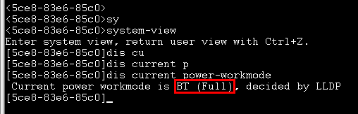

FAQ:
1.When the AP is running properly, but the card is absent.
Check the current poe-power of AP. The AirEngine series APs can supply power to the card only when they are in AT or BT state.
