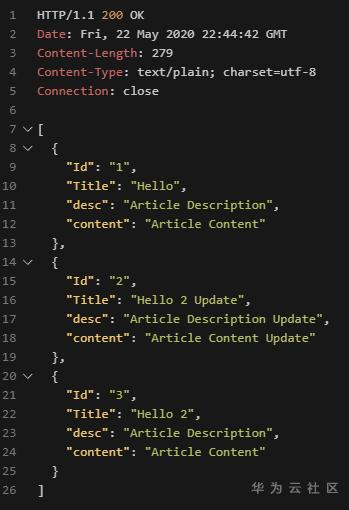

7.4    创建后端服务
接下来我写一个例子创建REST API后端服务:
我们的服务提供如下的API:
GET http://localhost:10000/
GET http://localhost:10000/all
GET http://localhost:10000/article/1
POST http://localhost:10000/article HTTP/1.1
    "Id": "3",
    "Title": "Hello 2",
    "desc": "Article Description",
    "content": "Article Content"
PUT http://localhost:10000/article HTTP/1.1
    "Id": "2",

调用添加,更新API以后返回所有数据的测试结果:
