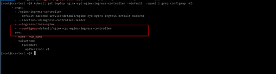

查看configmap的配置注入信息
命令:kubectl get deploy nginx-cyd-nginx-ingress-controller –ndefault –oyaml | grep configmap –C5
可以看到默认的nginx-ingress controller对应的configmap配置(controller的服务名)

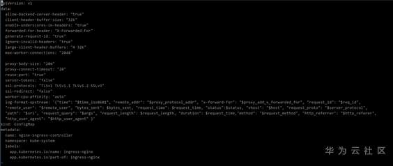

示例如下:

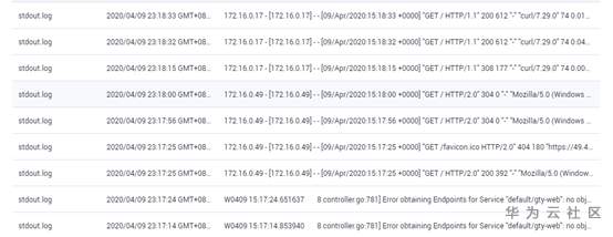

配置之前的nginx-controller的日志格式,及输出如下:
配置之后nginx-controller的日志格式,及输出如下:
日志格式已经修改成功,并成功打印
注:
如果controller日志中出现如下图的错误,是正常的,因为重启了controller,而已经下发过ingress的服务了,会出现短暂的后端服务找不到,后面重启会自动恢复。
常用配置如下:
apiVersion: v1
data:
  allow-backend-server-header: "true"
  client-header-buffer-size: "32k"
  enable-underscores-in-headers: "true"
  forwarded-for-header: "X-Forwarded-For"
  generate-request-id: "true"
  ignore-invalid-headers: "true"
  large-client-header-buffers: "4 32k"
  proxy-body-size: "20m"
  proxy-connect-timeout: "20"
  reuse-port: "true"
  server-tokens: "false"
  ssl-protocols: "TLSv1 TLSv1.1 TLSv1.2 SSLv3"
  ssl-redirect: "false"
  worker-cpu-affinity: "auto"
  log-format-upstream: '{"time": "$time_iso8601", "remote_addr": "$proxy_protocol_addr", "x-forward-for": "$proxy_add_x_forwarded_for", "request_id": "$req_id",
  "remote_user": "$remote_user", "bytes_sent": $bytes_sent, "request_time": $request_time, "status":$status, "vhost": "$host", "request_proto": "$server_protocol",
  "path": "$uri", "request_query": "$args", "request_length": $request_length, "duration": $request_time,"method": "$request_method", "http_referrer": "$http_referer",
  "http_user_agent": "$http_user_agent" }'
kind: ConfigMap
metadata:
  namespace: kube-system
  labels:
    app.kubernetes.io/name: ingress-nginx
    app.kubernetes.io/part-of: ingress-nginx
