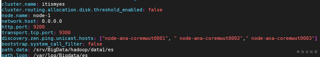

vim elasticsearch-6.2.3/config/elasticsearch.yml(严格遵守yml文件的格式),添加以下内容:
cluster.name: itismyes
cluster.routing.allocation.disk.threshold_enabled: false
node.name: node-1
network.host: 0.0.0.0
http.port: 9200
transport.tcp.port: 9300
discovery.zen.ping.unicast.hosts: ["node-ana-coremwut0001", " node-ana-coremwut0002"," node-ana-coremwut0003"]
bootstrap.system_call_filter: false
path.data: /srv/BigData/hadoop/data1/es
path.logs: /var/log/Bigdata/es

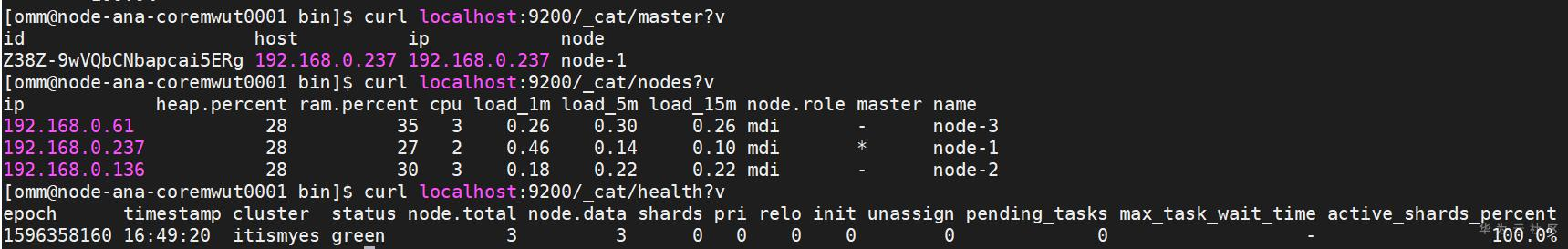

4.      可以在分析节点使用一下命令查看集群状态
curl localhost:9200/_cat/master?v
curl localhost:9200/_cat/nodes?v
curl localhost:9200/_cat/health?v

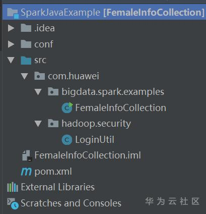

3.      将huaweicloud-mrs-example-mrs-2.0\src\spark-examples\SparkJavaExample样例导入idea

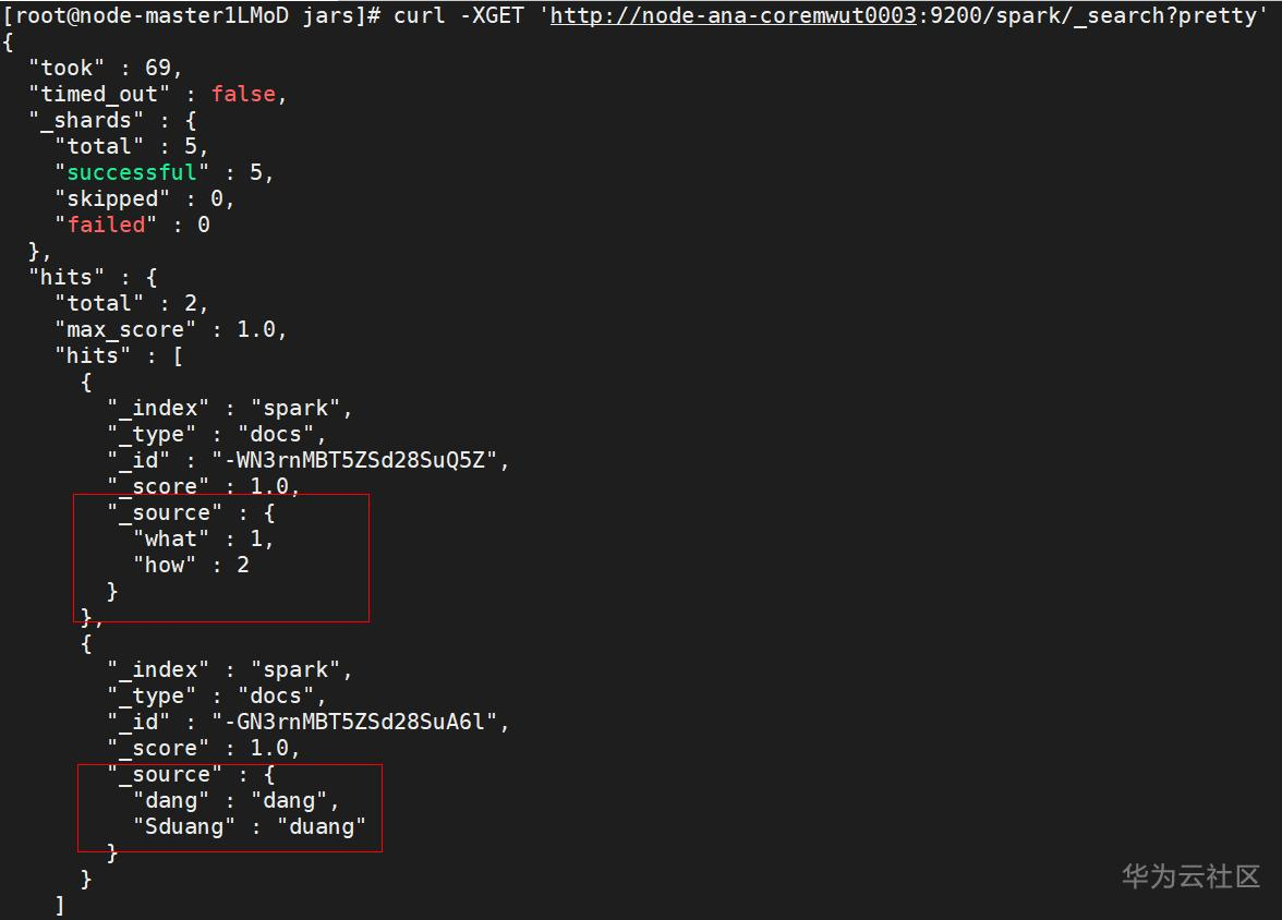

7.      查看结果
curl -XGET 'http://node-ana-coremwut0003:9200/spark/_search?pretty'
