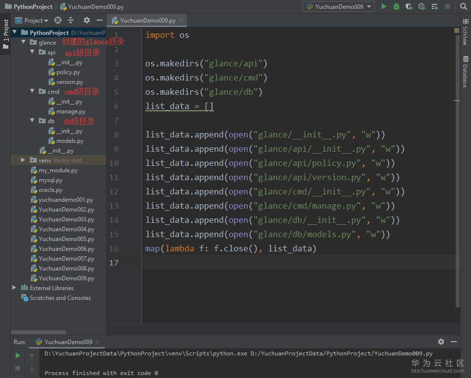

import os
os.makedirs("glance/api")
os.makedirs("glance/cmd")
os.makedirs("glance/db")
list_data = []
list_data.append(open("glance/__init__.py", "w"))
list_data.append(open("glance/api/__init__.py", "w"))
list_data.append(open("glance/api/policy.py", "w"))
list_data.append(open("glance/api/version.py", "w"))
list_data.append(open("glance/cmd/__init__.py", "w"))
list_data.append(open("glance/cmd/manage.py", "w"))
list_data.append(open("glance/db/__init__.py", "w"))
list_data.append(open("glance/db/models.py", "w"))
map(lambda f: f.close(), list_data)

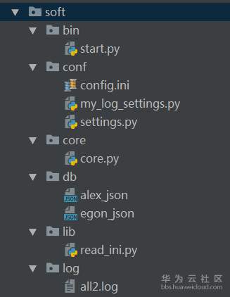

软件开发规范
#=============>bin目录:存放执行脚本
#start.py
import sys,os
BASE_DIR=os.path.dirname(os.path.dirname(os.path.abspath(__file__)))
sys.path.append(BASE_DIR)
from core import core
from conf import my_log_settings
if __name__ == '__main__':
    my_log_settings.load_my_logging_cfg()
    core.run()

#=============>core目录:存放核心逻辑
#core.py
import logging
import time
from conf import settings
from lib import read_ini
config=read_ini.read(settings.config_path)

#=============>db目录:存放数据库文件
#alex_json
#egon_json
#=============>lib目录:存放自定义的模块与包
#read_ini.py
import configparser
def read(config_file):
    config=configparser.ConfigParser()
    config.read(config_file)
    return config
#=============>log目录:存放日志
#all2.log
