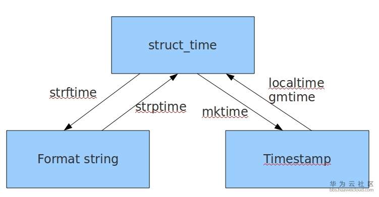

几种格式之间的转换
import time
# 时间戳-->结构化时间
# time.gmtime(时间戳)    #UTC时间,与英国伦敦当地时间一致
# time.localtime(时间戳) #当地时间。例如我们现在在北京执行这个方法:与UTC时间相差8小时,UTC时间+8小时 = 北京时间
time_t = time.time()
time_gm = time.gmtime(time_t)
print(time_gm)
time_loc = time.localtime(time_t)
print(time_loc)
# 结构化时间-->时间戳
# time.mktime(结构化时间)
time.sleep(3)
time_tuple = time.localtime(time.time())
print(time.mktime(time_tuple))
结果:
D:\YuchuanProjectData\PythonProject\venv\Scripts\python.exe D:/YuchuanProjectData/PythonProject/YuchuanDemo006.py
time.struct_time(tm_year=2020, tm_mon=1, tm_mday=17, tm_hour=10, tm_min=22, tm_sec=45, tm_wday=4, tm_yday=17, tm_isdst=0)
time.struct_time(tm_year=2020, tm_mon=1, tm_mday=17, tm_hour=18, tm_min=22, tm_sec=45, tm_wday=4, tm_yday=17, tm_isdst=0)
1579256568.0
Process finished with exit code 0
import time
# 结构化时间-->字符串时间
# time.strftime("格式定义","结构化时间")  结构化时间参数若不传,则显示当前时间
print(time.strftime("%Y-%m-%d %X"))
print(time.strftime("%Y-%m-%d", time.localtime(1600000000)))
# 字符串时间-->结构化时间
# time.strptime(时间字符串,字符串对应格式)
print(time.strptime("2020-01-17", "%Y-%m-%d"))
print(time.strptime("01/17/2020", "%m/%d/%Y"))

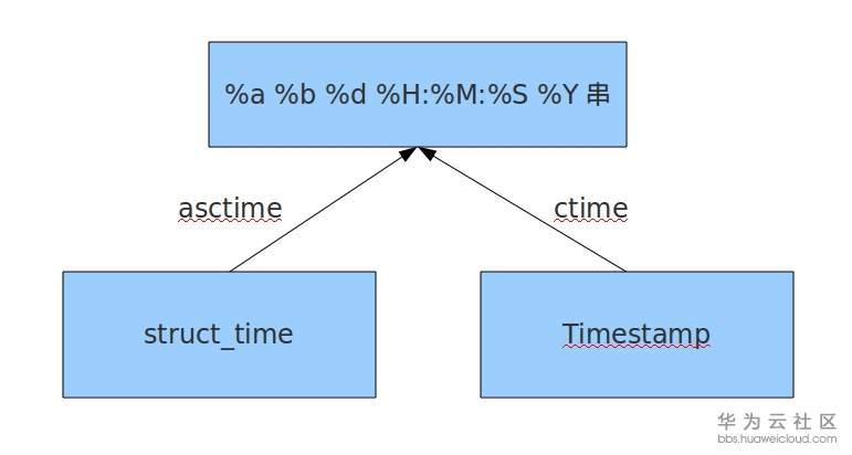

import time
# 结构化时间 --> %a %b %d %H:%M:%S %Y串
# time.asctime(结构化时间) 如果不传参数,直接返回当前时间的格式化串
print(time.asctime(time.localtime(1600000000)))
print(time.asctime())
# 时间戳 --> %a %b %d %H:%M:%S %Y串
# time.ctime(时间戳)  如果不传参数,直接返回当前时间的格式化串
print(time.ctime())
print(time.ctime(1700000000))
