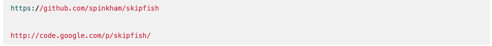

Source

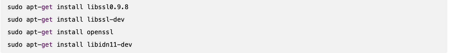

安装所需软件库:

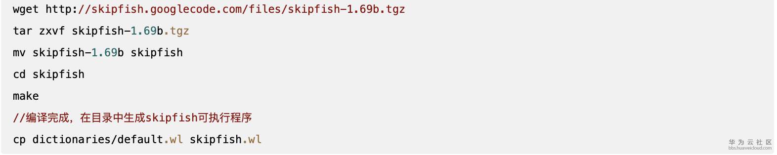

安装skipfish:

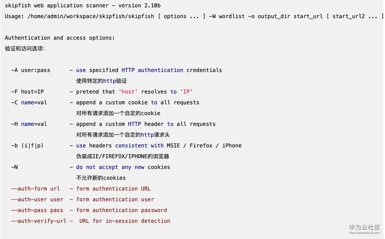

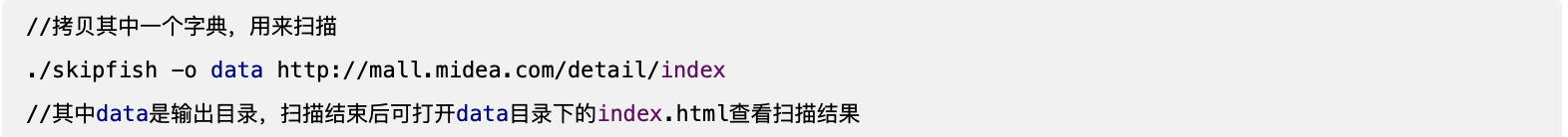

Use

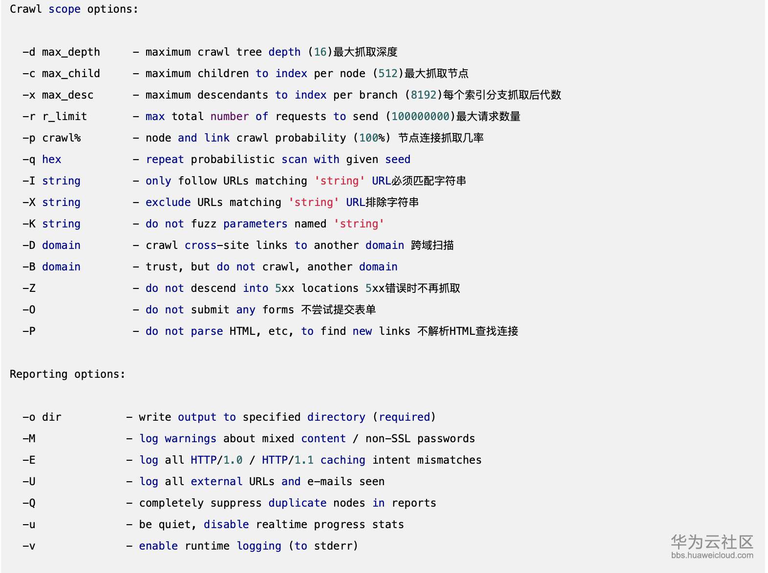

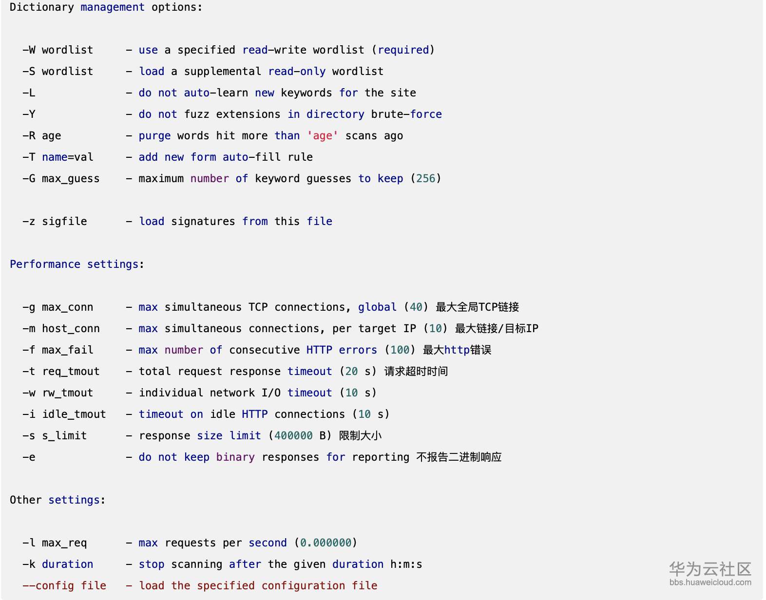

SomeParams

Once you have the dictionary selected, you can use -S to load that dictionary,
and -W to specify an initially empty file for any newly learned site-specific
keywords (which will come handy in future assessments):
$ touch new_dict.wl
$ ./skipfish -o output_dir -S existing_dictionary.wl -W new_dict.wl \
http://www.example.com/some/starting/path.txt
You can use -W- if you don’t want to store auto-learned keywords anywhere.
Note that you can provide more than one starting URL if so desired; all of them will be crawled. You can also read a list of URLs from a file using this syntax:
$ ./skipfish …other options… -o output_dir @/path/to/url_list.txt
