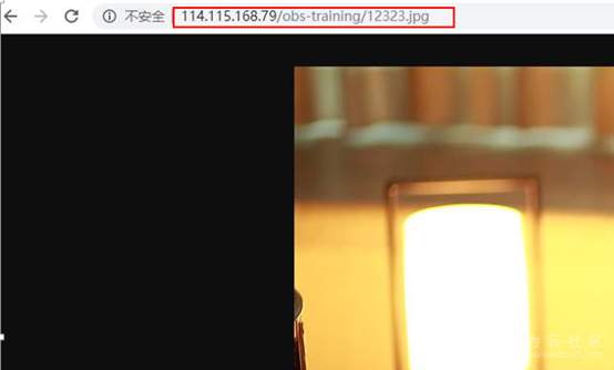

通过web展示,在浏览器地址栏输入http://114.115.168.79/obs-training/12323.jpg
