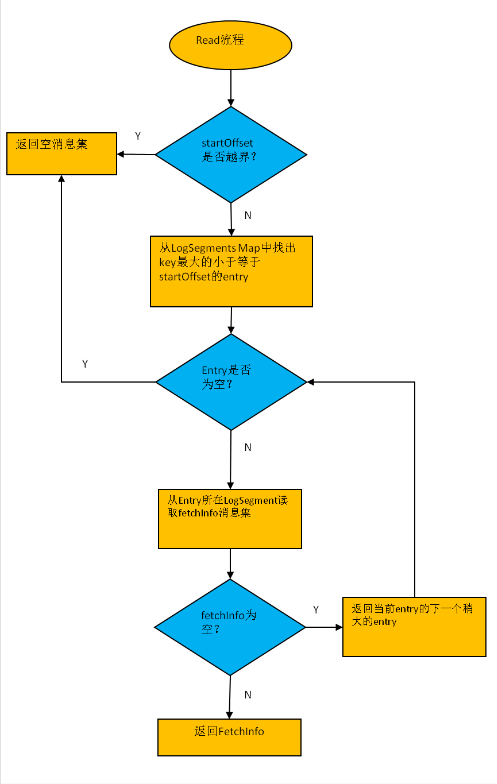

5.    Log.read日志流程
流程图如下:
这个函数通过指定开始读的startOffset和最大读长度等参数,返回FetchDataInfo信息。原理很简单,就是从保存的segments map中找到baseOffset与startOffset最接近的segment,开始查找和读取数据。

    while(entry != null) {
      //调用LogSegment.read获得fetchInfo
      val fetchInfo = entry.getValue.read(startOffset, maxOffset, maxLength)
      //如果为空,则找其连续的下一个Logsegment去读取
      if(fetchInfo == null) {
        entry = segments.higherEntry(entry.getKey)
      } else {
        return fetchInfo
    // okay we are beyond the end of the last segment with no data fetched although the start offset is in range,
    // this can happen when all messages with offset larger than start offsets have been deleted.
    // In this case, we will return the empty set with log end offset metadata
    FetchDataInfo(nextOffsetMetadata, MessageSet.Empty)
