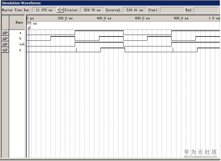

实验2.1
LIBRARY ieee;
USE ieee.std_logic_1164.all;
ENTITY mux1 IS
  PORT(a,b:IN STD_LOGIC;
       sel:IN STD_LOGIC;
       y:OUT STD_LOGIC);
END mux1;
ARCHITECTURE mux1 OF mux1 IS
BEGIN
  y<=a WHEN sel='0' ELSE
     b;
END mux1;

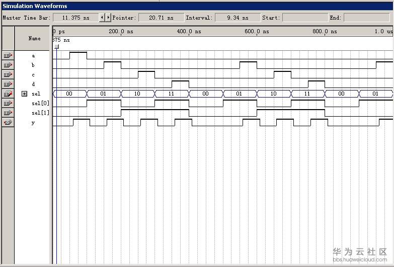

实验2.2
LIBRARY ieee;
ENTITY mux2 IS
  PORT(a,b,c,d:IN STD_LOGIC;
       sel:IN STD_LOGIC_VECTOR(1DOWNTO 0);
       y:OUT STD_LOGIC);
END mux2;
ARCHITECTURE mux2 OF mux2 IS
BEGIN
  WITH sel SELECT
  y<=a WHEN "00" ,
     b WHEN "01" ,
     c WHEN "10" ,
     d WHEN OTHERS ;
END mux2;

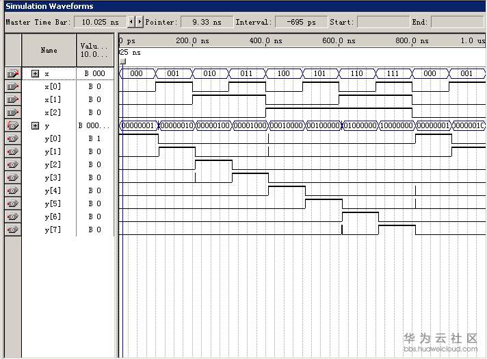

实验2.3
LIBRARY ieee;
ENTITY decoder is
  PORT (x:IN STD_LOGIC_VECTOR(2 DOWNTO );
      y:OUT STD_LOGIC_VECTOR(7 DOWNTO ));
END decoder;
architecture decoder of decoder is
begin
  WITH x SELECT
   y<="00000001" WHEN "000",
      "00000010" WHEN "001",
      "00000100" WHEN "010",
      "00001000" WHEN "011",
      "00010000" WHEN "100",
      "00100000" WHEN "101",
      "01000000" WHEN "110",
      "10000000" WHEN OTHERS;
END decoder;

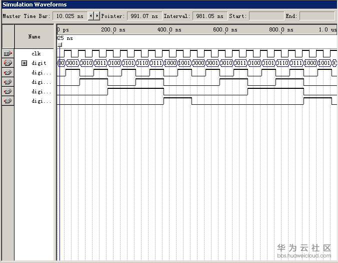

实验2.4
LIBRARY ieee;
ENTITY counter0 is
  PORT (clk:IN STD_LOGIC;
      digit:OUT INTEGER RANGE 0 TO 10);
END counter0;
architecture counter0 of counter0 is
begin
  PROCESS(clk)
  VARIABLE temp: INTEGER RANGE 0 TO 10;
  BEGIN
    IF(clk'EVENT AND clk='1') THEN
      temp:=temp+1;
      IF(temp>=10) THEN
       temp:=0;
      END IF;
    END IF;
    digit<=temp;
   END PROCESS ;
END counter0;

1.运行结果
分析:由图可知,sel=0时,y=a;sel=1时,y=b,实现了二选一数据选择器功能,说明代码正确。
2.运行结果
分析
由图可知,当sel=00,01,10,11时,输出y分别等于a,b,c,d。说明实现了四选一数据选择器的功能,说明代码正确。
3.运行结果
分析
由图可知,当输入x分别是000,001,010,011,100,101,110,111时,对应输出为y(0),y(1),y(2),y(3),y(4),y(5),y(6),y(7)依次为低电平,说明实现了3-8译码器的功能。说明代码正确。
4.运行结果
分析
由图可知,但第1个clk上升沿到来时,digit计数1,第2个clk上升沿到来,digit计数2,直到第9个clk上升沿到来,digit计数9,第10个clk上升沿到来,digit清0。说明实现了模十计数功能,说明代码正确。
