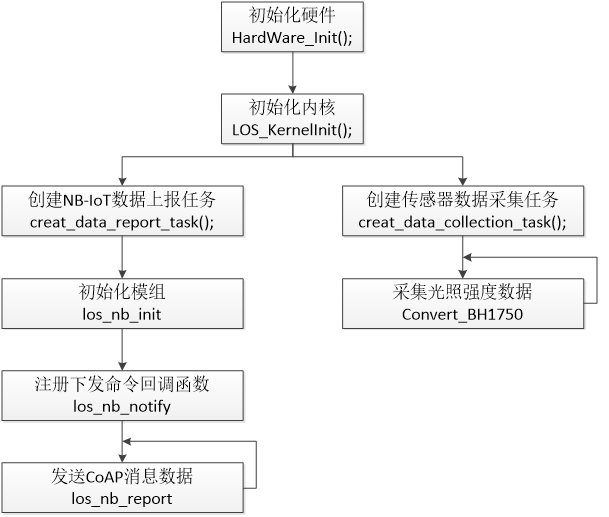

Step 1 分析主程序
   int main(void)
     UINT32 uwRet = LOS_OK;
     HardWare_Init();
     uwRet = LOS_KernelInit();
     if (uwRet != LOS_OK)
       return LOS_NOK;
     uwRet = creat_data_collection_task();
       return LOS_NOK;
     uwRet = creat_data_report_task();
        return LOS_NOK;
     LOS_Start();
  • 主程序主要包括初始化硬件外设、初始化内核、创建传感器数据采集任务、创建数据上报任务,接下来讲详细讲解主要部分的实现方式。

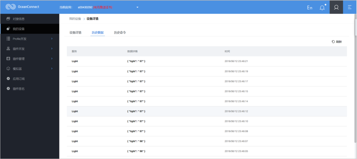

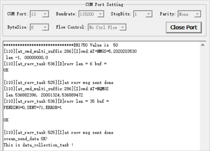

  • 3)上报数据
    while(1)
      if(los_nb_report((const char*)(&BH1750_send),sizeof(BH1750_send))>=0)
       printf("ocean_send_data OK!\n");
      else
       printf("ocean_send_data Fail!\n");
      uwRet=LOS_TaskDelay(1000);
      if(uwRet !=LOS_OK)
      return;
上报数据调用的API为los_nb_report填入的参数为数据与数据长度,这个函数里封装了发送coap消息的AT指令以及查询发送的消息量<的AT指令
int32_t nb_send_payload(const char* buf, int len)
        char *cmd1 = "AT+NMGS=";
        char *cmd2 = "AT+NQMGS\r";
        int ret;
        char* str = NULL;
        int curcnt = 0;
        int rbuflen;
        static int sndcnt = 0;
        if(buf == NULL || len > AT_MAX_PAYLOADLEN)
          AT_LOG("payload too long");
          return -1;
        memset(tmpbuf, 0, AT_DATA_LEN);
        memset(wbuf, 0, AT_DATA_LEN);
        str_to_hex(buf, len, tmpbuf);
        memset(rbuf, 0, AT_DATA_LEN);
        snprintf(wbuf, AT_DATA_LEN,"%s%d,%s%c",cmd1,(int)len,tmpbuf,'\r');
        ret = at.cmd((int8_t*)wbuf, strlen(wbuf), "OK", NULL,NULL);
        if(ret < 0)
          return -1;
        ret = at.cmd((int8_t*)cmd2, strlen(cmd2), "SENT=", rbuf,&rbuflen);
        if(ret < 0)
          return -1;
        str = strstr(rbuf,"SENT=");
        if(str == NULL)
          return -1;
        sscanf(str,"SENT=%d,%s",&curcnt,wbuf);
        if(curcnt == sndcnt)
          return -1;
        sndcnt = curcnt;
        return ret;
