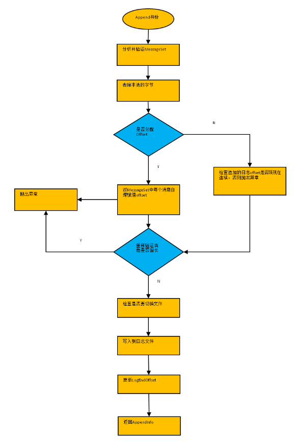

4.    Log.append 日志流程
流程图如下:
这个函数把消息集合写入到真正的日志文件中,并返还LogAppendInfo:
def append(messages: ByteBufferMessageSet, assignOffsets: Boolean = true): LogAppendInfo = {
    val appendInfo = analyzeAndValidateMessageSet(messages)
    // if we have any valid messages, append them to the log
    if(appendInfo.shallowCount == 0)
      return appendInfo
    //去掉一些不合法的字节,这些不合法的字节是通过检查CRC值来的
    // trim any invalid bytes or partial messages before appending it to the on-dis log
    var validMessages = trimInvalidBytes(messages, appendInfo)
    try {
      // they are valid, insert them in the log
      lock synchronized {
        // nextOffsetMetadata是一个LogOffsetMetadata,通过updateLogEndOffset函数每次更新messageOffset字段,就能得到当前日志的lastOffset。下一次写从这个offset查找就能知道下一次写入的offset是什么
        appendInfo.firstOffset = nextOffsetMetadata.messageOffset
        if(assignOffsets) {
          // assign offsets to the message set
          val offset = new AtomicLong(nextOffsetMetadata.messageOffset)
          try {
              //对validMessages(ByteBufferMessageSet)消息组里面的每个消息的第一个字段offset进行赋值,这样每条写到日志里面的消息头就有offset了
              validMessages = validMessages.assignOffsets(offset, appendInfo.codec)
          } catch {
            case e: IOException => throw new KafkaException("Error in validating messages while appending to log '%s'".format(name), e)
          // offset在validMessages.assignOffsets中每遇到一个消息会自增,所以lastoffset 就是offset值减一
          appendInfo.lastOffset = offset.get - 1
        } else {
          // we are taking the offsets we are given
          if(!appendInfo.offsetsMonotonic || appendInfo.firstOffset < nextOffsetMetadata.messageOffset)
            throw new IllegalArgumentException("Out of order offsets found in " + messages)
        //在assignOffsets里会重新压缩,需要检查消息长度是否过长
        // re-validate message sizes since after re-compression some may exceed the limit
        for(messageAndOffset <- validMessages.shallowIterator) {
          if(MessageSet.entrySize(messageAndOffset.message) > config.maxMessageSize) {
            // we record the original message set size instead of trimmed size
            // to be consistent with pre-compression bytesRejectedRate recording
            BrokerTopicStats.getBrokerTopicStats(topicAndPartition.topic).bytesRejectedRate.mark(messages.sizeInBytes)
            BrokerTopicStats.getBrokerAllTopicsStats.bytesRejectedRate.mark(messages.sizeInBytes)
            throw new MessageSizeTooLargeException("Message size is %d bytes which exceeds the maximum configured message size of %d."
              .format(MessageSet.entrySize(messageAndOffset.message), config.maxMessageSize))
        // check messages set size may be exceed config.segmentSize
        if(validMessages.sizeInBytes > config.segmentSize) {
          throw new MessageSetSizeTooLargeException("Message set size is %d bytes which exceeds the maximum configured segment size of %d."
            .format(validMessages.sizeInBytes, config.segmentSize))
        //如果当前的消息添加后超过active segments的文件长度,则创建一个新的日志文件再添加。
        // maybe roll the log if this segment is full
        val segment = maybeRoll(validMessages.sizeInBytes)
        //把消息追加到active segment中,如果字节数足够,就调用OffsetIndex.append添加索引
        // now append to the log
        segment.append(appendInfo.firstOffset, validMessages)
       //更新nextOffsetMetadata变量到最新的offset
       // increment the log end offset
        updateLogEndOffset(appendInfo.lastOffset + 1)
        trace("Appended message set to log %s with first offset: %d, next offset: %d, and messages: %s"
                .format(this.name, appendInfo.firstOffset, nextOffsetMetadata.messageOffset, validMessages))
        if(unflushedMessages >= config.flushInterval)
          flush()
        appendInfo
    } catch {
      case e: IOException => throw new KafkaStorageException("I/O exception in append to log '%s'".format(name), e)
