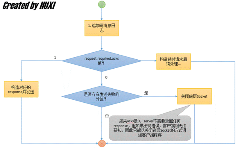

如此看来,核心的方法就是handleProducerOrOffsetCommitRequest了。这个方法之所以叫这个名字,是因为它同时可以处理ProducerRequest和OffsetCommitRequest两种请求,后者其实也是一种特殊的ProducerRequest。从Kafka 0.8.2之后kafka使用一个特殊的topic来保存提交位移(commit offset)。这个topic名字是__consumer_offsets。本文中我们关注的是真正的ProducerRequest。下面来看看这个方法的逻辑,如下图所示:
整体逻辑看上去非常简单,如下面的代码所示:
def handleProducerOrOffsetCommitRequest(request: RequestChannel.Request) {
    val localProduceResults = appendToLocalLog(produceRequest, offsetCommitRequestOpt.nonEmpty) // 将消息追加写入本地提交日志
    val numPartitionsInError = localProduceResults.count(_.error.isDefined) // 计算是否存在发送失败的分区
    if(produceRequest.requiredAcks == 0) { // request.required.acks = 0时的代码路径
      if (numPartitionsInError != 0) {
        info(("Send the close connection response due to error handling produce request " +
          "[clientId = %s, correlationId = %s, topicAndPartition = %s] with Ack=0")
          .format(produceRequest.clientId, produceRequest.correlationId, produceRequest.topicPartitionMessageSizeMap.keySet.mkString(",")))
        requestChannel.closeConnection(request.processor, request) // 关闭底层Socket以告知客户端程序有发送失败的情况
      } else {
    } else if (produceRequest.requiredAcks == 1 || // request.required.acks = 0时的代码路径,当然还有其他两个条件
        produceRequest.numPartitions <= 0 ||
        numPartitionsInError == produceRequest.numPartitions) {
      val response = offsetCommitRequestOpt.map(_.responseFor(firstErrorCode, config.offsetMetadataMaxSize))
                                           .getOrElse(ProducerResponse(produceRequest.correlationId, statuses))
      requestChannel.sendResponse(new RequestChannel.Response(request, new BoundedByteBufferSend(response))) // 发送response给客户端
    } else { //  request.required.acks = -1时的代码路径
      // create a list of (topic, partition) pairs to use as keys for this delayed request
      val producerRequestKeys = produceRequest.data.keys.toSeq
      val statuses = localProduceResults.map(r =>
        r.key -> DelayedProduceResponseStatus(r.end + 1, ProducerResponseStatus(r.errorCode, r.start))).toMap
      val delayedRequest =  new DelayedProduce(...) // 此时需要构造延时请求进行处理,此段逻辑比较复杂,需要理解Purgatory的概念,本文暂不考虑,后续再分析
由上面代码可见,无论request.required.acks是何值,都需要首先将待发送的消息集合追加写入本地的提交日志中。此时如何按照默认值是是0的情况,那么这写入日志后需要判断下所有消息是否都已经发送成功了。如果出现了发送错误,那么就将关闭连入broker的Socket Server以通知客户端程序错误的发生。
