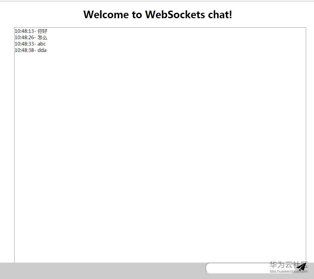

Type message in one client
We have two browsers opened. Simulate two different clients. So, when in the left side browser user types message and press send button, this message should be send to both browsers, as each of them subscribed to the “/chat” channel.
After clicking send button in the left side browser → message appeared in both browsers
And when right side browser send message in answer, the “Hi there, Client 1!” message appears in both browsers as well!
Messages from both clients appeared in two browsers
